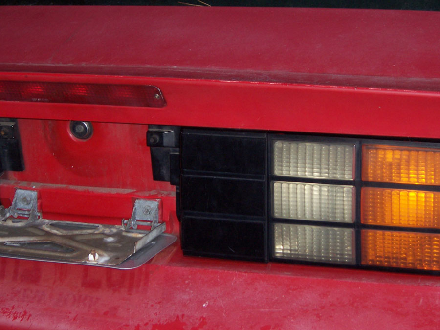

Here is my kill switch panel. I made this so that no one will be able to see kill switch when driving on the street. I just remove the cover and then I meet the NHRA rules for drag racing.
Spin

Here it is with the panel off.
Spin

It was actually pretty easy to install there. All you need is a 3" hole saw and you can still use factory supports to hold the rear of the taillight to the car. I really did not want the switch to be accessible by people walking by in parking lots or while i am sitting with the car running.
Spin

is the switch setting on a homemade plate/bracket?
Old Sep 22, 2005 | 05:54 PM
Spindr130's Avatar
Joined: Jun 2001
Posts: 287
From: lindenhurst, new york
Likeenz24
The switch plate is made out of 22-gage steel I bought from home depot. I used a pair of tin snips and a vice to make it. Then I painted it with por 15.
Spin
