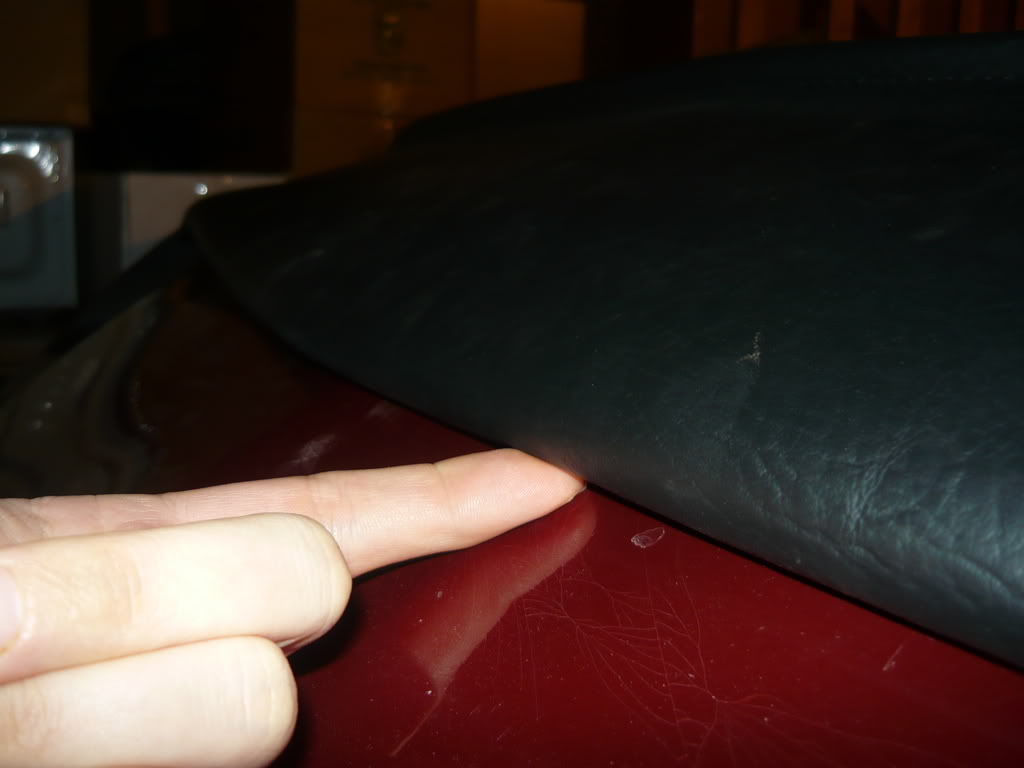

Talk about deja vu! My car had the exact same problems!!! Hood extending over the front bumper cover AND a gap on the top of the fender. I spent some time with 1piece@atime this last weekend (he's a bodyman by trade and an expert on third gens imo). He fixed both of my problems....Listen to his advise posted above--he is spot on.
Look familar? This is what my car looked like before 1piece worked on it.

What's that second pic supposed to be showing us?
The overhand of the hood. It was so bad that I could put my finger in there!

When Irocket and I worked on his car we didn't loosen the fender up or remove anything at first. We did run the car up on some blocks to make it a little easier to work underneath. His pinchweld flange and fender were bent toward the outside of the car so it was just a matter of using a hammer and a block of wood to make it straight up and down again. After I did that then I loosened the bottom fender bolt and adjusted the fender a little but didn't remove the ground effects. I was trying to do the whole job without doing any damage to the paint so I had to live with the gap being somewhat less than perfect.

I just got done with the fender gap and I'll let you guys be the judges. I loosened the fender/rocker bolt and pryed the fender out near the bottom and tightened it back up. I think the gap is better near the top of the fender now and I got some gap back at the hood/fender. I also measured the aftermarket right side fender and found it's 3/16 shorter than the left side factory....go figure. The hood sticks out 5/16 past the corner edge of the bumper cover so do the math and thats 2/16 I could shave if I had a better fitting fender.
Attached Thumbnails Expensive Front Bumper Problem-camarobody2-001.jpg   Expensive Front Bumper Problem-camarobody2-002.jpg   Expensive Front Bumper Problem-camarobody2-003.jpg
Old Apr 4, 2009 | 08:01 PM
IROC#1's Avatar
Joined: Apr 2009
Posts: 415
From: Renton, WA
Car: 1988 IROC Z
Engine: 5.7 litre
Axle/Gears: 3.27 Posi with 4 wheel disc brakes
Re: Expensive Front Bumper Problem
That looks way better! Nice job!
Old Apr 4, 2009 | 08:55 PM
1piece@atime's Avatar
Joined: Oct 2008
Posts: 644
From: Western Washington
Car: 86 T/A
Engine: 5.0 TPI
Much better!
It's a shame the sfc's are preventing you from straightening out the pinchweld on the bottom. Getting that fender down just a little bit more would help close the gap at the top to the door. But hey ... looks good!
