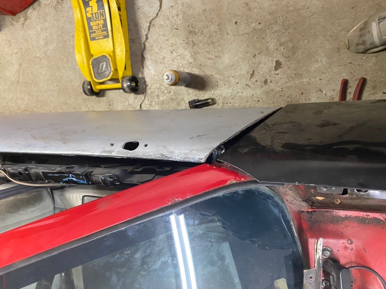

I installed 1990 camaro doors on my 1989 Pontiac Firebird it fits but when I put the fender on it has an inch difference does anyone know how to fix this
thanks

Zman those are terrible pics but I’m betting if you look at the bottom of the fender where it bolts to the body tab that it’s pushed up into the body from jacking. Again, terrible pics but it kinda looks like your fender is bent.
