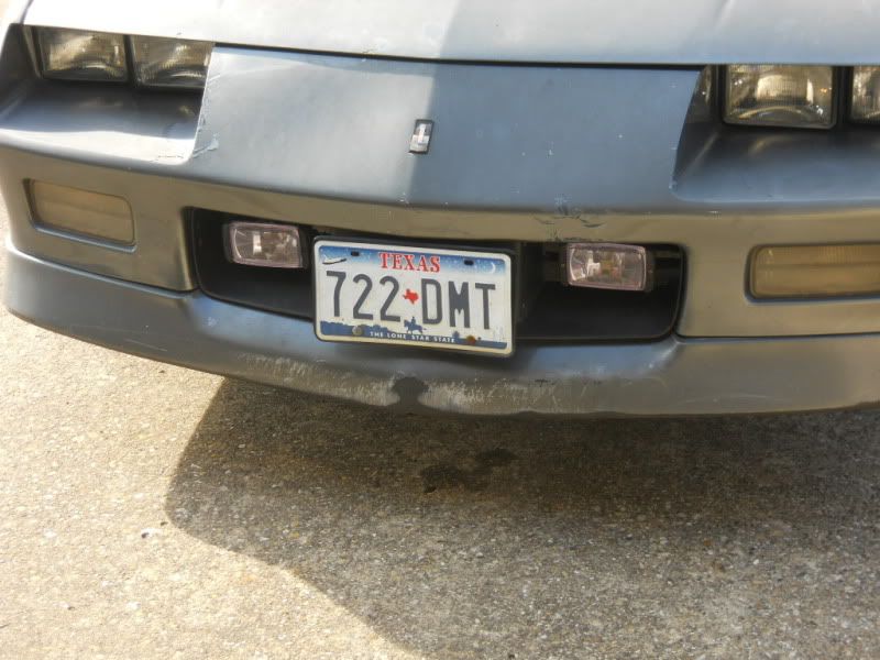

Here it is installed....
It's not a direct fit, there are seveal screw holes that hold it to the brace behind the grill that are not on the brace on the RS.
There were enough that were there that it worked ok, but I had to use the licence plate holder to hold it in place. Not including the licence bracket, there's only two screws holding it one
If I want to later, I could make it work better, but I think it's ok now
yeah, I know, I got some work to do on the bumper
When I replaced the louvered grille with a fog light grille on my old 88 sport coupe I had to drill out holes on the outside edges of the center section of the nose.I believe there are 2 on each side.

It is just the fog light circuit that reads 24v. Every other circuit is 12v. I was just making sure that I was correct in thinking that circuit wasn't suppose to have 24v. I can only assume that something is wrong with the switch or something else. I do have a couple problems with the wiring on the car. (As expected considering it has sat in a she most of it's life where squirrels and rats could mutilate the harness!)
Old Sep 17, 2016 | 09:31 AM
bryan623's Avatar
Joined: Dec 2008
Posts: 267
From: Morgantown PA
Car: 89 GTA
Engine: 5.7 TPI
Re: Third gen factory Z28 fog lights
I think the fog lights look cool like that. And don't worry about the bumper. Lol even I replaced the fog lights on my Trans Am and the bumper needs a lot of work.
