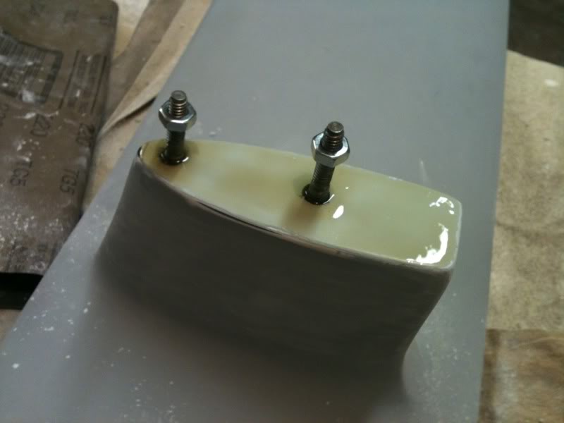

These spoilers are hollow fiberglass, and so when the ends were cut open I had to fill the void with expanding foam, and then fiberglass over it. I'm kind of skipping over most of the labor and will finish this post where I left off today.
The bondo step is about done, just needs a few scratches filled from the sand paper and the screw driver that the person I got it from apparently used on the top side of it.
Tomorrow I'm hoping to get it in primer and start filling holes on the trunk.
