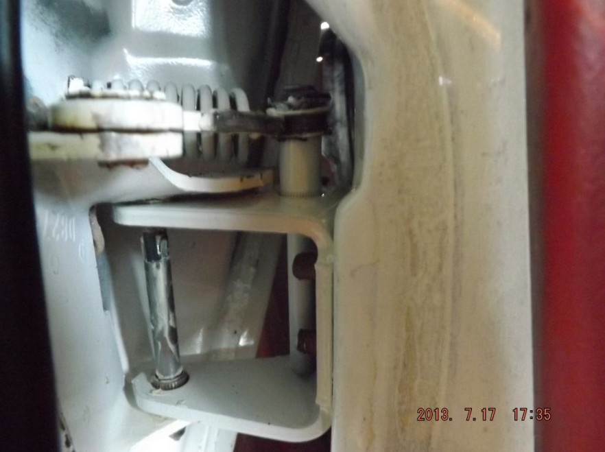

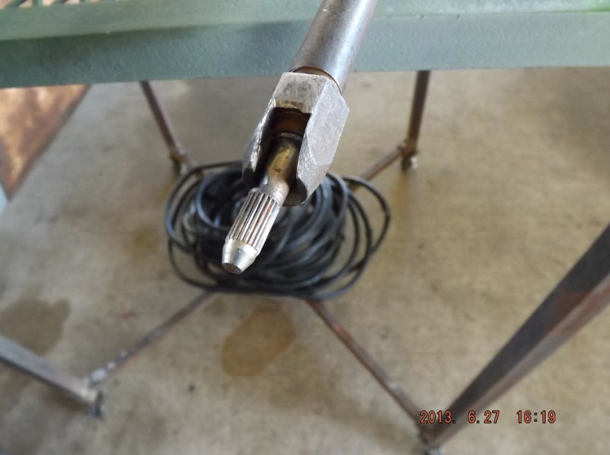

Hello everyone, I just did mine and was very easy to remove the detent roller and pin without destroying and cutting up the whole assembly; despite both my hinges have been heavily worn (second worst next to another thirdgen I had). All that is need is a torch and a slide hammer to do the task. The trick is to cut the roller in half vertically on both sides to expose the pin, don't grind the top of the pin off to get the roller off, as that's what makes it very difficult to take off since there is nothing to grab on except the shaft. Afterwards I "modified" an adapter I have for my slide hammer to slip over the pin, so it could grab against and pull. Last, I mounted the hinge on my large vise and started to heat the collar of the pin to expand the steel, which in turn loosened the pin. The pin came out after only two pulls under 5 seconds while leaving the whole assembly intact and not cut up or welded back together . Perhaps there are other ways people tackle this task, but this is my way of doing it while keeping the whole assembly original and functional, it just takes proper strategy prior to taking on the task. Hope this helps everyone .

Yes the whole hinge was removed. I removed the door because it is much easier to do this task the right way. From what I've seen if either the lower or upper pins or worn, it is always going to affect the other; so I went all out on mine. This means new greasable upper pins, lower detent roller, detent spring, lower pin, door latch, striker, door bumpers, lower weather-stripping, upper roof rail weather-stripping, lock covers, and last but not least the door handle. Yup, that's a lot, but I like doing things the right way the first time, and having the door off gives me the chance to clean all that area since it was just filthy. I will post pictures soon to show everyone how that lower detent pin was removed.

I done it "the right way" as well. I replaced everything that did or could wear. You dont have to remove the hinge. It just takes alittle longer to remove the old stuff. You save on time realigning the door though.
Either way works fine. One is harder to align, the other is harder to do the pin work. Make your choice, take your time, and enjoy new hinges!

It has been months since I've posted about the lower detent roller and removing the pressed pin with a slide hammer and torch, but since then I've completed both doors months ago and both close fine. I now have the photos to show how I removed that lower detent roller and rebuilt the lower hinge. The photos are only a few taken from my entire rebuild from removal, disassembly, to sandblasting, to painting and final reassembly. One thing I should mention is that during this process I did not take the time to actually take a picture when I was heating the pin and cutting the roller in half (I was busy doing the work). Here is this link below.
http://s1349.photobucket.com/user/So...?sort=3&page=1
Let me know if there is problems accessing these photos, I'm new to photo bucket. Hope this method helps some people out.

Finally found the time to install the door hinges repair kit.
I endet up cutting a tread on the pin with the die stock and a M8 die, then used an M8 nut with washers to remove the pin, no hammering the pin D is exactly 8mm.
Attached Thumbnails Door Hinge Roller Pin?-removing-roller-pin-1.jpg   Door Hinge Roller Pin?-removing-roller-pin-2.jpg   Door Hinge Roller Pin?-removing-roller-pin-3.jpg
