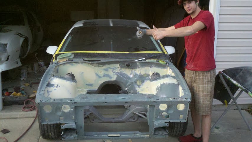

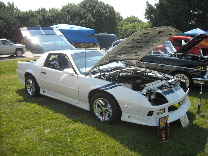

Ok for starters this is a documentary over my interpretation of a "stage 2" 3rd gen full build up. I have a "stage 3" build going simultaneously on my z28, but decided to take time to do this build since its ...simpler..? most of these first pics are from about 3 months ago, so that being said lets get with it.....
Here is what i started with before the disassemble, my 1989 rs camaro that i regularly show.
Attached Thumbnails rev-head stage 2 full build-download-1.jpg   rev-head stage 2 full build-download-2.jpg

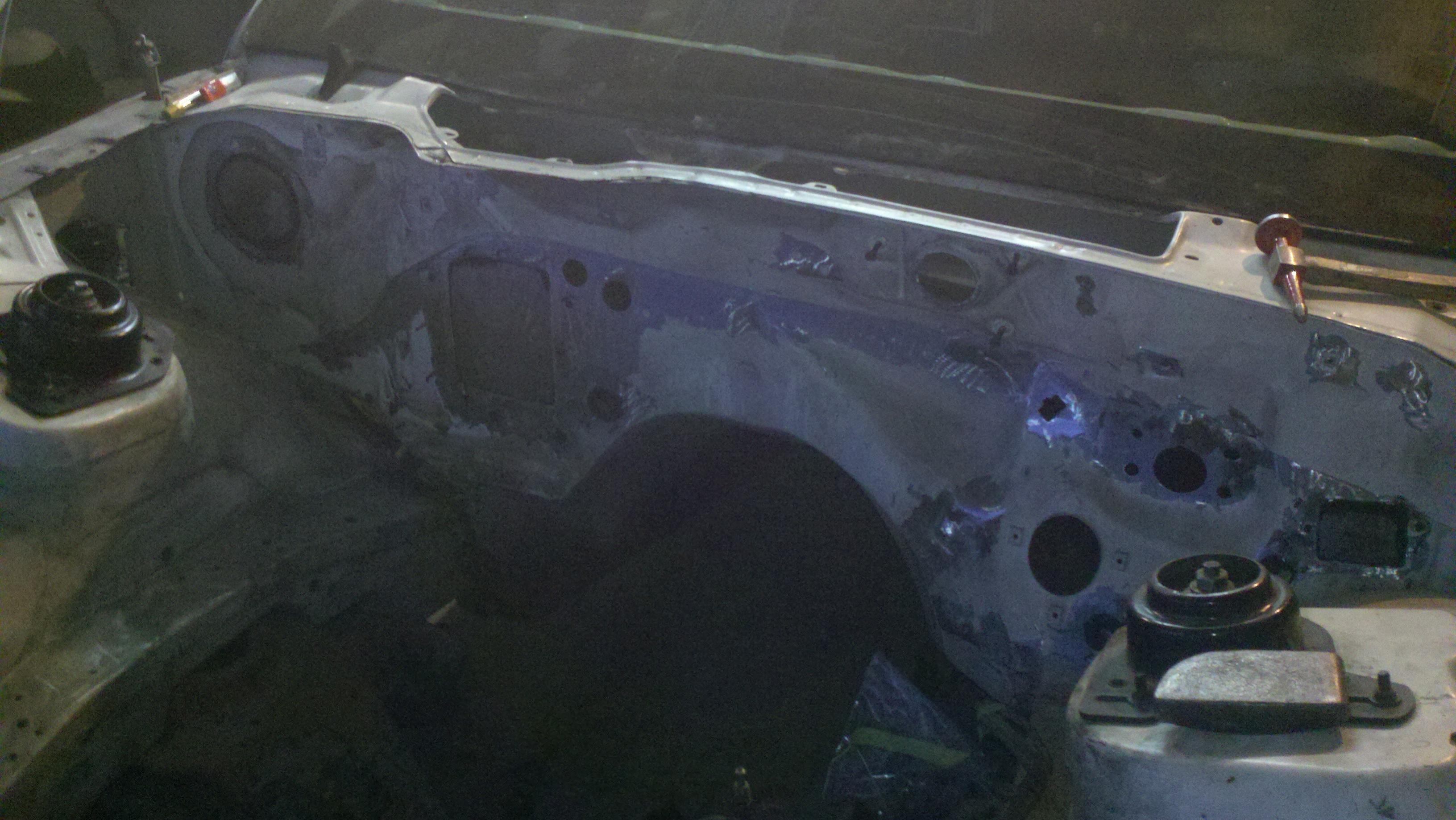

Re: rev-head stage 2 full build

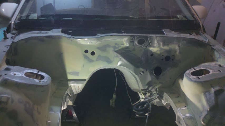

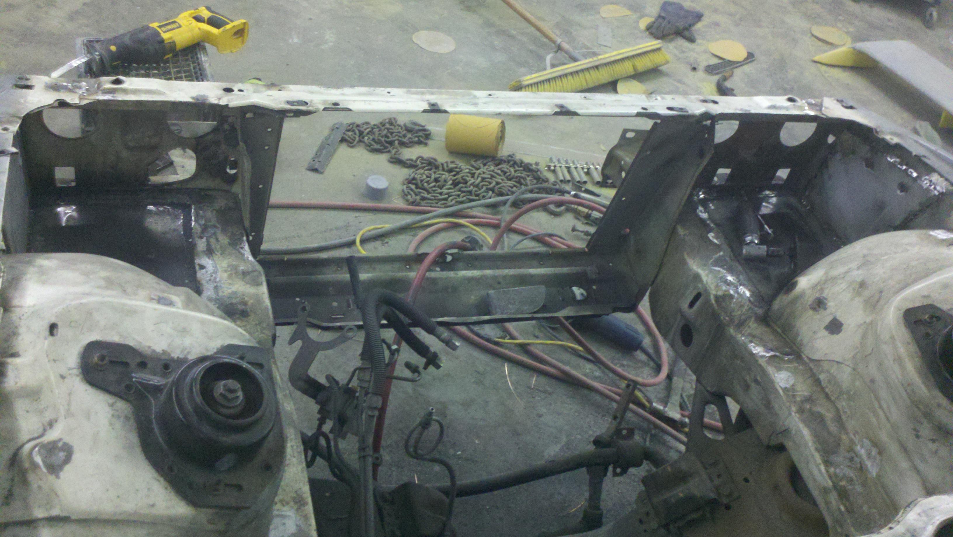

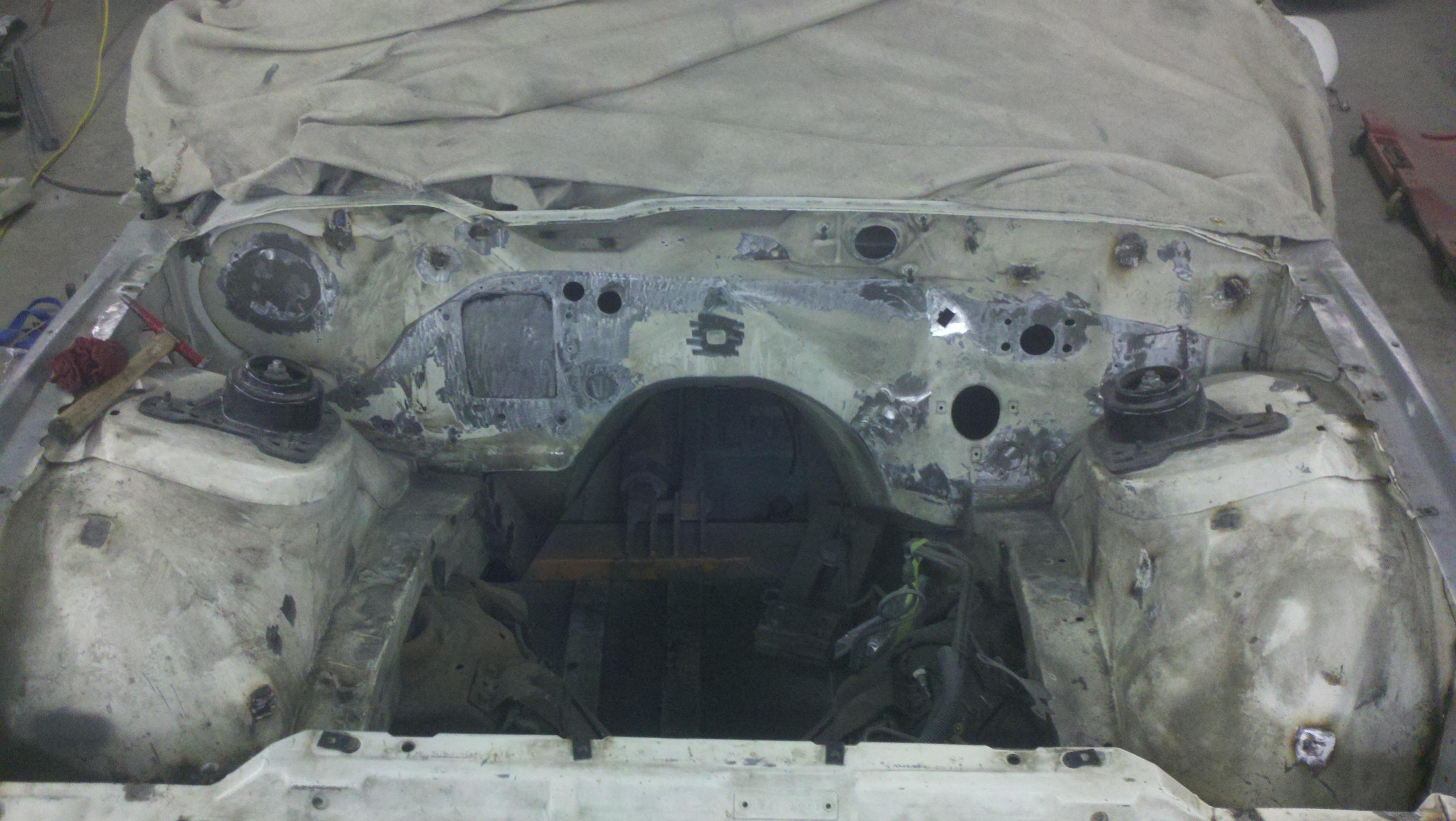

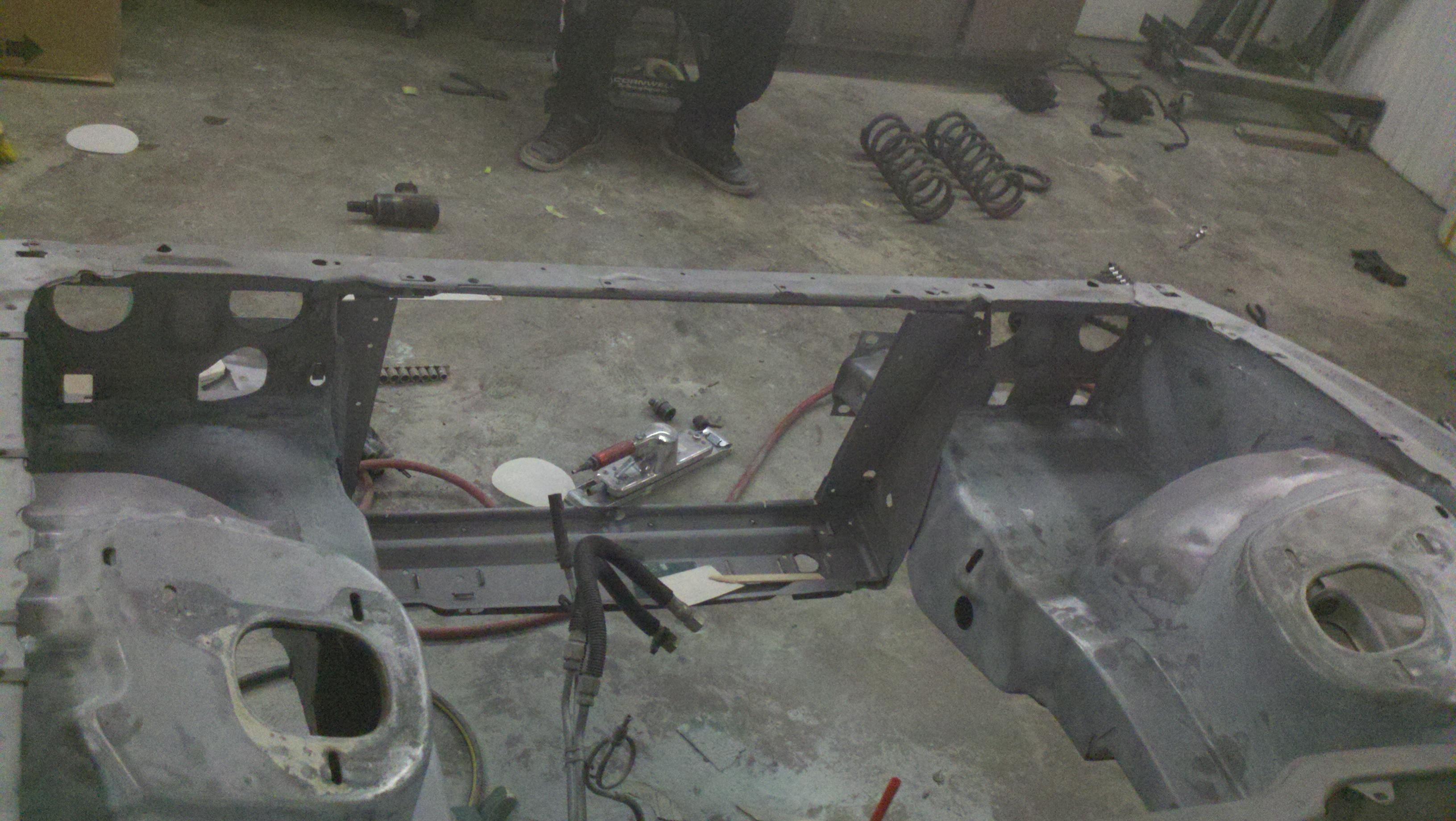

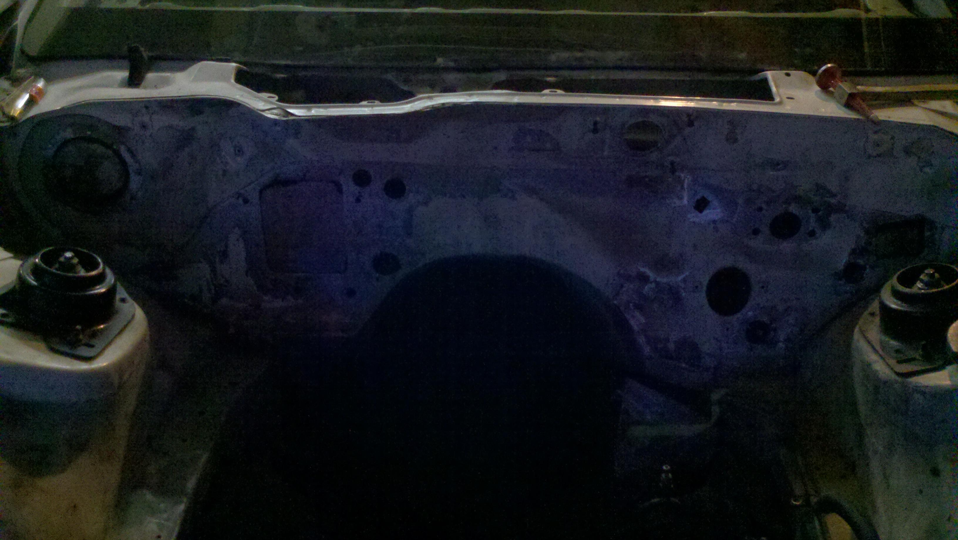

After i gained full access to my firewall from the inside, i began to grind a large area around each hole i decided i would not need anymore for my preferences. I then make an overlapping cardboard template for each hole, and then traced it onto sheet metal.
I used 3m panel bond adhesive to glue the panels in place. Doing it this way rather than welding helps in two ways, one: no heat warping two: corrosion protection is outstanding. Use 1/4" self tapping screws every 3" to clamp the panels down tight over night. After it cures grind the excess glue down, and wha-la...
Attached Thumbnails rev-head stage 2 full build-download-5.jpg   rev-head stage 2 full build-download-6.jpg

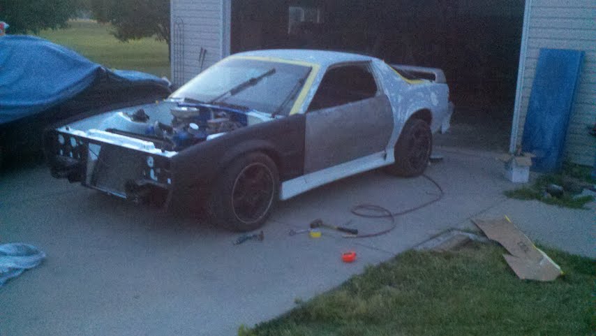

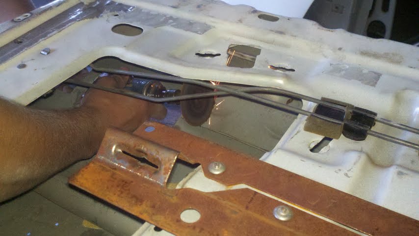

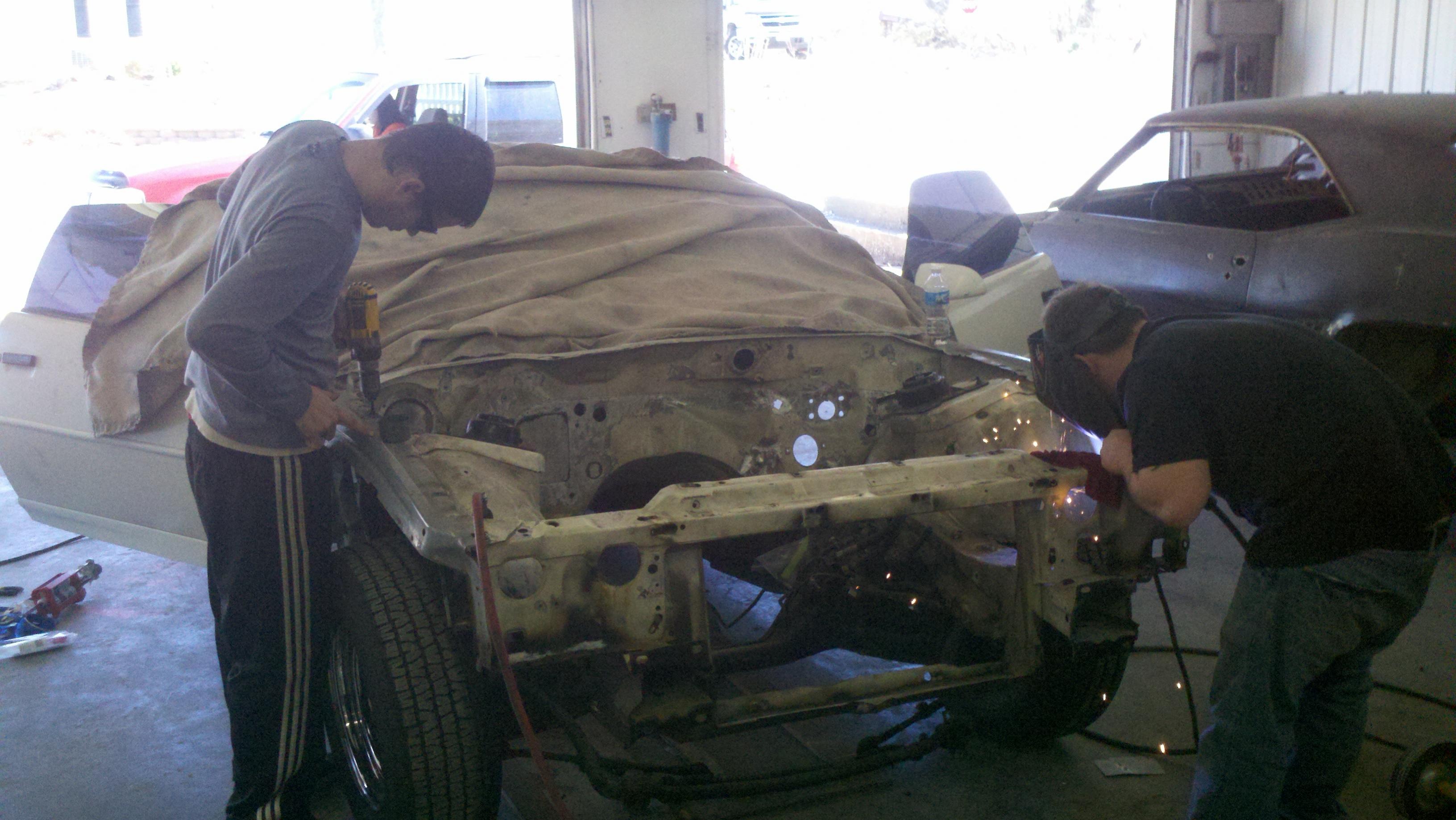

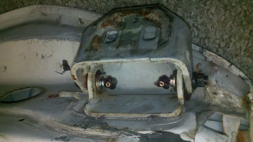

I loaded the car up, and took it to work for the weekend for a little welding. Thank God a few friends stopped by to give me a hand. Had all the holes in the frame rails, and wheel tub filled in.
Also i completely cut out the battery trays and boxed the corners in with 12g cold rolled steel plates, and then preped for sandblasting.
Attached Thumbnails rev-head stage 2 full build-download-7.jpg   rev-head stage 2 full build-download-8.jpg   rev-head stage 2 full build-download-9.jpg

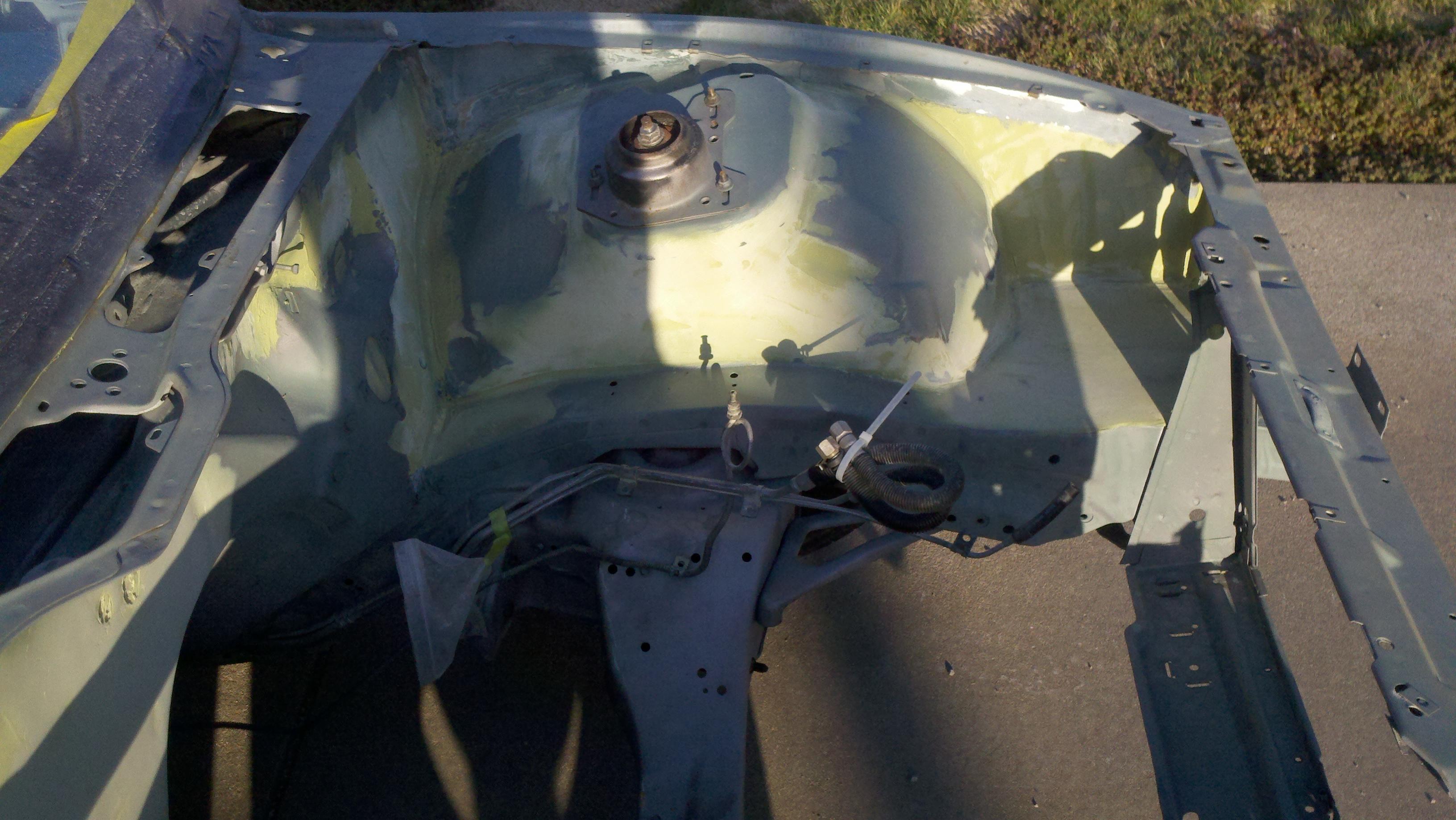

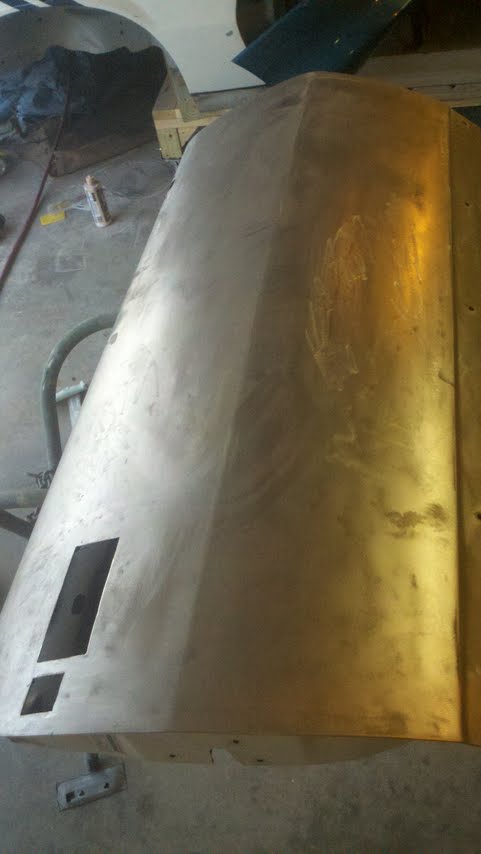

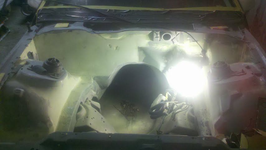

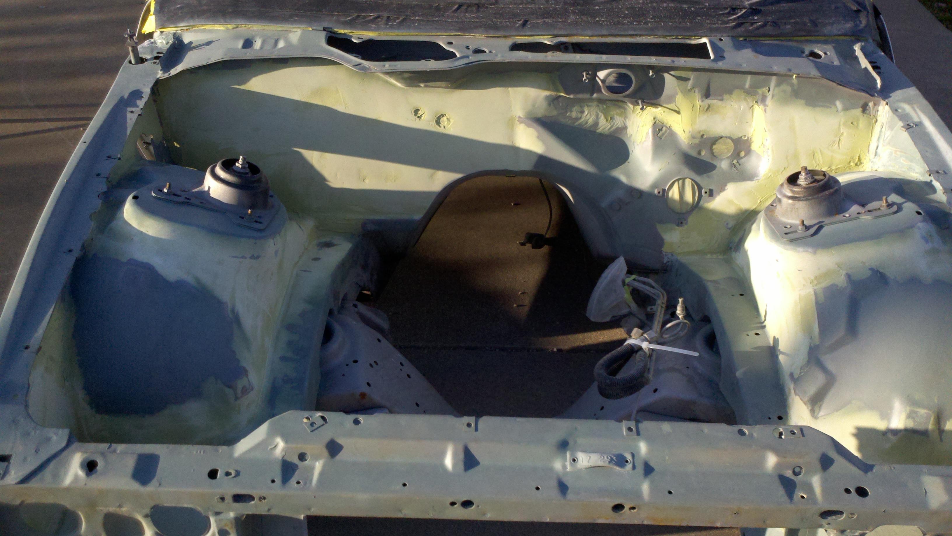

After sandblasting i started laying down fiberglass filler

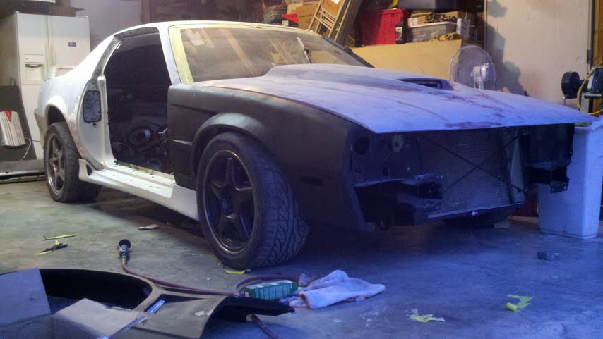

Brought the Camaro back home from work, and began laying more and more plastic down. I think after all said and done i used a gallon of filler on this whole engine bay.
Attached Thumbnails rev-head stage 2 full build-download-12.jpg   rev-head stage 2 full build-download-13.jpg   rev-head stage 2 full build-download-14.jpg

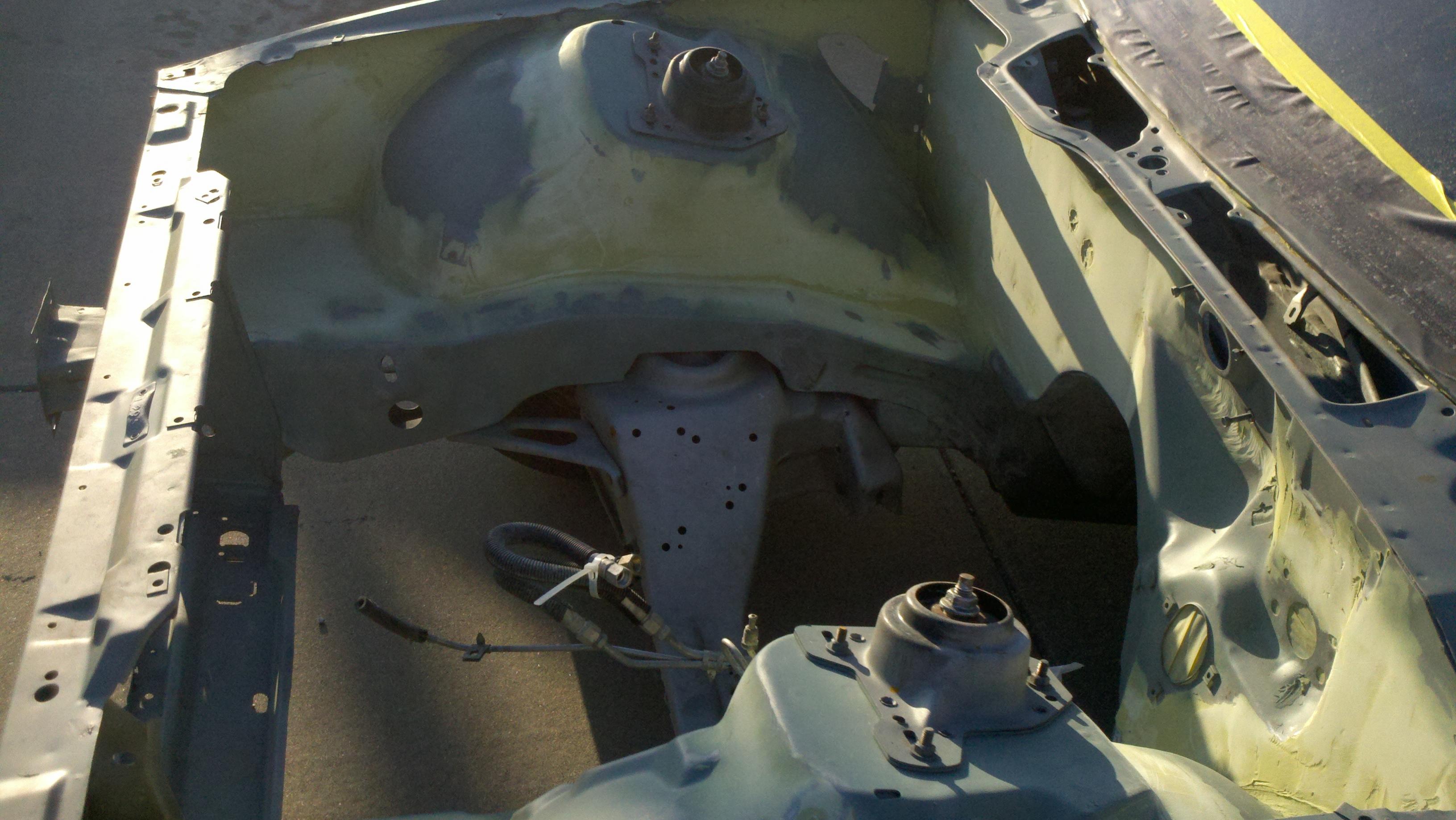

my progress in preparation to primer
Attached Thumbnails rev-head stage 2 full build-download-16.jpg   rev-head stage 2 full build-download-20.jpg   rev-head stage 2 full build-download-21.jpg

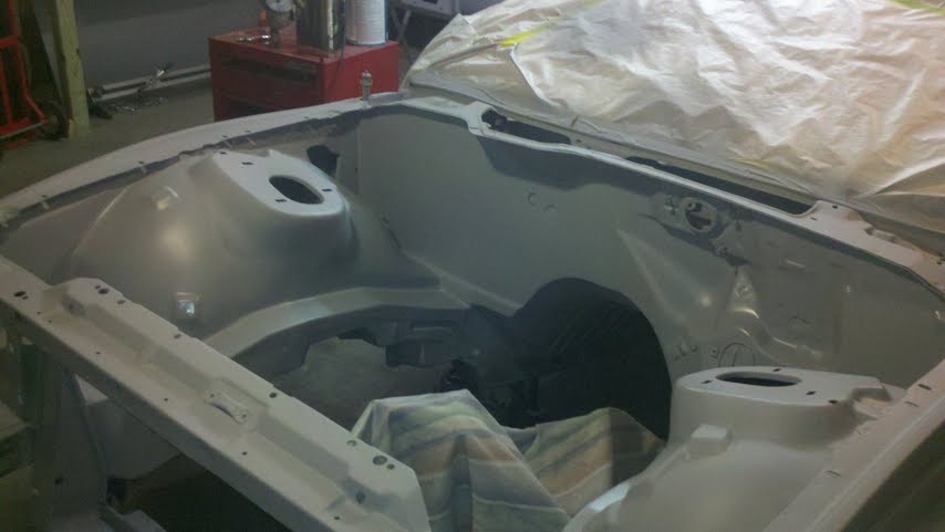

primed, blocked and primed again and ready for paint. I had a pic of the suspension too but lost it.

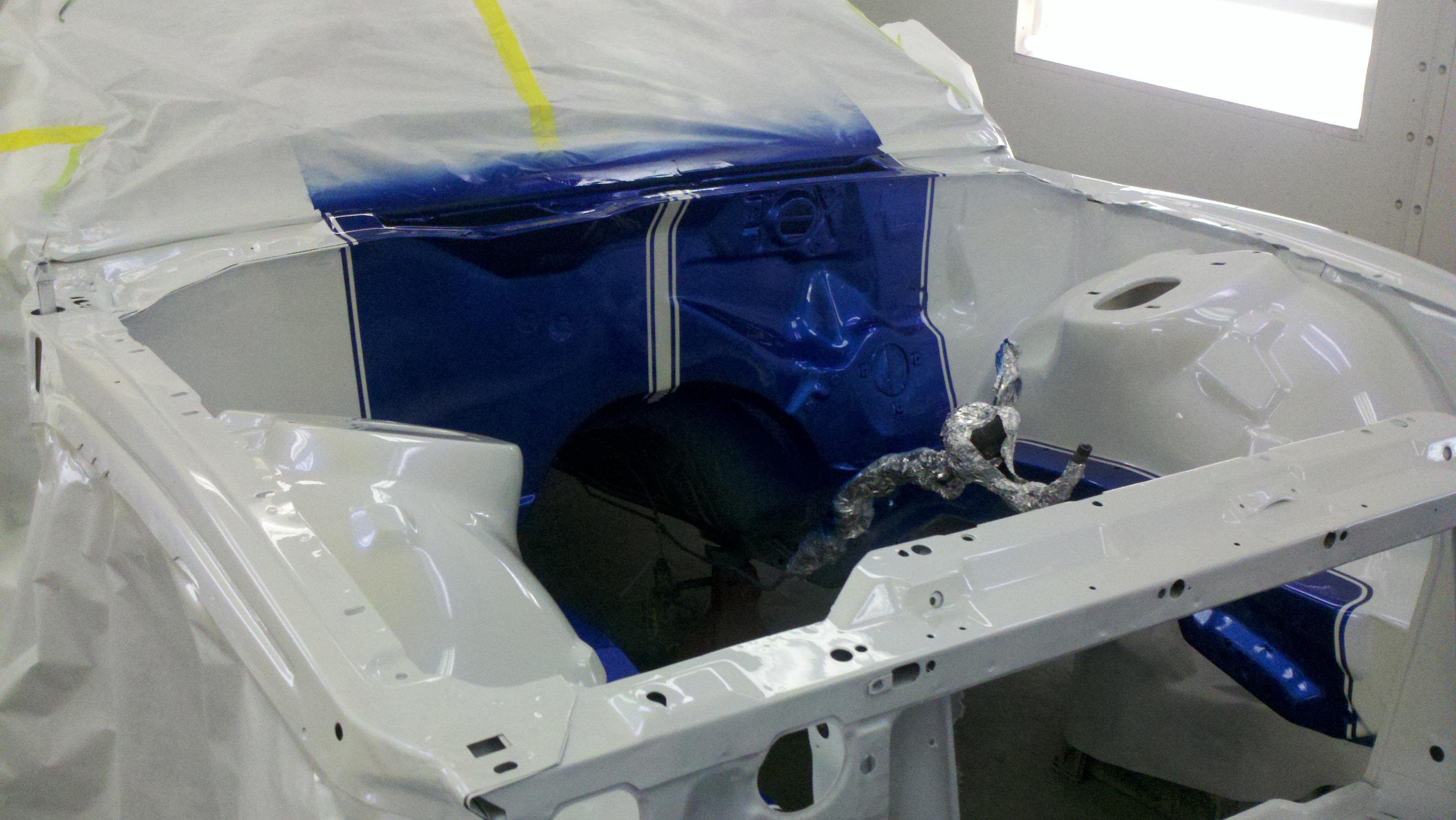

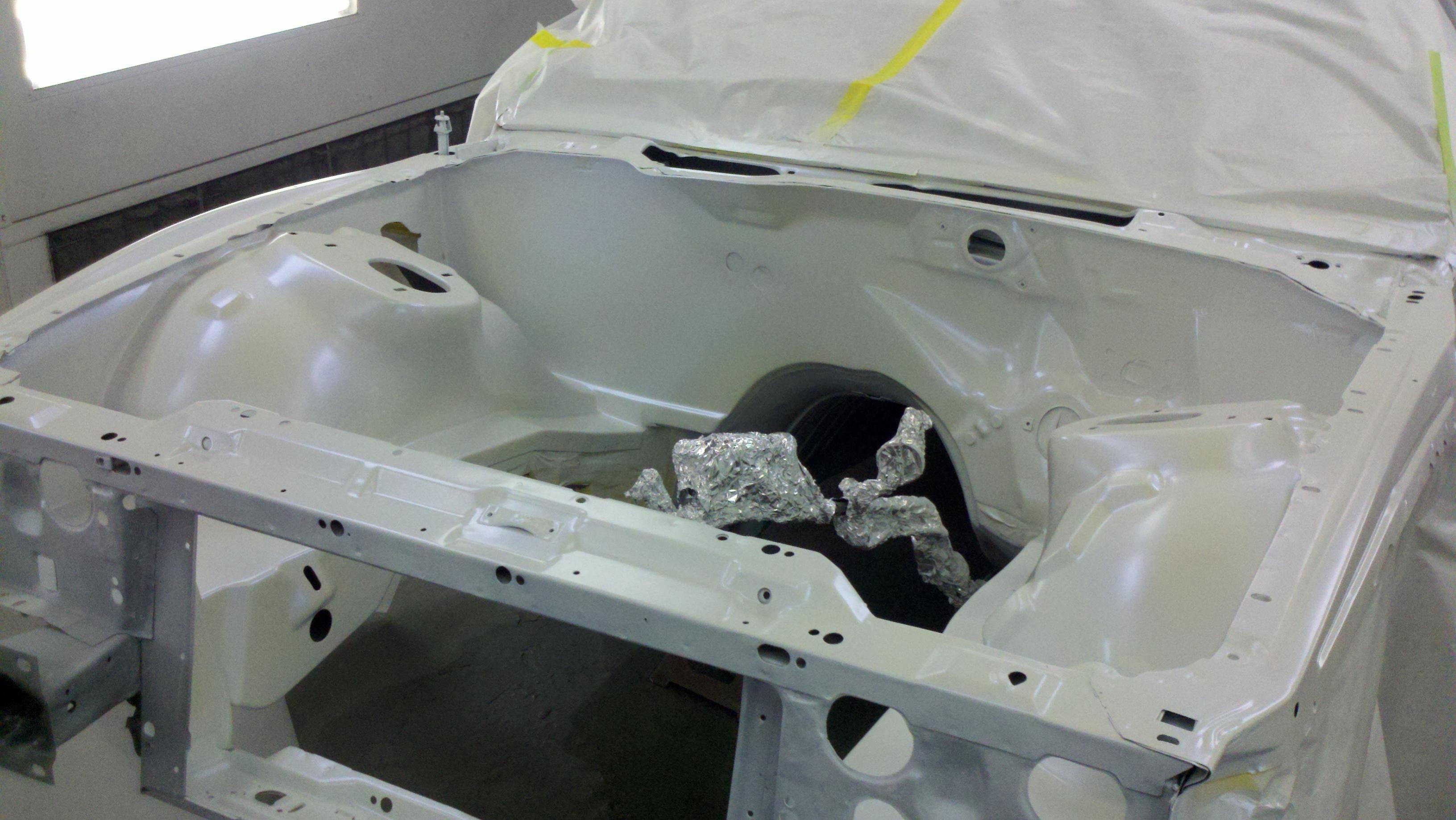

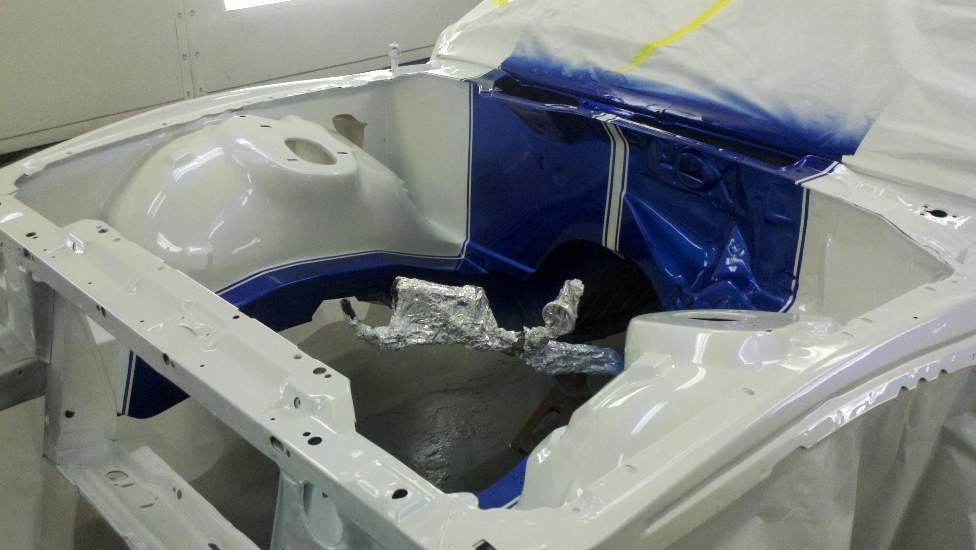

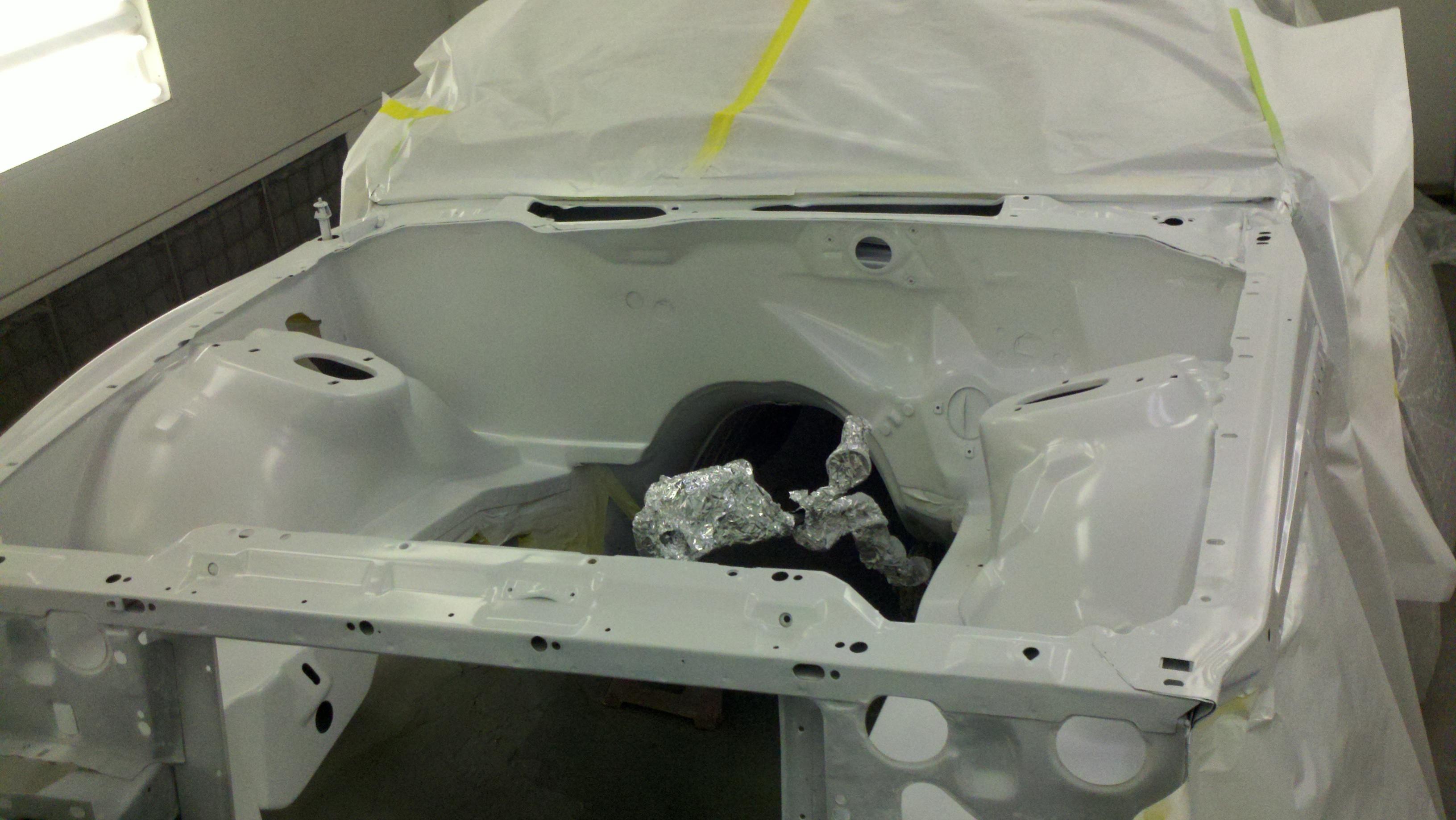

OK, so i laid down some paint. base-coat white then added a blue pearl on top to go the extra mile. i actually used the Cadillac paint code but instead of adding white pearl i added blue. this way i will always have a "factory" paint code to go by.
Attached Thumbnails rev-head stage 2 full build-download-25.jpg   rev-head stage 2 full build-download-26.jpg   rev-head stage 2 full build-download-27.jpg

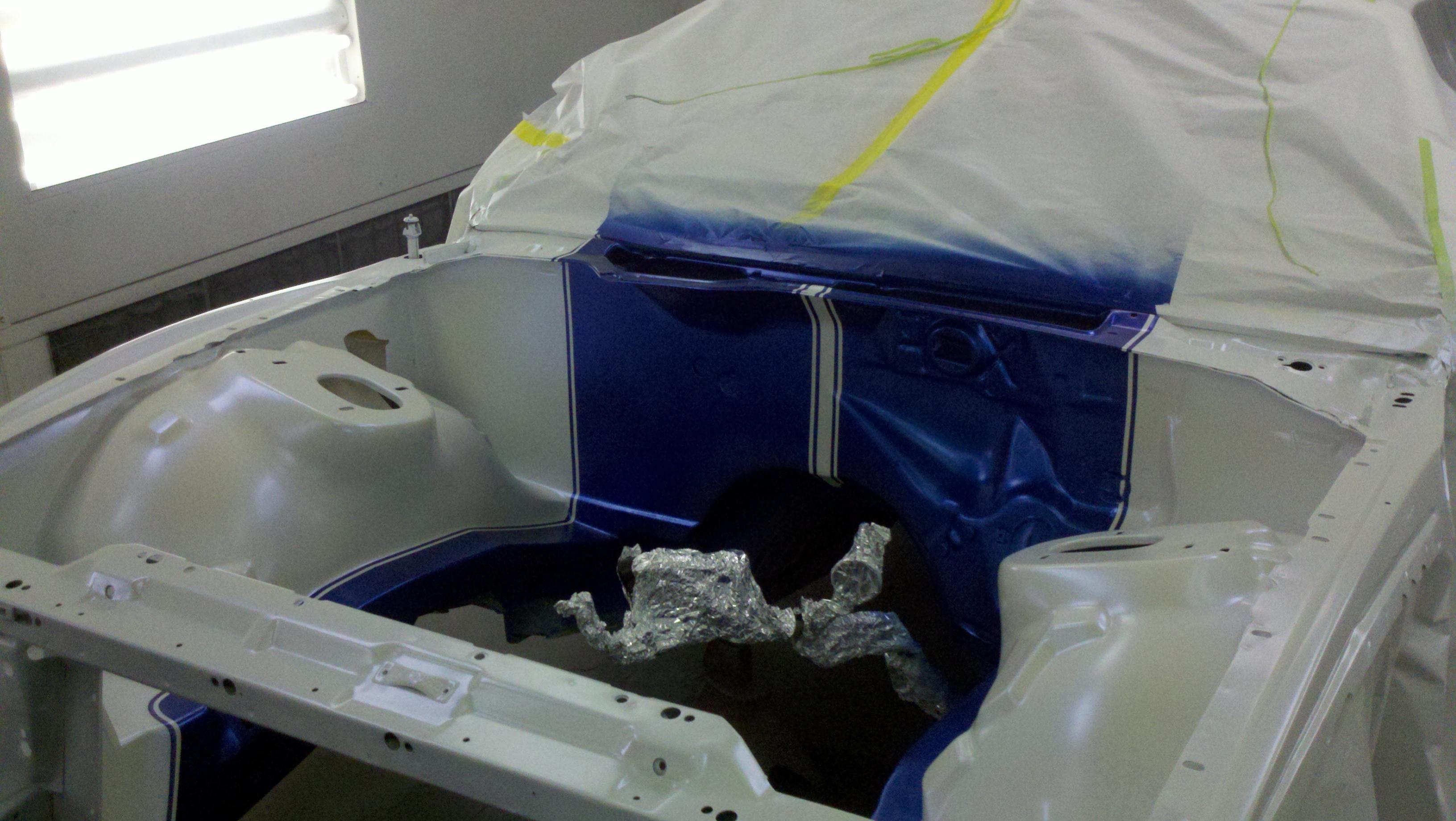

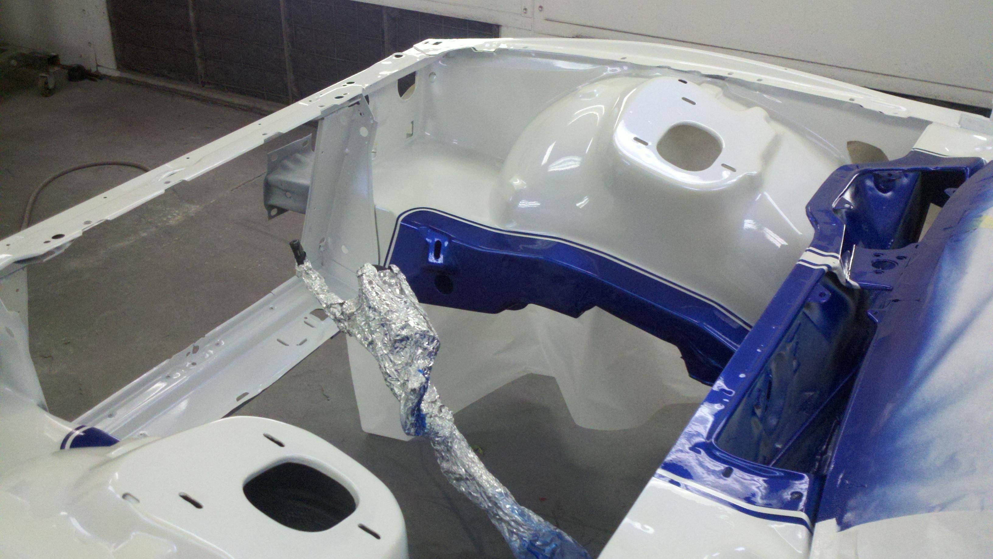

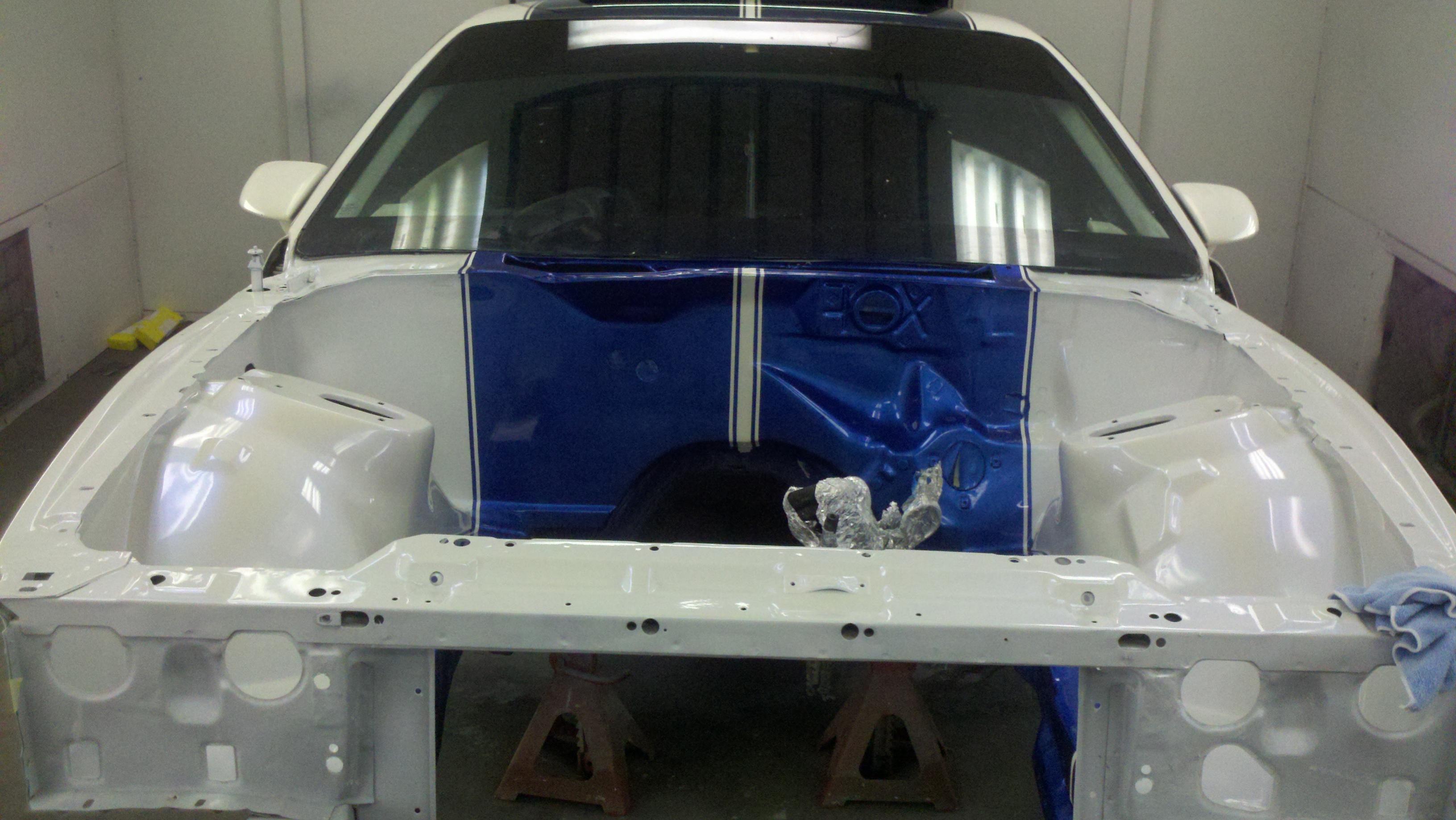

I laid down the stripes with the chevy arrival blue, and then laid another layer of blue pearl down. This time, before it dried, I took a wadded up trash bag, and dabbed it all over the stripe creating a marble effect in the stripe alone.
Attached Thumbnails rev-head stage 2 full build-download-28.jpg   rev-head stage 2 full build-download-29.jpg   rev-head stage 2 full build-download-30.jpg

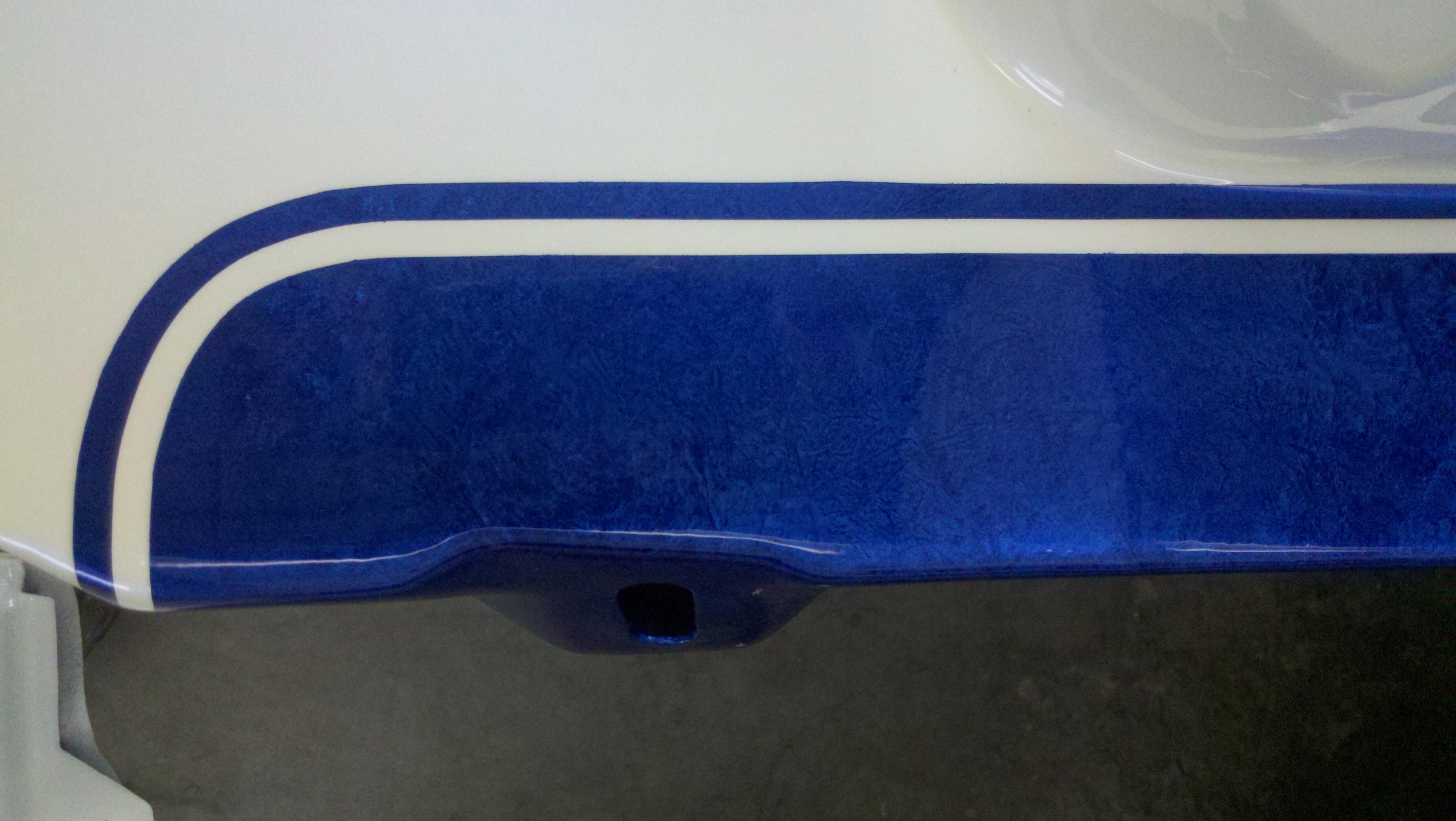

here is what that marble effect looks like
Attached Thumbnails rev-head stage 2 full build-download-31.jpg   rev-head stage 2 full build-download-33.jpg

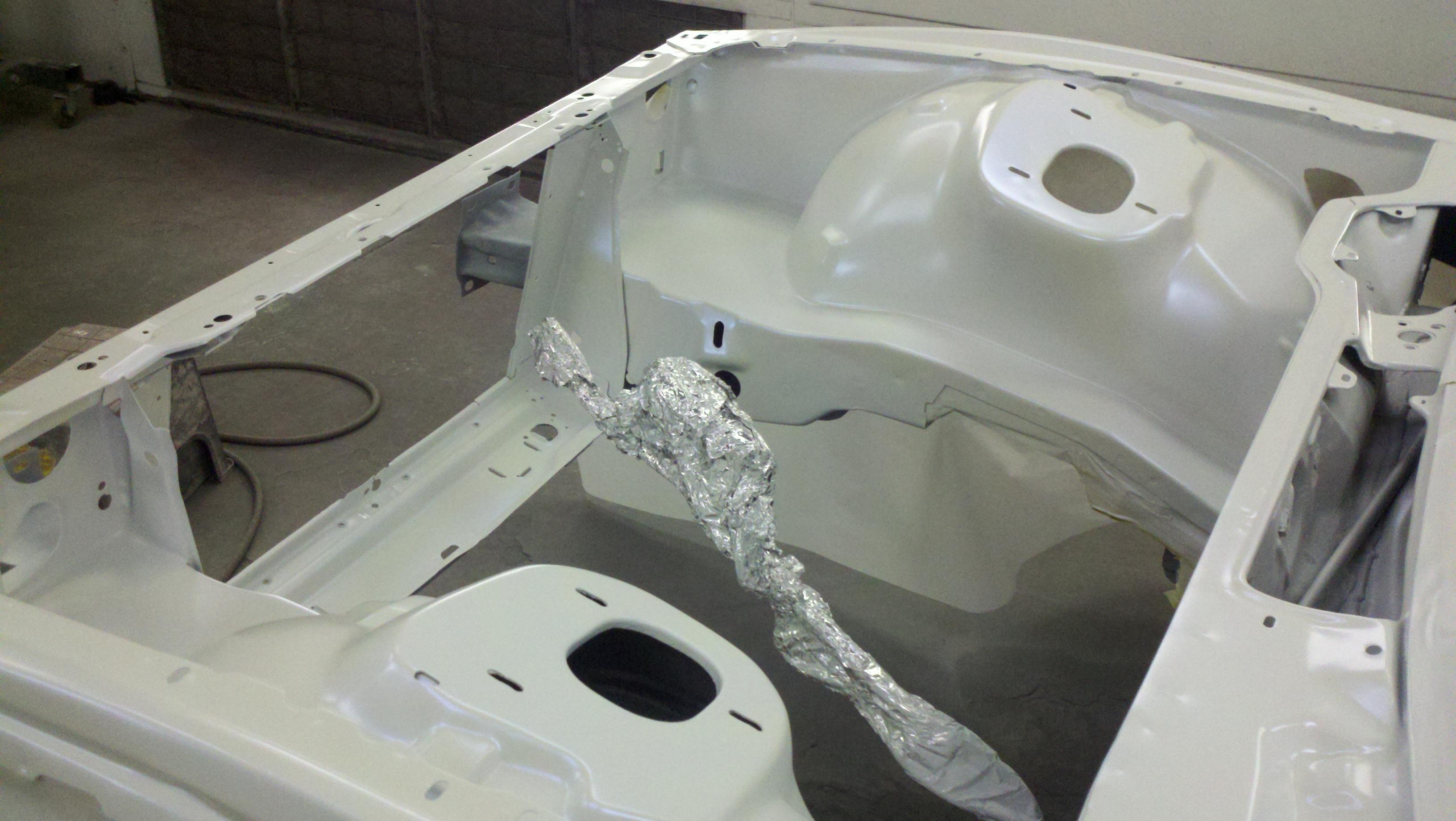

ChevyRS-305's Avatar
Joined: Mar 2006
Posts: 445
From: Sparta IL

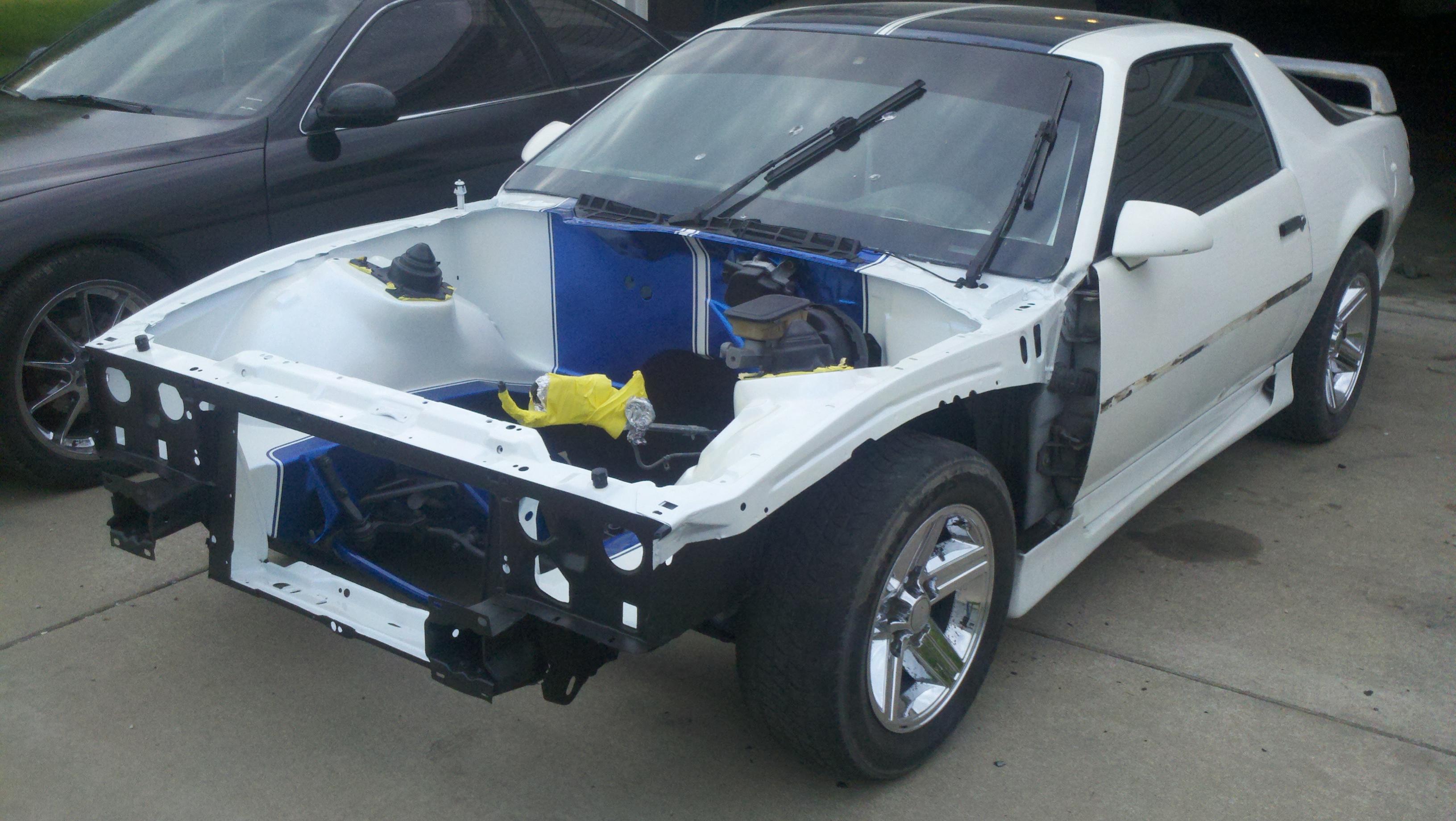

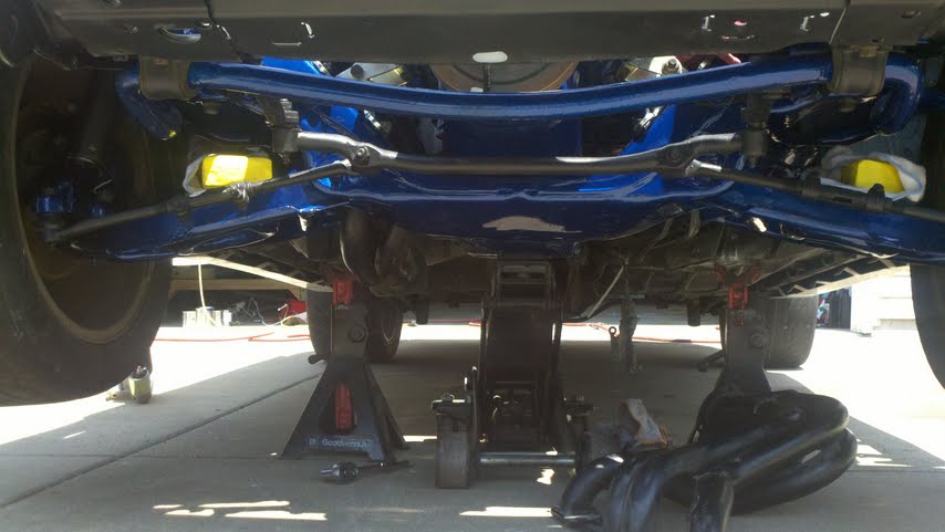

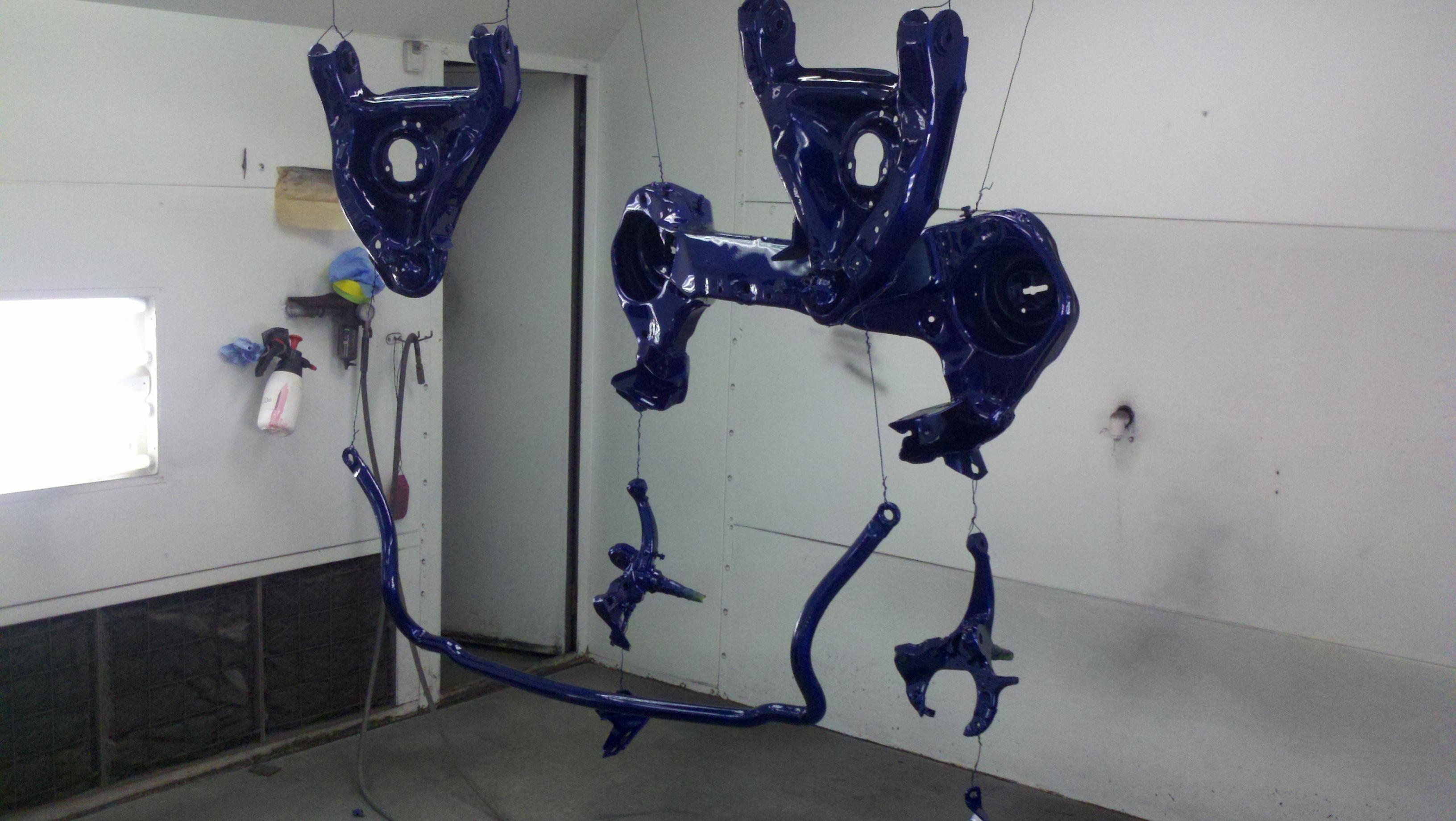

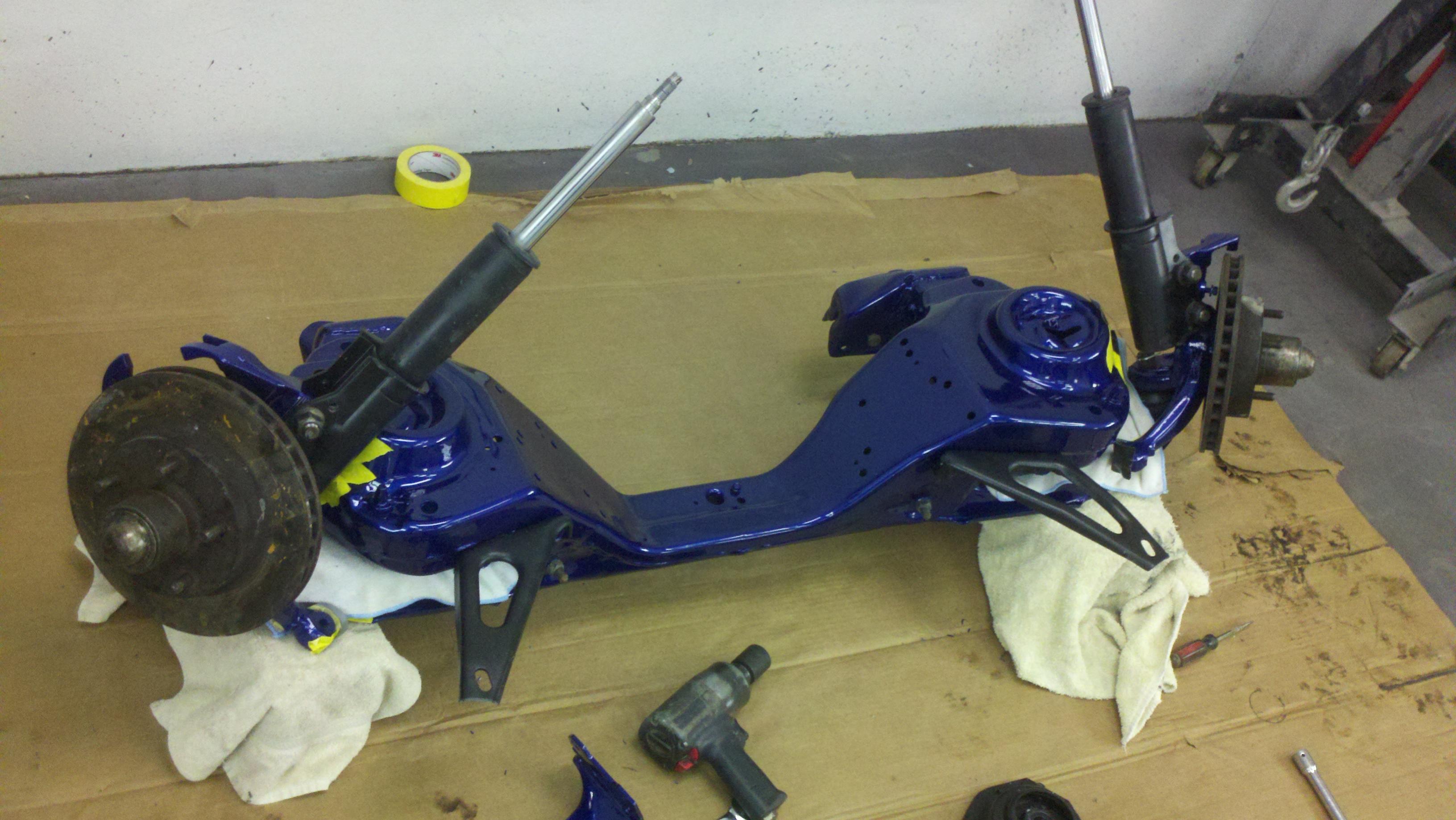

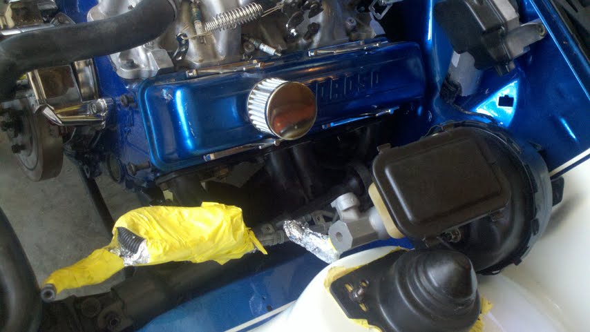

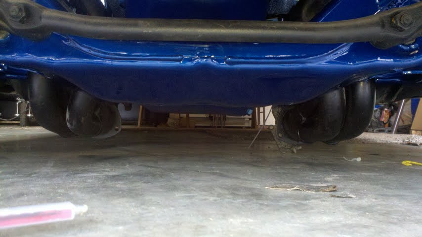

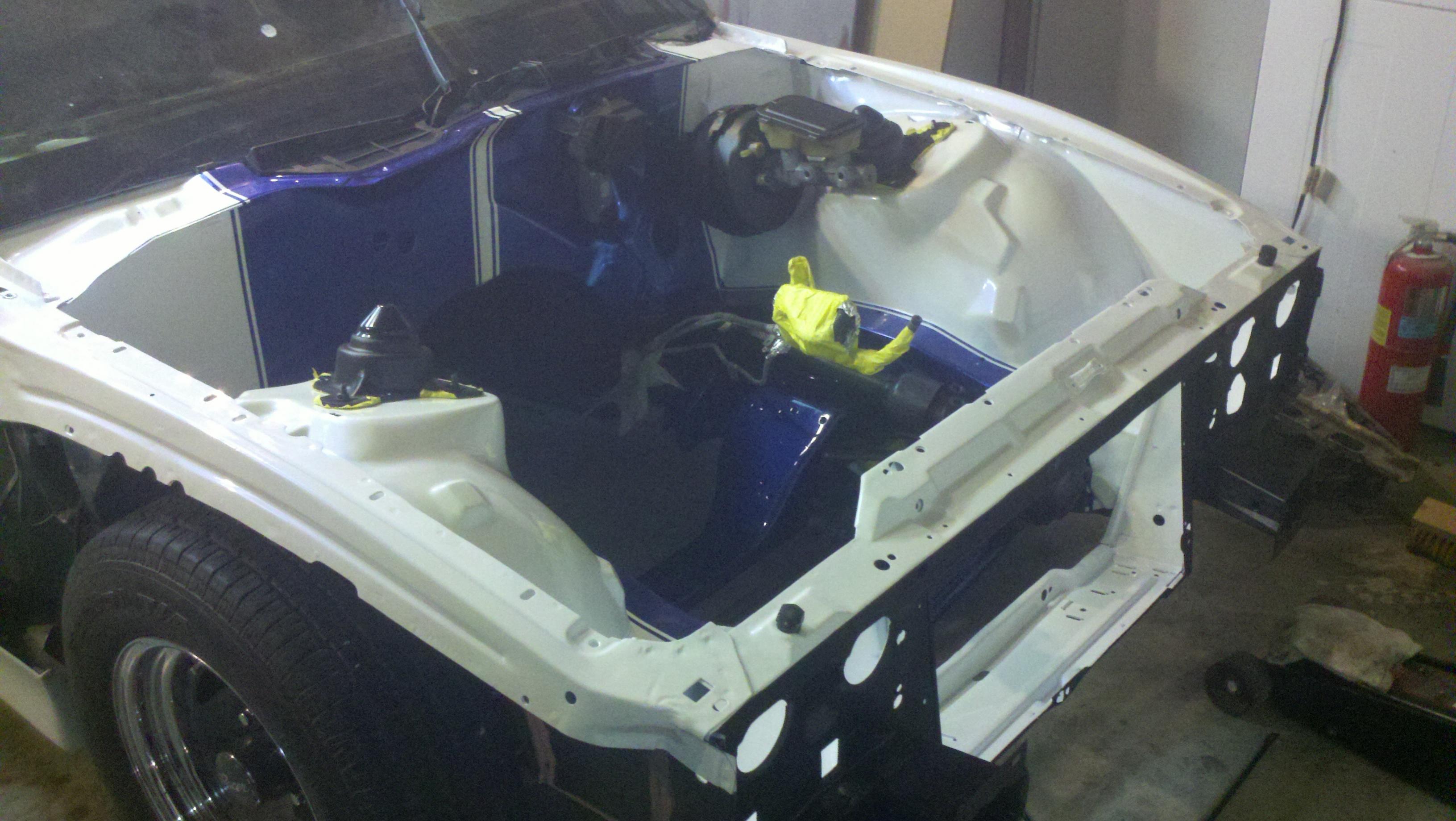

Also the suspension painted and assembled, and one more pic of the engine bay..
Attached Thumbnails rev-head stage 2 full build-download-32.jpg   rev-head stage 2 full build-download-34.jpg   rev-head stage 2 full build-download-35.jpg

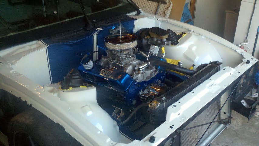

Well i refurbished my stock break master cylinder, booster, power steering pump, and wiper motor. Still looks vary clean i think. Also undercoated the front of the core support, the bottom side of the frame rail, and the wheel wells.
Attached Thumbnails rev-head stage 2 full build-download-37.jpg   rev-head stage 2 full build-download-38.jpg

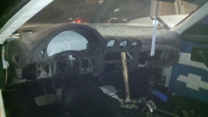

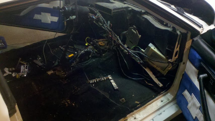

First pic is of a Mitsubishi 3000 gt dash i moched into place. Ill be making a fiberglass mold of it that will fit directly in a 3rd gen when done. Also got the Moroso solid motor mounts in and could finally install the engine. Still needs a few pieces to complete and replace damaged parts. (engine was stolen from me 3 years ago). Last pic is when i was installing my hooker long tube headers and figured it was a good shot to show off the suspension.
Attached Thumbnails rev-head stage 2 full build-download-36.jpg   rev-head stage 2 full build-download-40.jpg   rev-head stage 2 full build-download-41.jpg

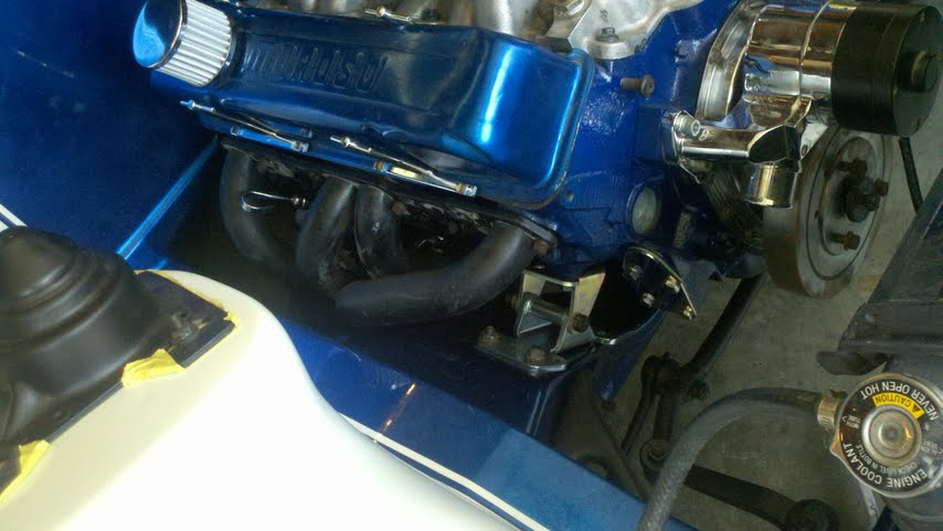

Hooker long tube header install. after the mini starter and oil filter were removed they fit beautifully. Didn't even scratch the paint. Note: transmission isnt installed yet so the engine sits at an angle making the headers hang lower than normal.
Attached Thumbnails rev-head stage 2 full build-download-42.jpg   rev-head stage 2 full build-download-43.jpg   rev-head stage 2 full build-download-44.jpg

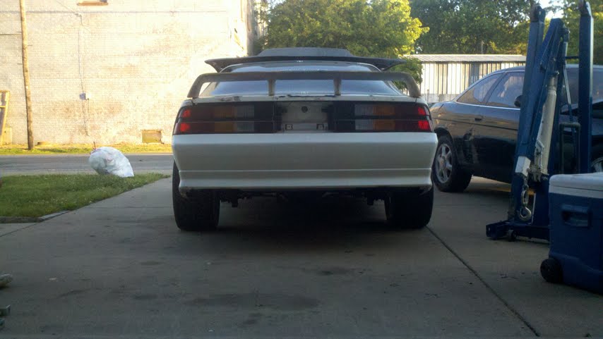

nice pic of my new z28 spoiler from the back. Also bought a set of zr1 wheels and my ss hood. Had to buy 2" spacers for the wheels. Thinking of sandblasting the wheels and painting them blue with the marble effect like my stripes.
Attached Thumbnails rev-head stage 2 full build-download-45.jpg   rev-head stage 2 full build-download-46.jpg

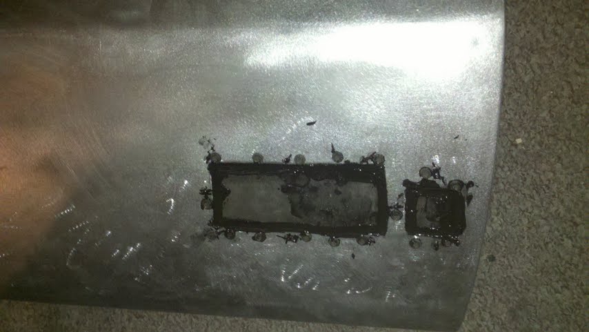

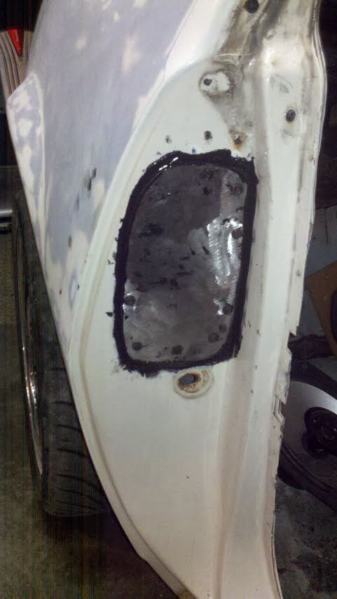

Shaved door handle time...more panel pond glue. Had to cut away at about an inch of the inner support
Attached Thumbnails rev-head stage 2 full build-download-47.jpg   rev-head stage 2 full build-download-48.jpg   rev-head stage 2 full build-download-49.jpg

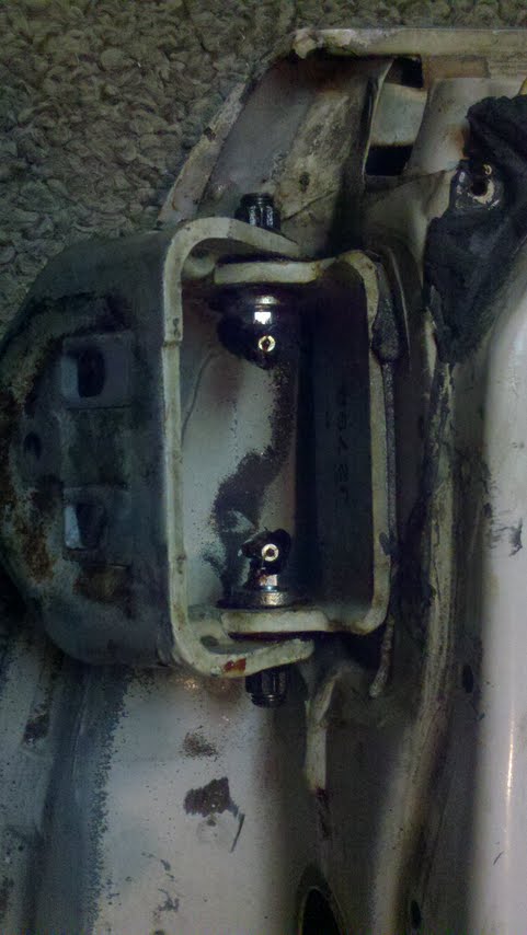

Shaved door jam vents as well. While i had my doors off I realized my upper hinge pins were bad. After realizing GM doesn't make them anymore,after i already cut them out, i gave classic industries a call. They shipped me over 2 sets of their grease-able upper hing pin kit for $110 a pop. I do want to note one thing: first fitment the hinges WOULD NOT LINE UP, then realized when i knocked out the pins with a hammer and pick, i slightly bent the bracket throwing off my alignment. After i bent them back they fit like a dream.
Attached Thumbnails rev-head stage 2 full build-download-50.jpg   rev-head stage 2 full build-download-51.jpg   rev-head stage 2 full build-download-52.jpg

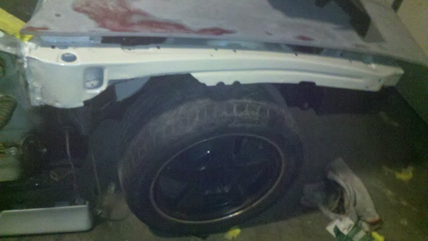

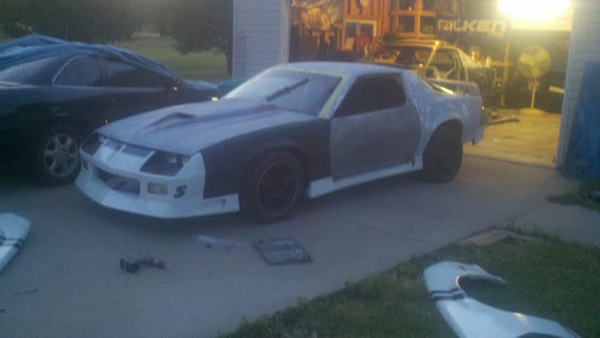

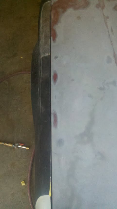

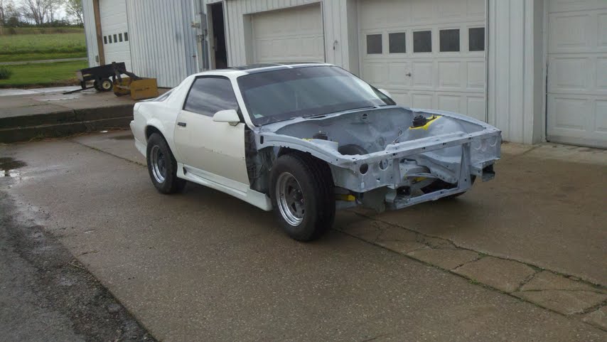

Basically how the car sits now. Here is what the hood to fender gap looks like now after i did all that grinding and shaving. Going to start body work tomorrow hopefully. I plan for primer in 2 weeks.
Attached Thumbnails rev-head stage 2 full build-download-56.jpg   rev-head stage 2 full build-download-57.jpg   rev-head stage 2 full build-download-58.jpg

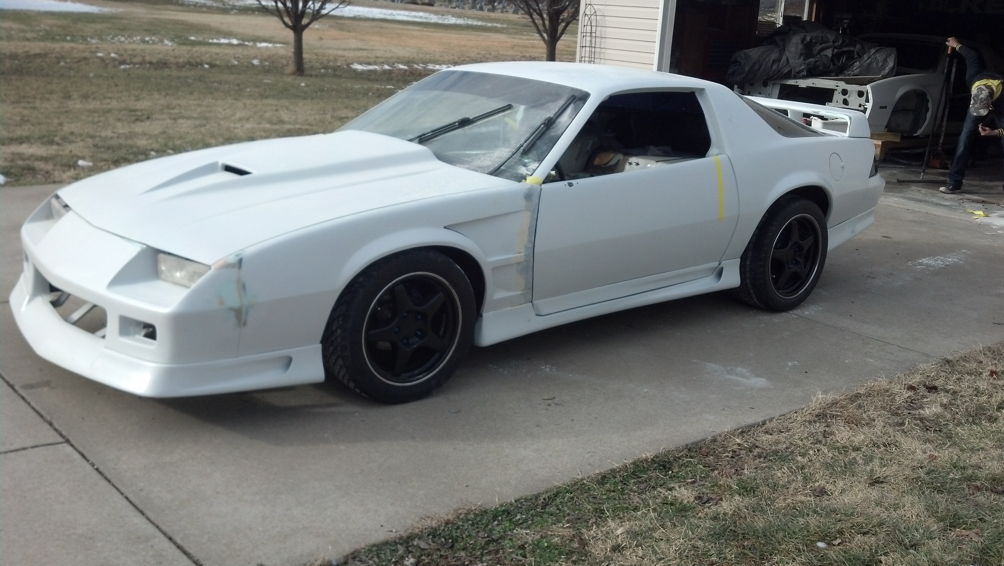

Well i have made alot of progress. I have EVERY SINGLE GAP flush and perfect. I have the car torn down again for post mock up stage and actually doing body work. In 2 weeks my wheels, hood hinges, door hinges, and backside of doors are being sandblasted. I changed my plans a little and im going with a t-56 i had laying in my garage from my buddys 95. I talked to steve from spohn and im going with their cross member/ torque arm w/ safety loop. Im also going to blue marblize my wheels and the rest of my suspension and roll cage as well.

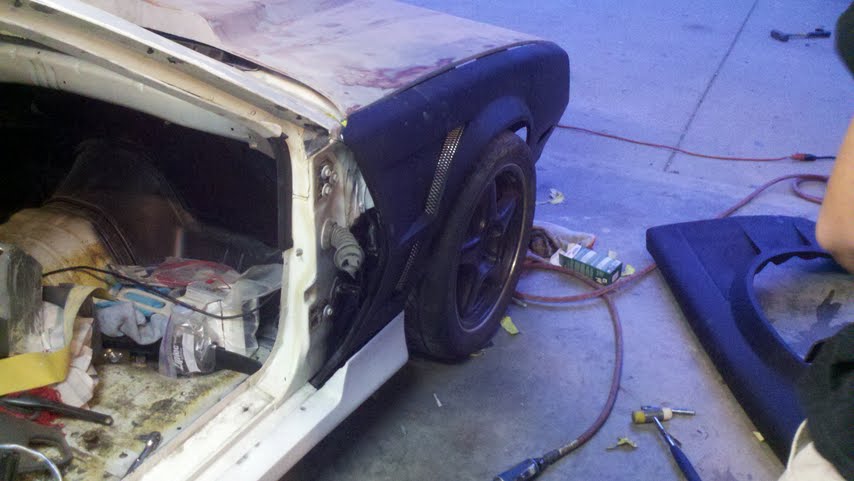

Well I accomplished reinforcing the backside of the fenders and happened to shave my side marker at the same time. I also cut out the opening on my ss hood and had to bridge the top skin to the back skin so it "flows" and gives it a finished look. Very killer looking. Here are some quick pics.
Attached Thumbnails rev-head stage 2 full build-2012-09-05_22-12   rev-head stage 2 full build-2012-09-05_22-12

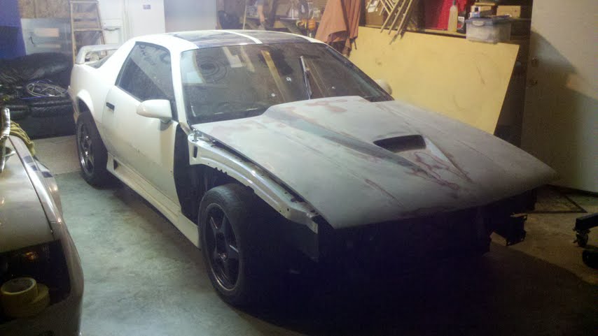

Well i have been hitting bad luck and couldn't prime my car due to cold weather so im forced to finish all my body parts and then prime them all at one time in my heated garage. So! Onward with the body work. I have gone ahead and finished up the bottom side of my hood shaving and smoothing the seams. Lots of work and have also moved to the bumpers and ground effects.
Attached Thumbnails rev-head stage 2 full build-2012-10-10_19-55   rev-head stage 2 full build-2012-10-10_19-56   rev-head stage 2 full build-2012-10-18_21-41

Found a solution to my sagging headlight buckets on my bumper. Took 1" "U" channel aluminum stock and glued them to the underside using 3m panel bond. Held in place using screws until the panel bond cures. Worked perfect and now gives me a solid surface to do my body work on.
Attached Thumbnails rev-head stage 2 full build-2012-11-02_20-12   rev-head stage 2 full build-2012-11-02_20-13

I have updates. Finally got, what might be my last warm day of the year, my warm day to primer. I assembled what i could of the car so enjoy...

Nice day outside again so i assembled a bit more on the car and took care of some little things i have been needing to do. So here it is minus the bumpers and ground effects being done

Fully assembled teaser for you guys
Attached Thumbnails rev-head stage 2 full build-2012-12-01_13-06   rev-head stage 2 full build-2012-12-01_13-03   rev-head stage 2 full build-2012-12-01_13-37

Eh...been fixing a few body flaws here and their. In the process of fixing this god awful door gap issue but making excuses up to put it off... ABSOLUTLEY HATE MESSING WITH FIBERGLASS. Bu basically all body work is done just boring stuff. Oh! I did much up my t56 and installed my driveshaft, car has a full drive train in it for the first time in over a year so that's exciting. Also my buddy sold his s10 so he finally gave me back my zr1 wheels. Had them on their a whole 2 days and then sold them. Going with 18" c5 wheels instead to clear the ss brembo brakes.

Actually I had a guy hit me up on FB from Chicago and asked me to make him some from the stock fenders...I charged him $300 and he is coming to get them tomorrow. Since their the original fenders they fit like a glove and save you all that time and labor to get them to fit right.
Old Jan 10, 2013 | 11:04 PM
  #43
Joined: Mar 2006
Posts: 445
From: Sparta IL
Here are a few pics..first is my zr1 wheels(woohoo) but you can see all the little spots I fixed, second pic is of the stock fenders I created for this guy, third is the best pic I had with my t56 in

Nice job fixing the gaps, it looks a lot better now. How much time did you have fabbing up the steel fenders, and do you have the ss brembos in the rear as well?
Old Jan 11, 2013 | 08:21 PM
  #45
Joined: Mar 2006
Posts: 445
From: Sparta IL
About 6.5 hours from start to laying down primer.. but then again I'm quick because I do this every day at work. To the average person they could do it in a weekend. And as for the brembos yes I will be using the brembos for the rear, reason being why I had to upgrade wheel sizes. I have not yet purchased anything for brake system yet but I do have a guy that owns a CNC machine whom is going to machine me up a caliper bracket so I can run dual rear calipers(one caliper will be used for my hydrolic hand brake).
