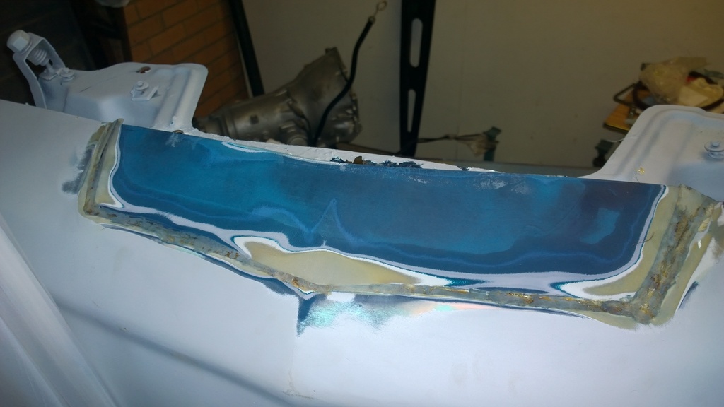

Small update,
This is what I've done so far:
I used some cardboard underneath to give a base, and then laid a few pieces of fibreglass matting to match up to the front angle of the bumper, and lie over the metal tabs I bent down, let it set and then used body filler to try and smooth it out, then another layer of fibreglass matting over that after it had set to build it up to the height I needed...
If I was to do it again, I would probably get a few pieces of plastic and pop rivet it to the plastic bumper and metal tabs to give a closer gap to fill along with some reinforcement, and then fibreglass it.
When I was putting the body filler on I put lights on it to help cure it faster as it's winter here, and the bumper unfortunately sagged away from the filler completely. When it cooled it went back to the original place, but I've fixed that by fibreglassing over the bumper joint now and reinforced the corners. I'll upload some more pics when I get the chance.
I know it looks pretty horrible by any standards, but it is my first time fibreglassing or doing any sort of body/panel repair or mods, so it's a learning process.

Look forward to see how it comes out. I thought that fiberglass did not work well with these bumpers. They would crack and pull away. If now that opens up a whole new option for bumper mods
Old Jul 14, 2015 | 11:34 AM
AmorgetRS's Avatar
iTrader: (6)
Posts: 5,646
From: Near Seattle, WA
Re: Anyone modded front bumper to install kitt scanner?
Fiberglass doesn't work well, one bump and it will crack.

On the plus side I'm not planning on bumping the bumper, given the position of fibreglassed bit, hopefully the plastic part will absorb any minimal impact without cracking the fibreglass, but we'll see. worst case scenario, it does, and I take the bumper off and try plastic welding instead, yay hobbies.
Old Jul 14, 2015 | 05:30 PM
AmorgetRS's Avatar
iTrader: (6)
Posts: 5,646
It may not even take a bump. The different rate of expansion between the two may crack it just from heat cycles. It may also crack just from flexing during normal driving.
Hopefully it will hold up well for you.

I'm hoping so, the light is still 9 weeks away so I still have a bit of time to start again if I need to... I'd really rather not, but maybe if I brace it from underneath?

You can use the plastic filler with aluminum mesh for reinforcement. It will flex the same as the rest of the bumper. I like the SEM plastic filler.

Do you think that'd work as a top layer, or would I have to cut the fibreglass out and start again?

You might be able to put it on top. If you make a complete shellf over the fiberglass, the fiberglass will just crack underneath.
This is polyester resin yes? There's a good chance it hasn't bonded well to the plastic and you can just break it off.
After thinking about it, I would probably just do the job with epoxy resin and glass. You can get very flexible epoxy resins and it's easier to work with than the plastic filler. You can mold the tray with wax paper. For that small area you won't have to worry about it cracking off if you give the epoxy a good rough sanded surface to bond to. You can't use mat glass with epoxy, but a couple layers of 8-10 oz glass cloth should be fine. You can use some epoxy coated plywood as a good base to mount the light to.

They make an adhesive (urethane adhesive?) for our bumpers. I might have tried getting an old bumper for general material and using the adhesive, reinforcement material, and use the commonly known repair techniques to attempt the mod.
Google: urethane bumper repair
I agree on fiberglass being a bad idea. -sorry.

That would be great, but in Australia there's no such thing as spare bumpers, especially not for chopping up to use for material.

You don't need a Thirdgen bumper, just another urethane one.

So quick update:
Decided to do it the right way:
Pulled the bumper (that was fun), had to take out the lights as well, and then knocked out the fibreglassed bit to start the welding
