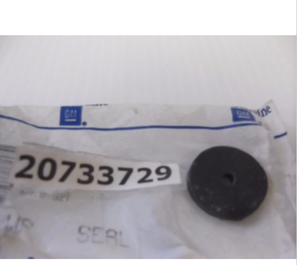

It's been some years, but IIRC, I used the following. The 3M product will work as well (make a little ball of it and smash it flat and you have a washer).
JamesC
Attached Thumbnails Spolier Nuts-screen-shot-2015-11   Spolier Nuts-img_3726.jpg
