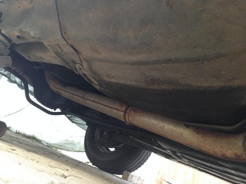

I have minor holes in the floor pan on passenger side from leaking T Tops. Do I have to weld in a whole new piece of sheet metal, or can I patch it with a material of sorts. I can stand on it right now and it doesn't move, I only ask cause i have limited access to a welder. Thanks in advance fellas.

From underneath, looks pretty clean.

You should be able to patch that or even just POR it.
Its possible the fender is out too far.There are bolts near the hood hinge for the fender.loosen & push the fender inward, see if that solves the issue.
