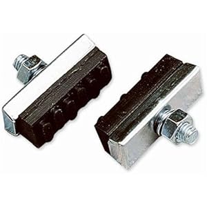

While these aren't the exact size I used, I cut off the stud/washer on one side and used these for my window stops. (stole mine from efi fox body air boxes)
https://www.grainger.com/product/2NP...180422144007:s

I replaced mine years ago with a modified polyurethane bump stop.
But recently I ran across a post somewhere that said to use bicycle brake pads.
I think they might actually work perfectly. Available everywhere - and cheap too.
