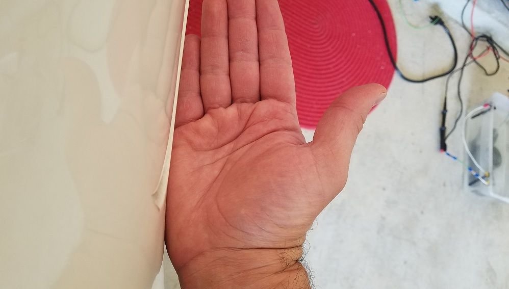

Quote:
Here are some pictures. I haven't really been able to get it much better. The whole door or whatever it attaches to needs to come out of the car body by almost a quarter of an inch.Originally Posted by 69L48Z27
The rubber bumper on the opposite side of the hinge is a screw. You can adjust out there also. If your hinge side is that far off you don’t have something put together right of the filler flange is screwed up. Post a picture of what your working on.
That's better than they were new. Back in the day some people replaced them with I believe grandam doors as they use inside the car releases. I'm sure there is a write up here somewhere.
Yeah, that looks pretty good. There are a couple screws that you could loosen and see if the hing will come out any further. If not, you would need to ‘clearance’ the hinge area to move it out.
Ive always been able to get it flush/centered by the 3 screws on the mounting base.The key is to hold the base in place while tightening down the screws.Do the two front first, then the rear long one (not too tight on that one).Takes a few tries, but it works for me.
It sounds like my suspicions are confirm and there is not dedicated way to adjust it. You just have to tweak, shim, file, etc. between all available attachments until it is right. Thanks for the help guys.
