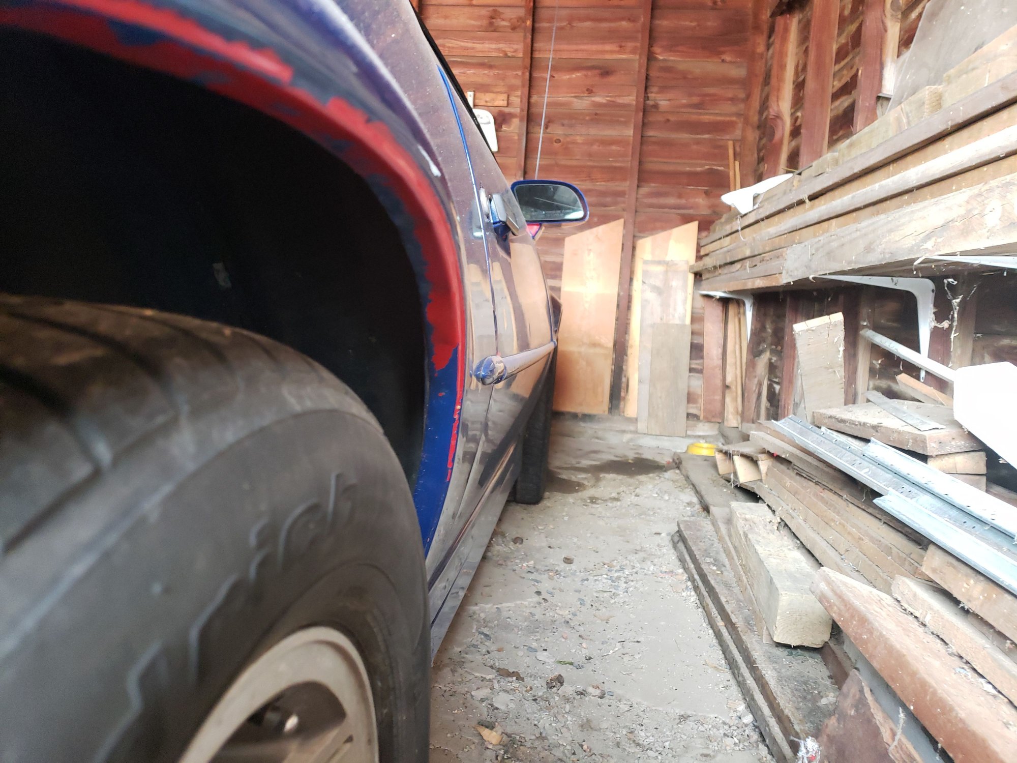

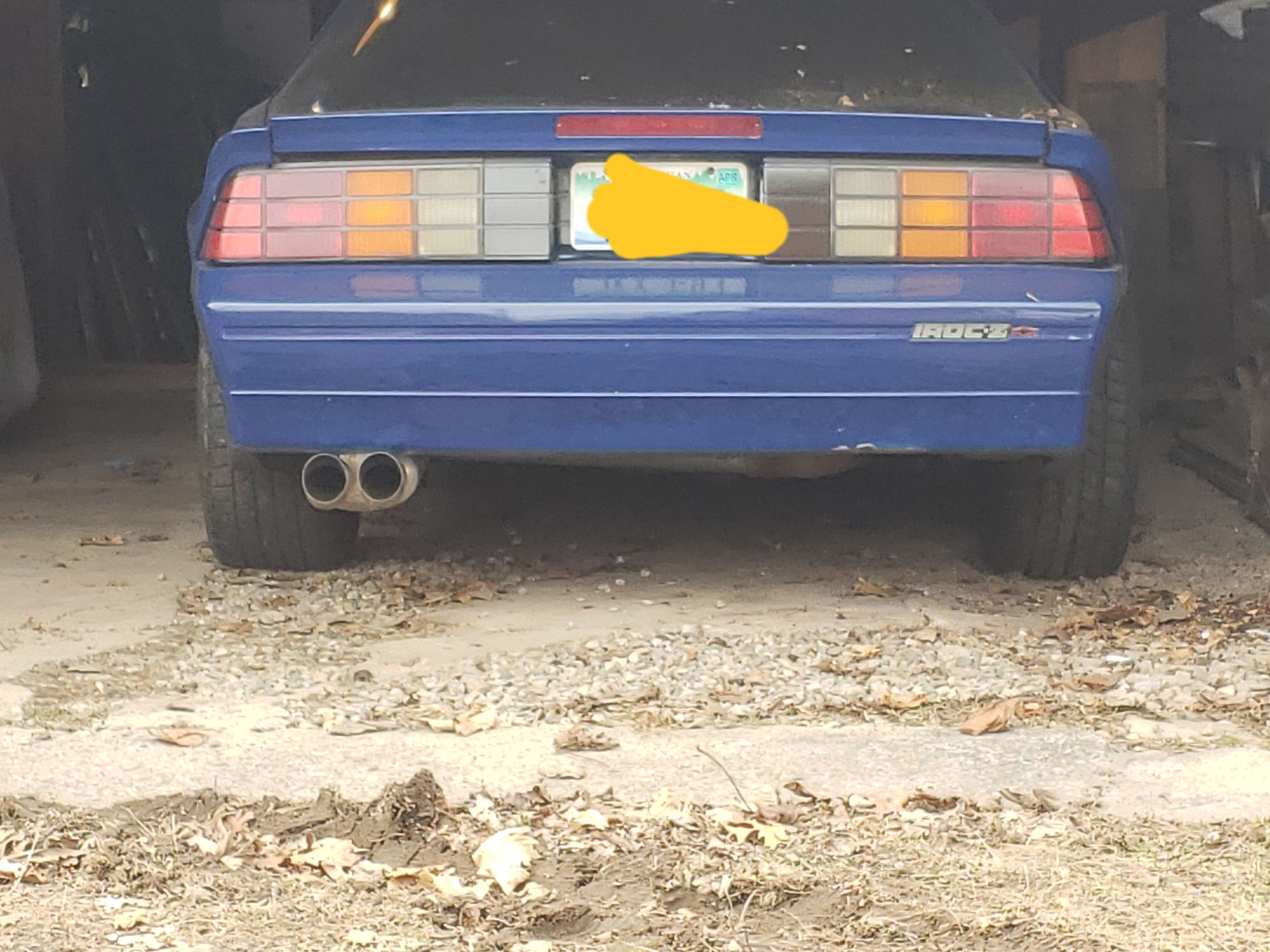

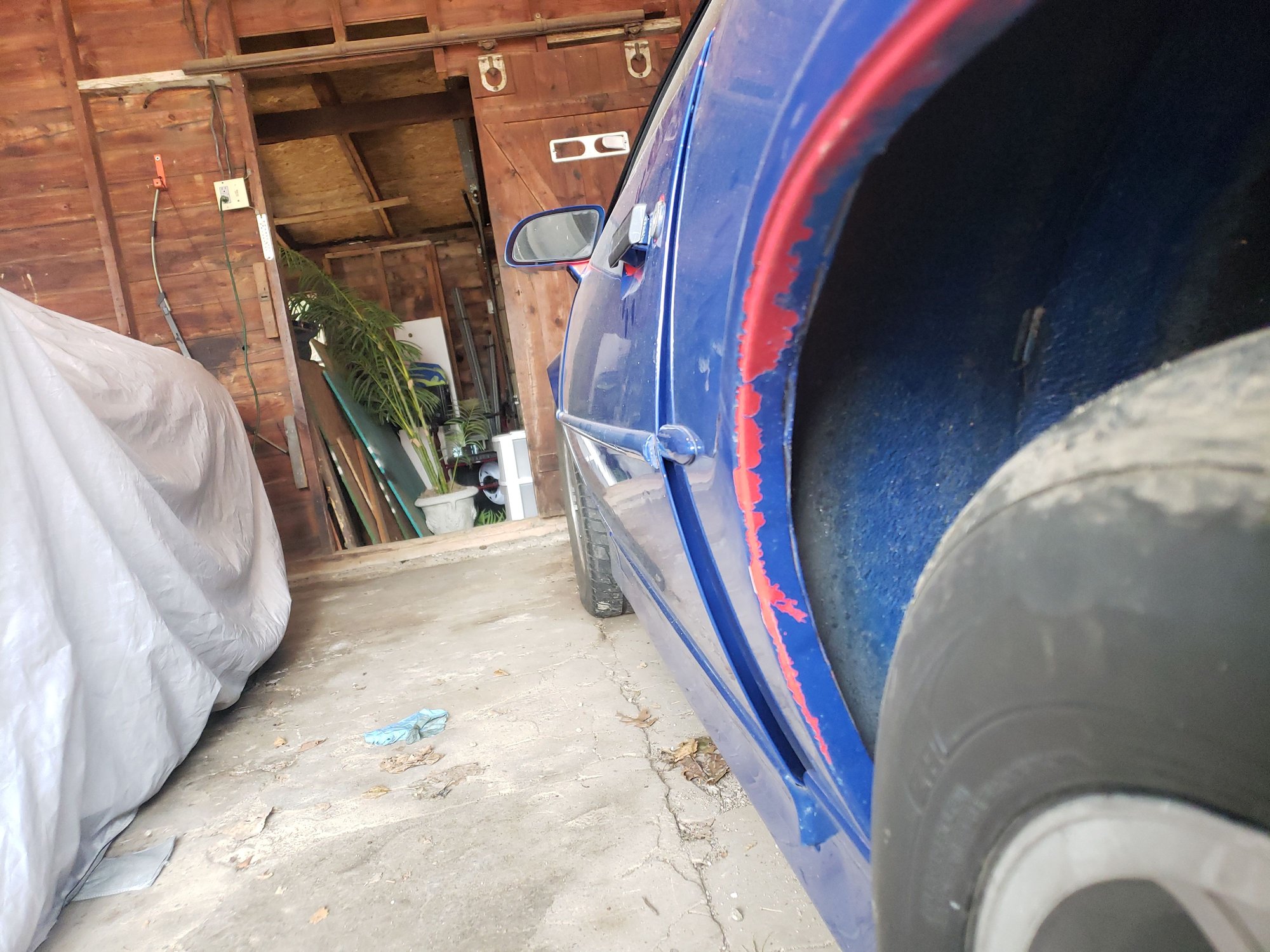

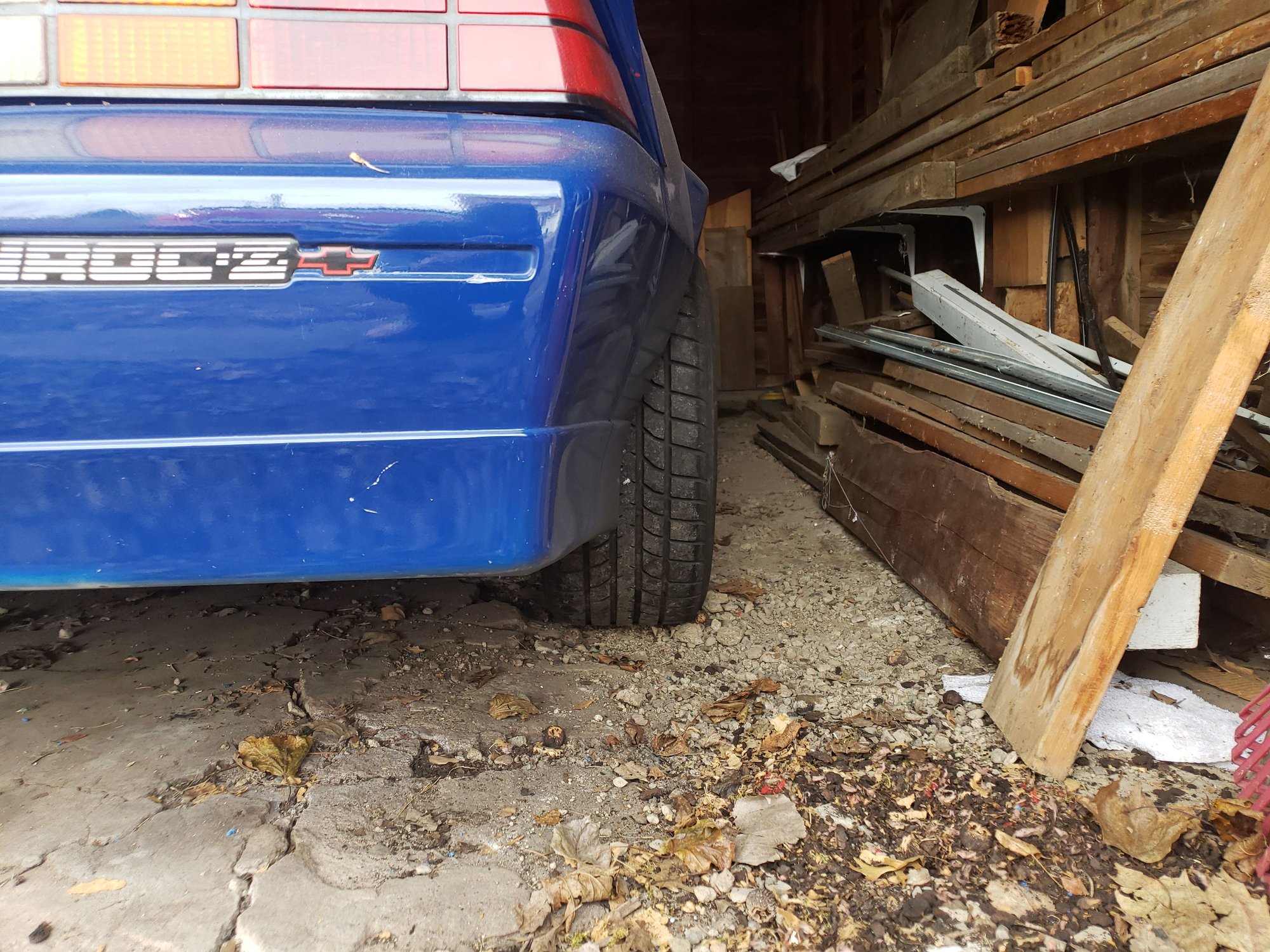

Let me know if you need different angles, and please excuse the mess!

I have questions..
1. Did you replace any bent suspension parts?
2. Does the hatch pull-down work, or is it bound up from the rear end being shifted?
Other than the rear axle being not centered in the car, it doesn't look that bad. The driver's door sticking out at the bottom is possibly worn hinges...

Driver side is definitely from the frame, as I couldn't open the door easily after the incident.
I replaced a few suspension parts, anything that could be bolted on. Namely the panhard bar and the control arms back there.
I also had to replace the driver side axle, which was a but hard to find, as this was the disc brake axle with the 3.45 gears.
The hatch opens, but the entire mechanism shattered, I'll need to buy a whole new unit.
