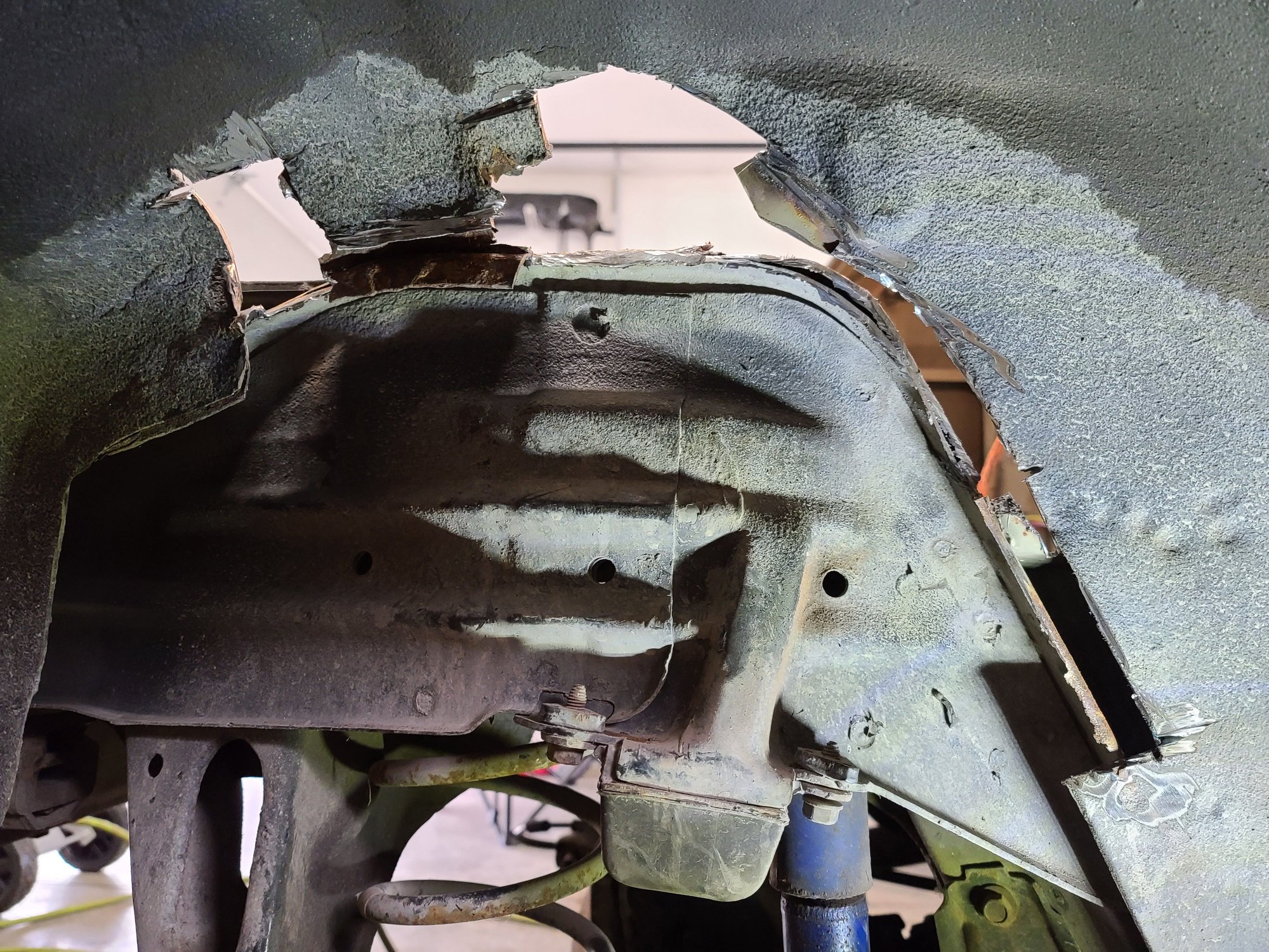

So here is the area, im just basically in the process of getting the rust out. I prefer to keep that brace in the center if i can clean it up enough. The thread link noted above pretty much covers the repair very nicely. Dave

There is likely rust underneath the brace. I would drill out the spot welds (with a spot weld drill bit) and take it off so you can get behind it and repair the metal. The brace is thicker metal and I was able to save them on both sides.
Spot welds and I are not friends but i just got started on it. BTW I will definitely send some questions your way. I have many and thanks help.

Yes, they can be a bear. Some people drill through both layers of metal with a regular drill bit (3/8" is usually close). That's pretty easy, but if you are keeping the base metal, then you have to patch that hole and that's even more work. I used a spot weld bit from Eastwood, but it's slow, takes a lot of force to make it cut and it dulls quickly. I went through 3 of them on the project and I sharpened them many times with a small hand file. One technique that worked well was to drill a very small pilot hole in the middle of the spot weld (all the way through both layers) and that lets the spot weld bit center better and it cuts better. The small hole is easy to weld up and grind flush. Once you get a group of spot welds cut through the first layer cut, then split the two layers with a hammer and chisel.
