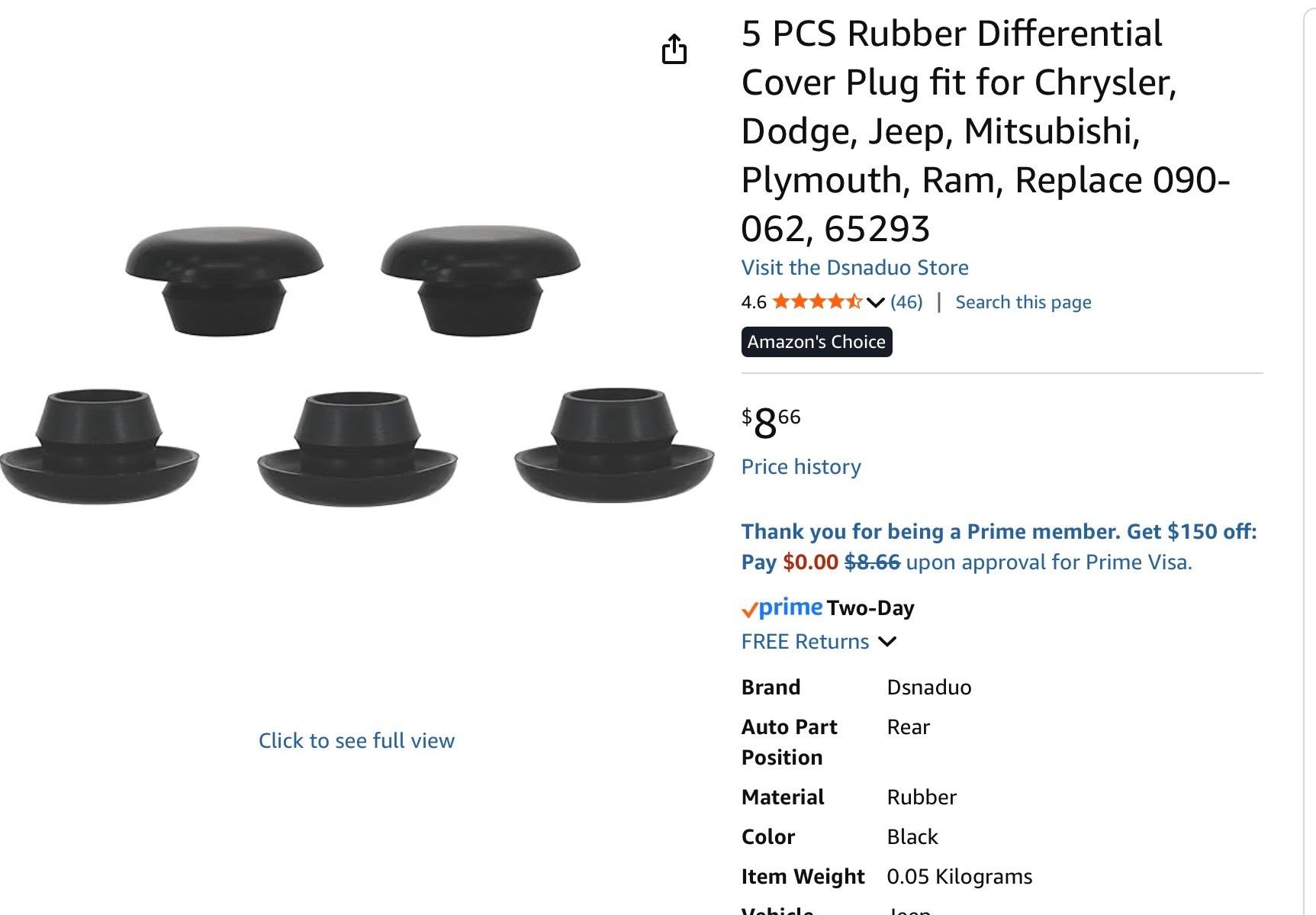

Re: 9-bolt oil fill plug discontinued?
These would work?

Axle/Gears: 3.27's.
Are the ones I posted above for the Dana44 on the Jeeps that would work?

Originally Posted by Aaron R.
Four different 3rd Gen enthusiasts just offered you good advice in this thread. In the time it took you to post in this thread you could have measured the hole, found your replacement, and clicked "submit order". Just go do it. Or choose the harder, but permanent option and go the welded in steel bung option. There, more help given. You are welcome.
Still no help. I must be the only person replacing the rubber plug on his BW 9-bolt after it was discontinued by GM. Yes, the plug that’s in it now I purchased from a Chevrolet dealer back in the mid ‘90’s right after I bought the car.
I thought someone here would know if the plugs on Amazon would work since they are for the Dana44? on the Jeeps and Mopars etc. They didn’t give out measurements in the description.
Now, I have to measure the plug or take it out and go to a parts/hardware store and match it up. I don’t mind doing that, but if I knew the specs I would give out the information. Why give me a hard time just for the simple question of asking would the Amazon plugs work?
