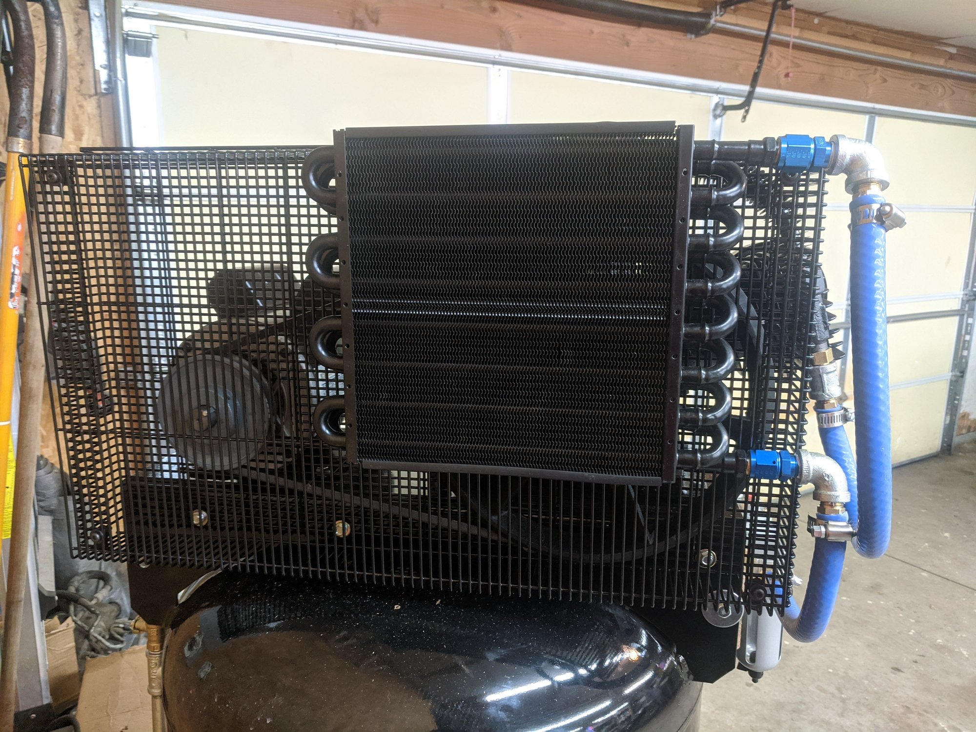

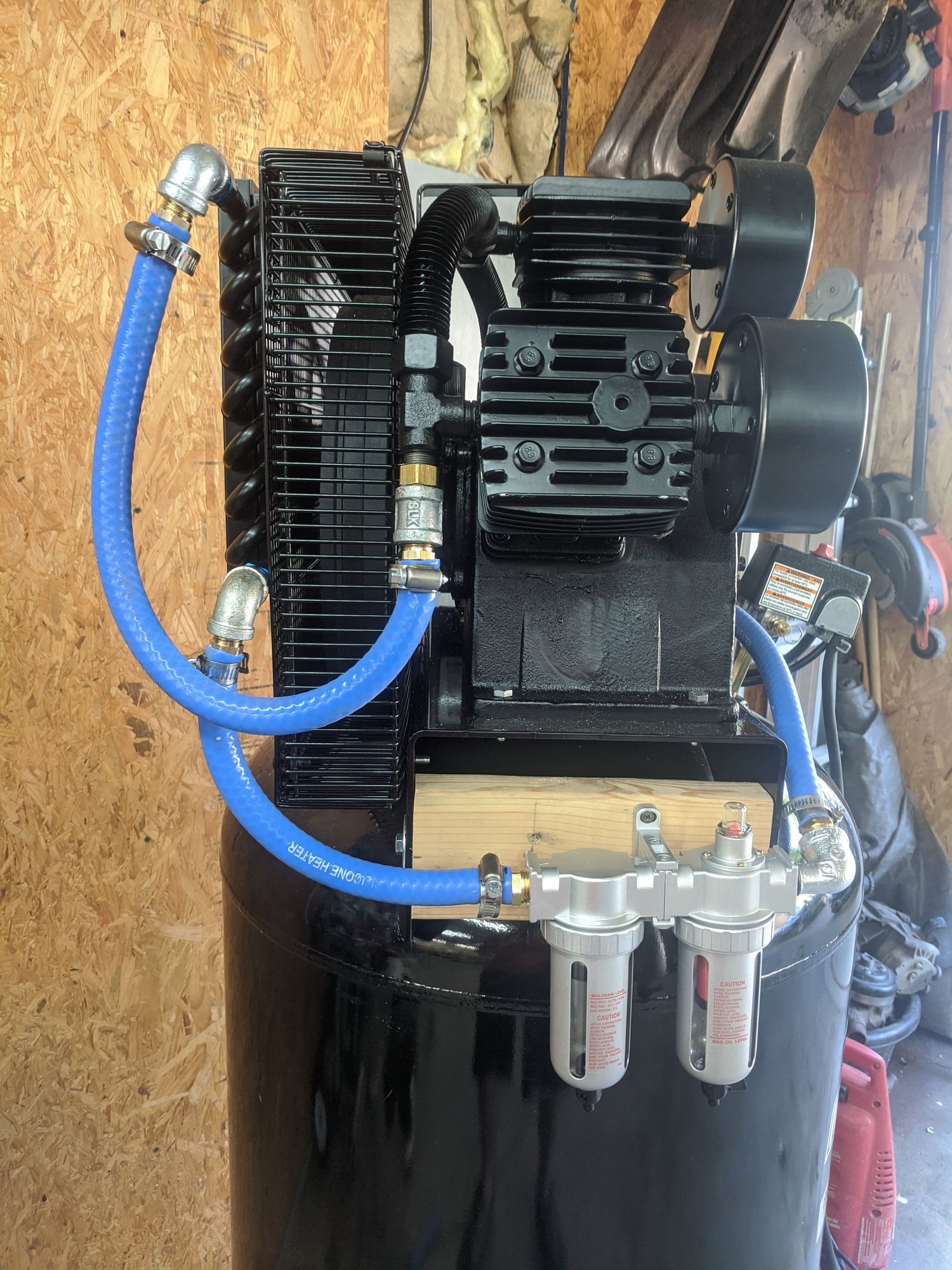

If you're short on space I found that plumbing and sandwiching A/C condensers together with a fan running through them will cool the air down real quick. I ended up using a transmission cooler and separator in-between the pump and the tank and it worked out great. Very little condensation in the tank and then added another separator down line for the blast cabinet and painting.
That's a great idea. Do you have a part number or make for that trans cooler?

Re: Paint Project - Compressor question
Yup it's a
Derale 15300 Derale 15300

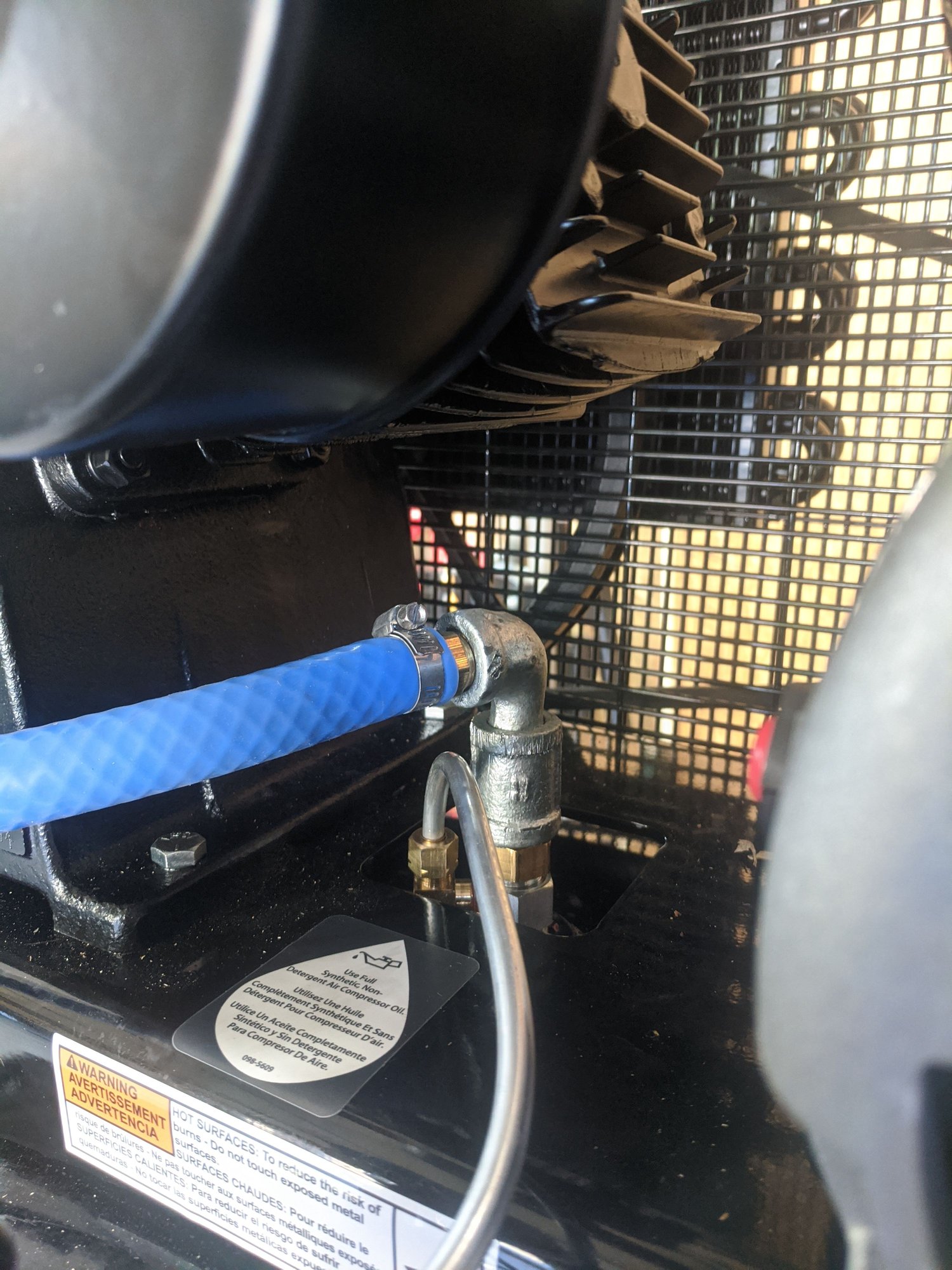

Originally Posted by Abubaca
JHarrison, that's a great idea btw. I like it.
Thanks I stole it off of a YouTube video. I have also seen guys use old A/C condensers from the junk yard, but I wanted to make sure it didn't leak, so I bought new.
On my setup the tube coming out of the pump is 200+ degrees and by the time it hits the filter it's 85. If you're going to run a setup like mine you have to put a separator between the cooler and the tank or it will just pump the condensation into the tank. My separator empties automatically each time the compressor shuts off and the bleeds out.
