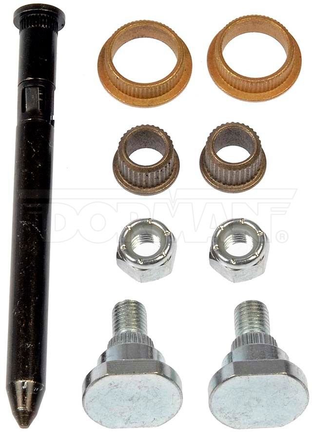

For the lower hinge....the silver hinge itself comes with the entire roller and roller pin, as well as the two brass bushings already pressed in and ready to roll. ....the vertical black pivot pin I got as part of Dorman kit 38401, which also included the upper pivot/pins/nuts and bushings. That kit also has new lower bushings, but I already had those as part of the hinge kit. For the record, I recommend doing the top too, but since we're not discussing that....I haven't elaborated on that.

.....also....Lon at Top Down Solutions sells a serviceable kit with all the same pieces as the Dorman kit. It's CLEARLY superior, as well as more expensive. In this case I feel like the first hinge made it well over 100k miles. I figured if the car goes another 100k and the Dorman kit needs replacing...I'll eat crow then.
