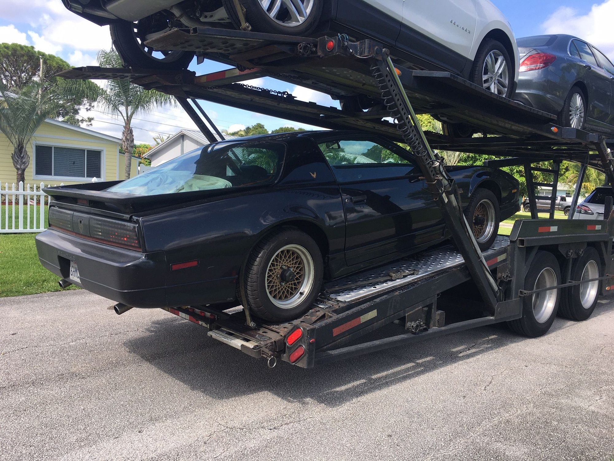

Well I finally got the hatch glass replaced on my 1990 GTA. It's "new" (never installed) aftermarket glass. The protrusion of the rear deck is back but the upper part of the glass seems properly close to the roof line. Maybe the lower four holes in the glass, or even the upper four, are a few millimeters too far down. Who know? I just hope it doesn't shatter again! The bigger problem is increasing shaking in my left leg (lumbar damage from my career) which is making it hard, if not dangerous, to drive a clutch. This GTA (1990) is just 1 of 78 built with a 5 spd. Might have to let it go, look for another Gen III w/an auto transmission (egad!).
