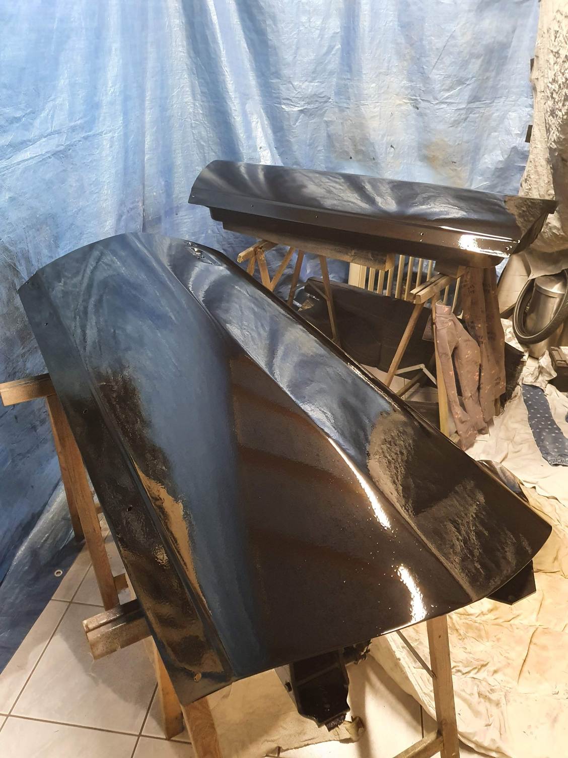

Well, not saying this is the correct or the best way but it is at least a way of getting a decent result. First, firmly decrease the current paint before you start sanding. You need to get rid of any silicone based stuff that might be on your current paint. Be meticulous, or else you will sand the stuff in your current paint and the new paint will not bond and eventually will peel off. Use specific silicone remover for this step.
Next step is sanding. If you want kind of show quality you need to step up the grid of sandpaper and sand a lot. If you just want a nice looking car, sand it with an orbital sander and 320 grid paper.
Make sure there is no bare metal. If there is (or any rust that needs repairing) prime that and sand again with 320 grid.
After that, you can paint. Use 2K paint, hardener and max 5% reducer. Use a paint gun with 1.4 or 1.3 mm nozzle. Make some test passes on cardboard to adjust the fan width of the gun and amount of paint that it drops. Pressure around 23-25 psi should be good enough. Also, make sure you have a moisture detractor installed on your compressor (water does not mix good with paint).
Test on the panels what works best overlapping your passes and getting an even spray out. This is trial and error.
Most important variable is temperature. Make sure you use the correct paint hardener for the temperature you are painting in. With normal hardener you will need around 20 degrees celsius air temperature and metal temperature.
After a couple of 2K coats, let it dry and you can sand down any orange peel or imperfections with a automative wet sanding paper. Use 1500 to 2000 grid, a sanding block and make 'X' shape passes on your panel. After this, use a polishing wheel to further cut and buff the paint. Stop until you get the finish that you're OK with.
Look on youtube on how to setup a paint gun;
On prepping for paint, the spraywaycustoms channel was very informative for me.
Below a picture of my end result after paint, but before cutting and buffing. I used a simple 50L air compressor for this.

An update.
A tad more difficult than just wheeling it out, cleaning and painting.
Changing hatch struts can be an ordeal. After some attempts with the key, managed to get the lock to open. Then, as access was needed inside the compartments in the back, tried to replace the struts. The hatch is much heavier than you think, even after reading instructions about how heavy the hatch is.
Used a very solid plastic pipe for assistance with holding the hatch when taking off the old struts. Probably the ones that were put on it at the factory. Have figured out most of the history of the vehicle, except the first 7 or so years.
Then had to figure out how to get it higher. Went with the broom handle.
It all worked. Then couldn't close the hatch. Tried, waited and tried. Strong struts are better than weak ones. Eventually pushed it down and, with some effort, pushed it to lock.
As the tires need changing, was happy to have access to the cargo area.
The jack had been stolen.
Not a body question, and will look around the site for answers, but if a jack from a garage can be borrowed, where underneath do you jack the vehicle from? The lift points?
The cargo area carpet, cargo cover, some lower ground effects, a few small pieces, all seemingly stolen but would be fine with that as it just made the vehicle lighter. But the jack gone is more than annoying.
Again, not body news, but the interior was a bit, moldy? The steering wheel seemed to have something on it. The air inside was not nice. Used white vinegar, with a small amount of water, cleaned the steering wheel and console and dash. Might have worked really well. Does it make sense to sprinkle baking soda on the seats and carpet? Leave it for a while, vacuum it up?
While searching for tools, came across a 1991 Firebird brochure. That was a nice surprise.
Also saw a 1968 Firebird a week ago. Had walked to the local food place, as there is nowhere to park around there, and on the way back home heard something different. It drove past and could tell by the rear lights what it was.
Now to some body stuff.
Yes, painting isn't happening soon, but the mirrors and spoiler are already black. Most people would take them off and paint them, not just leave them in the factory black they have?
Uncovered a rust hole, A-pillar right side. The rust is in the middle of the pillar, maybe an inch long, half an inch wide. Maybe three or four inches from the bottom of the pillar. Everyone says that has to be fixed with new metal? It is a key structural area?
That may be the only big rust problem. Haven't looked at everything closely in bright light, but where the spacesaver spare was, it seemed to be free of rust. That is good news? Small amount of rust on the bottom of the left rear wheel arch. A noticeable bubble on the left side, above the door and back towards the B-pillar.
As some ground effects and the side body molding is nonexistent, just fill in the small holes for them?
