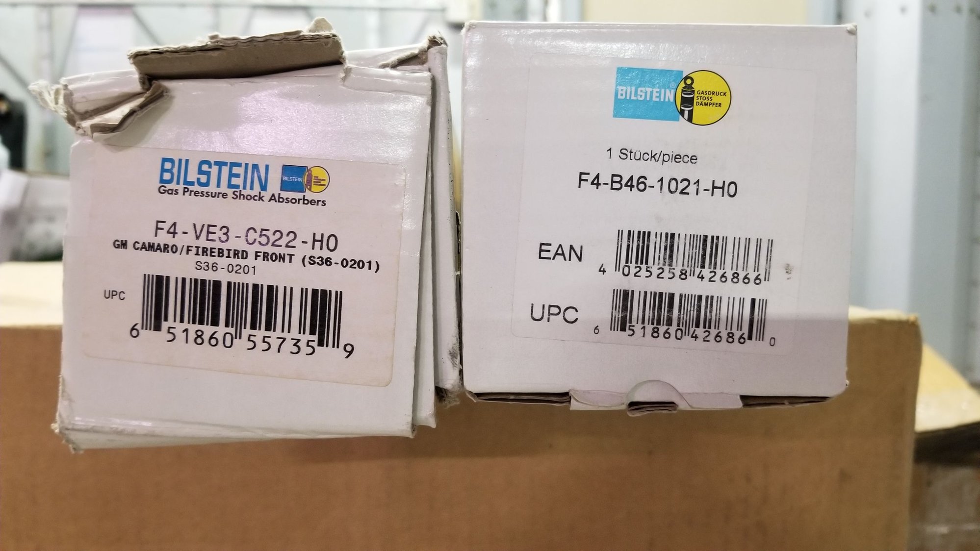

Here are the boxes for Bilstein rear shocks for lowered 3rdgens (right) and front struts (left), both of which are apparently discontinued, but maybe somebody can still find them in stock somewhere.
Old Jun 6, 2024 | 08:00 PM
chazman's Avatar
Posts: 9,947
Likes: 644
From: Chicagoland
Transmission: World Class T-5
Axle/Gears: BW 3.45
Re: Best shocks and struts for 87 TA with WS6
Originally Posted by LAFireboyd
Your IROCs have them, don't they? Were they on all 85-90 IROCs, or just the earlier years? That 11-mile 1985 IROC shows them in several pictures in its ad.
That was a big promotional campaign, the new 1985 IROC having race-inspired Bilstein rear shocks, "Delco-Bilstein," so, of course, I had to put a set on my 1983 Z28 HO in late 1984.
I hadn't realized until this thread that Bilstein had rolled back its product line for 3rdgens. They offered struts and two different shocks: one shock for stock ride height, and one shock for lowered cars. I purchased the struts and for-lowered shocks a while back and finally put them on my Formula last year. They aren't as stiff as the KYBs I'd had on since the mid-90s. But those 30-year-old KYBs are still solid and strong, definitely well-made.
I thought I still had the empty Bilstein boxes with the part numbers, but I can't find them. Pretty sure I have pictures on my laptop, so if I find them, then I'll post one. Who knows? The lowered part number might still be available somewhere on the net.
Yes, on all the IROCs. They started to be replaced with "equivalent" AC Delcos sometime in '89. My black G92 has the black Delcos and my '89 'vert has the Bilsteins. I've also seen the Bilsteins on '90 IROCs so I'm not sure how GM decided what gets what.

i have the kyb adjustables front and rear on my 86ws6 and have no real complaints. i have them on the fourth setting and have been meaning to soften them up a notch or two. they’re definitely stiff on their lower settings. they serve their purpose well for the price.
thats cool bilstein rebuilds original shocks/struts. i would have hung onto mine had i known
