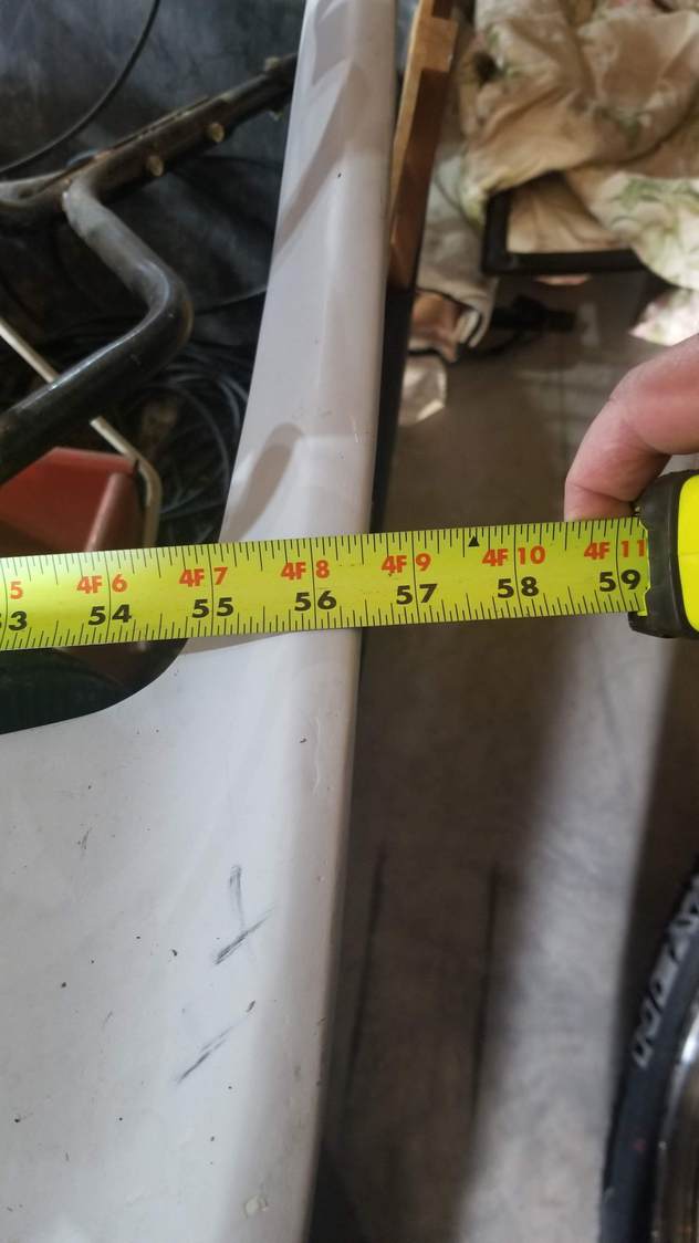

Old thread but thought bringing it back might help me get and answer.
My friend found this wing on ebay for a 1988 GTA he was working on. The body shop tried to install it but said it wouldn't fit (too narrow I think).
It "looks" the same. My 1989 Formula needs a new wing and I was thinking about trying another body shop to see if they can get it to work on mine.
Without taking my old spoiler off its hard to tell. I did measure the top and its showing narrower at the spot I checked.
We were also wondering if maybe other years had different sizes of this spoiler style or were they all the same?
Any help is appreciated.

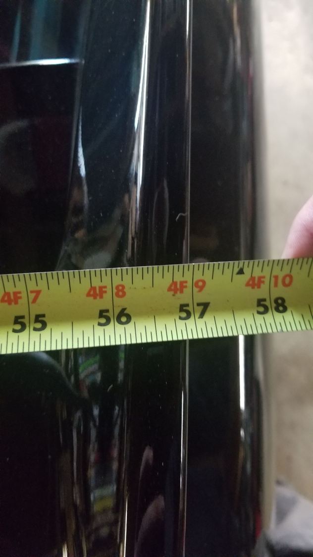

I bought a showcar robs and took it to a body shop. Said it would be thousands to make it right. So I bought a hawks. It was an inch narrow and 1/2 inch short from the origional. I measured the showcar. Right on. I spent the hours fixing what was lacking.
if you can live with it being smaller do hawks.. They're finish is awesome.. I wasnt compromising.
