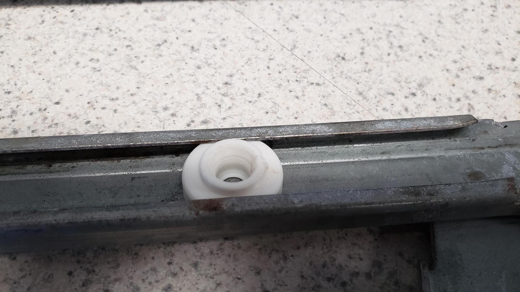

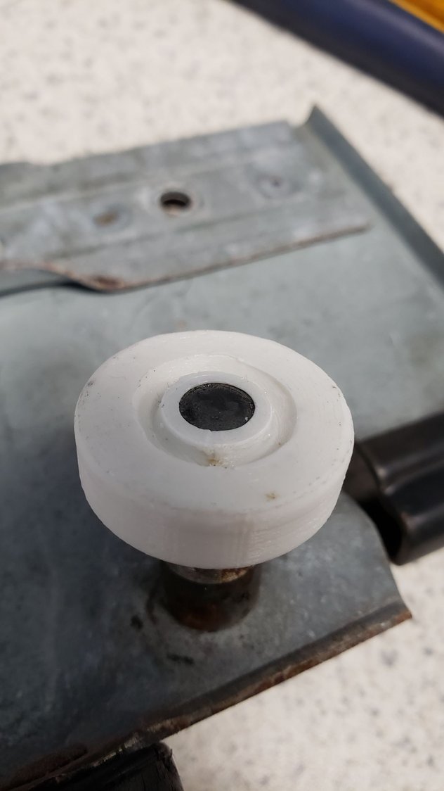

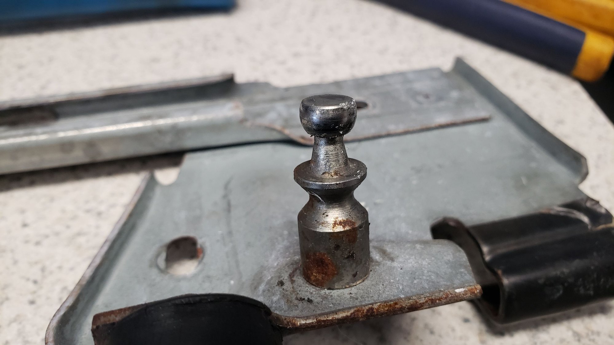

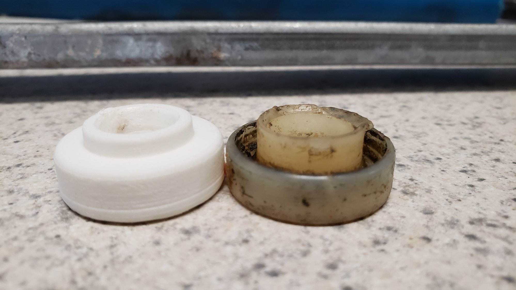

Seeing if there's any interest in the below - replacement window sash channel/regulator rollers, that pop onto the stock OEM studs, and swivel, and all that good stuff. Made from ABS plastic, can't speak to longevity but they do fit and function. If there's anyone actually in need, I'll throw a post up in the classified-land (I'd be @ $0.75/each, plus shipping), otherwise I may just throw the .stl on Thingiverse.

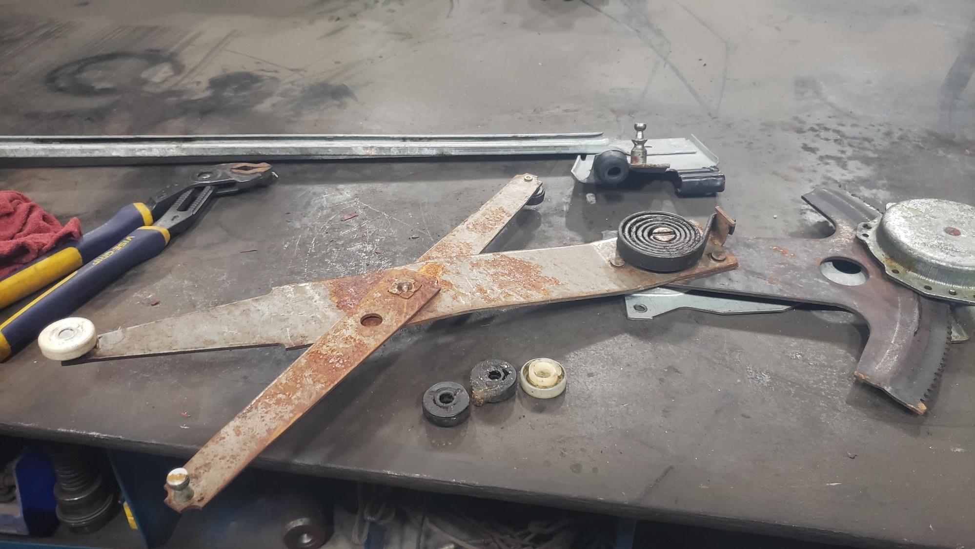

@topduarte Looks like 4-per-door, by my count. Three on the regulator assembly, one on the sash channel that attaches to the window. Regulator pictured is out of an '89 Firebird, Sash Channel was an '88. Appear to be identical, but one black plastic, the other the off-white. 3D Printed piece fit on both (in photo on the regulator).

Apologies for the delay - never saw the notification about a message in here. I did end up making these. In my tests, they fit and functioned - when released into the wild and sold, however, they were not well received. Had a complaint about them breaking, and one that they didn't fit, so I opted to just take them down completely. If you want to try them out, I've got a decent amount sitting around, would be happy to send them to you on my dollar, all I ask is that you let me know if/where there are any issues with them. Send me a PM.
