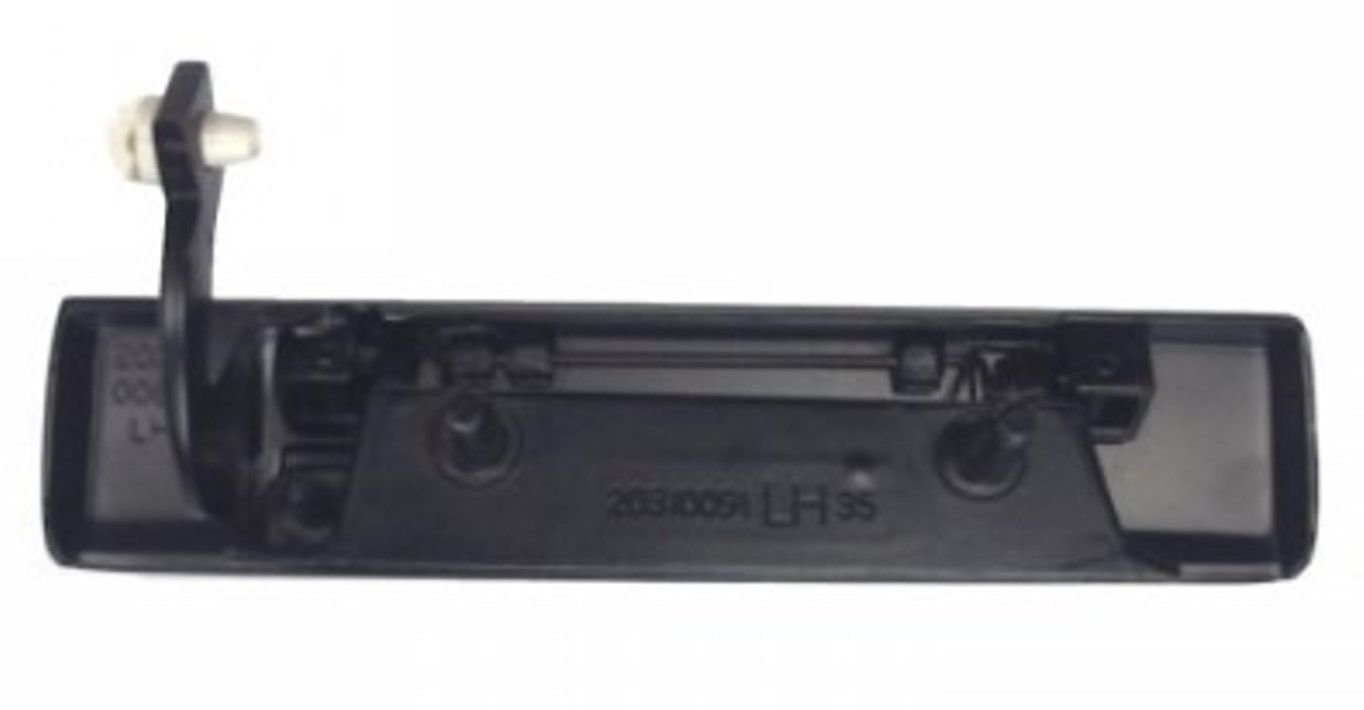

My door handle seems to have what i think is a spring hanging down. Can I just put it back or is my handle toast? Thanks

I've not yet had the misfortune of a broken handle on the T/A, but we had a corporate A-body wagon with the same handles. Broke in the same manner as yours, I believe. If I'm right, you will find that the pot metal tab that captures the spring on the back handle has broken off. There's no way to fix it that I know of (given the pot metal material the handle is made from).
Hope I'm wrong.

I'm surprised there isn't more on this when searching the forum. But there's not much.
I found, expanded, and added arrows to this photo I found here, to try and show the staked (as I recall) pot metal tabs that held that spring down on the handle.
Photo from this thread...
https://www.thirdgen.org/forums/body...tml#post805320
There's also this custom option.
https://www.thirdgen.org/forums/body...r-handles.html

Ah, gt4373 beat me to it. And with a better photo!

What happens is those cheesy, flimsy little tab/s break off and then the spring falls down as shown above. If those are OE handles, i would just JB weld the end back on. There is probably one of the two tabs still there to help locate the end in place. I fixed mine that way years ago. As mentioned, repros are even bigger POS's.
