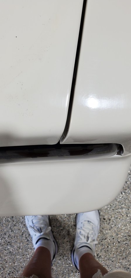

Hatch Alignment 101 Complete Repair
Well it's been a while since posting. Been busy for a year or two! Anyway, I done the complete hatch alignment on Reba from hinge adjustment to total removal of deck and reseal with Urathane and primer. Hatch had moved rearward close to 1/2" on both sides. There was evidence that the hatch slipped back over the last 34 years! Its perfect now. Happy now.

Take two! #464! getting the alignment treatment! It was off also.
Where was the evidence of slippage? the hinges slipped on the glass, or the body of the car, or the glass stayed put and the rear panel slipped? going to do mine eventually.....
Thanks for the info!
Old Jul 22, 2022 | 08:55 AM
Bob88GTA's Avatar
Joined: Apr 2000
Posts: 3,938
Likes: 99
From: Huntsville AL
Car: 88GTA
Engine: 5.7TPI
Re: Hatch Alignment 101 Complete Repair
Panel to glass. Hinge to glass was fine. Hinge to body nothing to mention.
