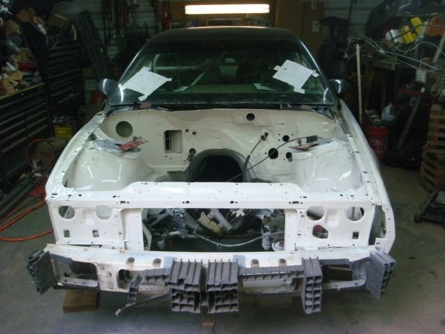

Duplicating the low gloss thin looking paint underhood question
Was wondering if anyone has a process for duplicating the low gloss thin looking under hood factory paint ? I've stripped, primed and repainted my entire front dog house with single stage exterior gloss paint but its so glossy that it bothers me on this particular car and thinking about sanding and repainting it. The factory paint I've seen on other 88 Irocs under the hood looks almost flat body color and thin like there wasnt good coverage. With this car having the history that it does I'm second guessing the gloss finish. Any tips? Still have to spray the k member and such but figured before I did that I better decide if I am respraying or not.

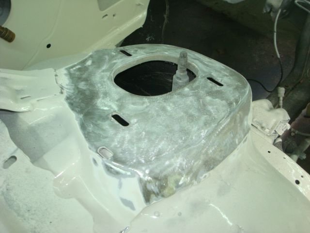

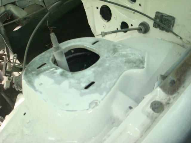

No turning back now as I pulled the strut mounts off and started taking it back to bare metal.
Not taking everything
to bare metal again but I have a lot of material on it in areas and dont want it to crack later with more on top. I had 2 good un-thinned coats of gray SPI epoxy, then 2 more good thick coats of un-thinned SPI white epoxy and the 3-4 coats of white single stage urethane. Better to be safe than sorry at this point. Now that I have it indoors I pulled the hood to make it easier to work on.

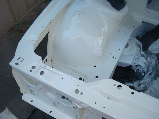

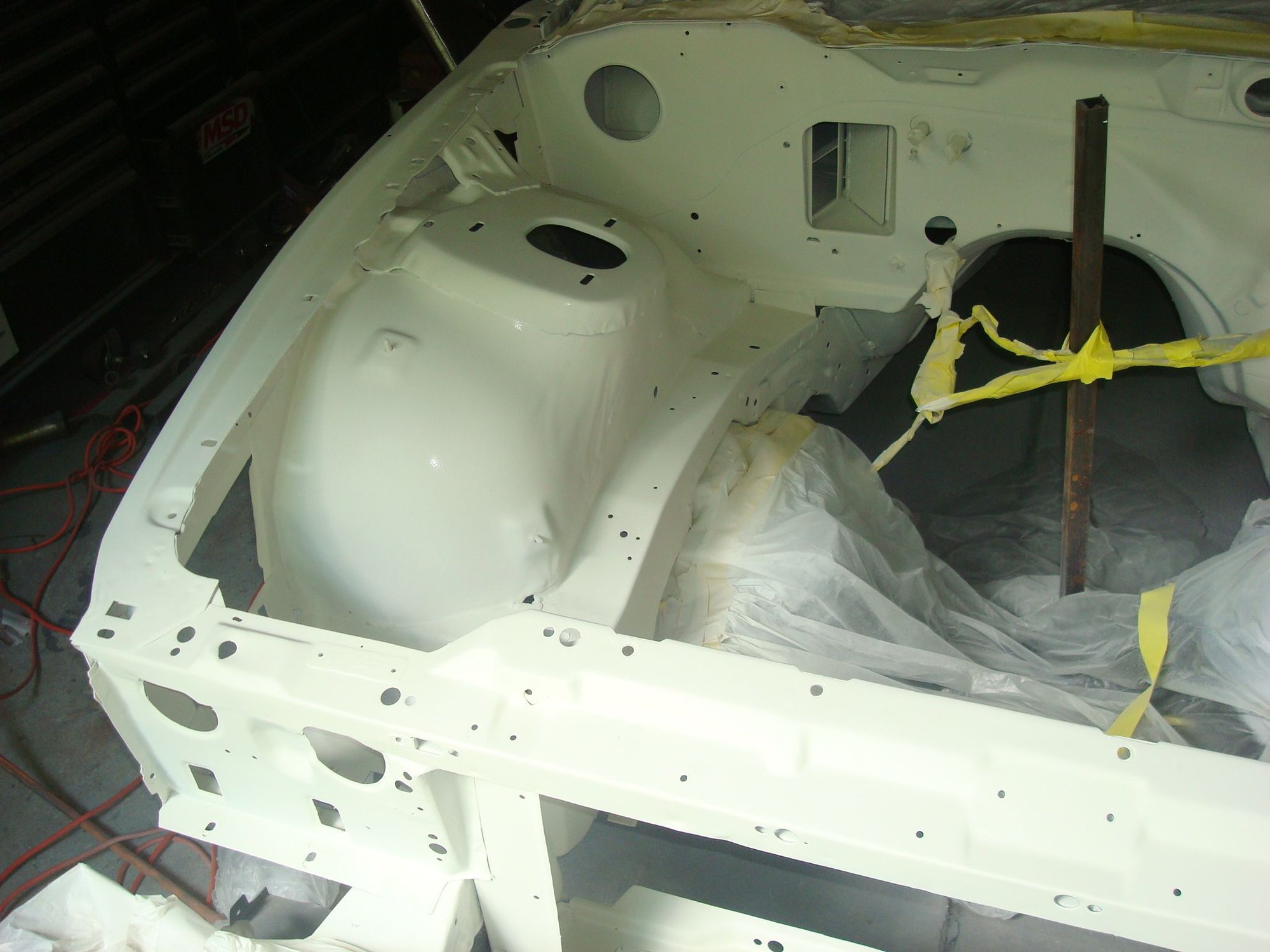

Seems like unchartertered area as I've talked to several paint reps and they all are saying you cant just spray base and leave it. I've tried to explain what I'm trying to accomplish but most either havent noticed or dont fully understand. I'm afraid using a matte clear will still give it too "thick" of a look as well single stage with a flattening agent.
I have it in gray epoxy primer now after stripping everything back to bare metal. I normally do not thin my epoxy however did this time by 20 percent, raised my gun pressure and sprayed it faster than I normally do. It has proper coverage but also has the thin flat look still so if I can get the base to lay down like the epoxy did I'll be tickled.
At this point barring a better idea I'm just going to add 1 ounce of hardener to the base and go for it.

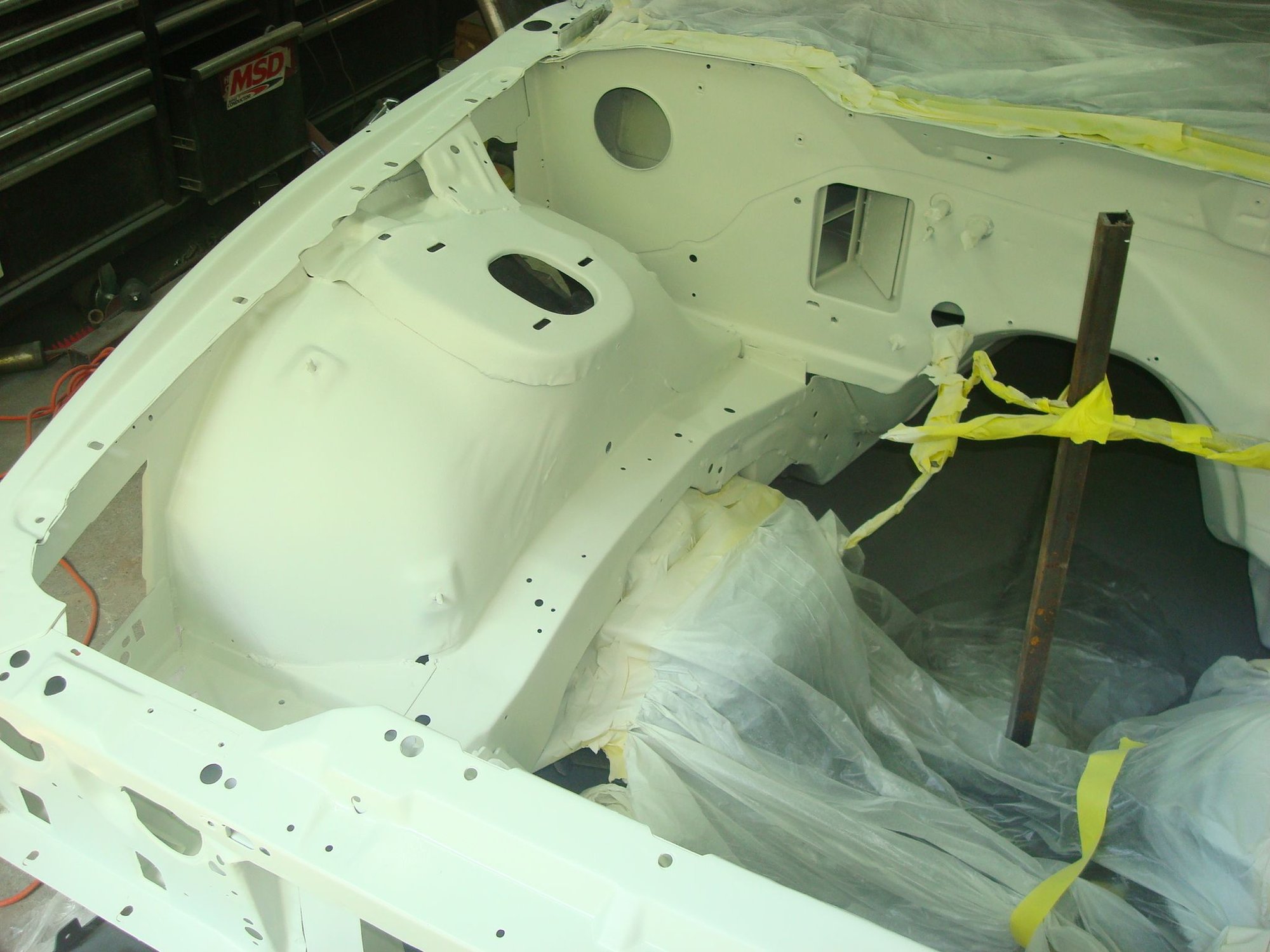

I just sprayed the white base with 1 oz per quart of hardener mixed in. I have a 24 hour window now if I decide to top coat it but want to see how it flashes out and dries. It looks to me at this point it lacks a very small amount of "sheen" compared to the reference pictures I have so I may end up test spraying a lower part of it with a matte clear first thing in the morning if so.
It's close but to me still a touch off.
