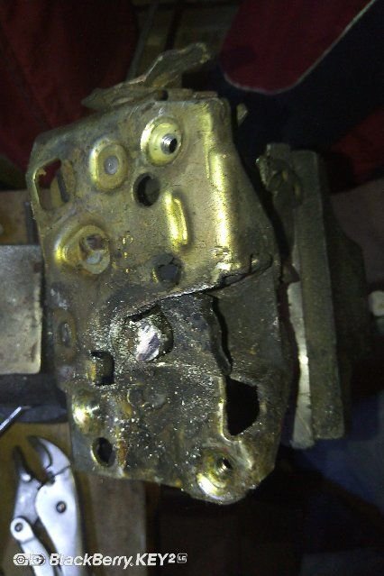

I wish that I had thought of this the last time I was faced with a locked driver door on an 89 IROC. I had access to the interior (the panel was off) but could not get the door to unlock despite soaking it with PB blaster and pressing on the lever. that time I gave up and cut off the striker pin from the out side, but it left the door badly damaged. This time I faced the same situation of a stuck driver door with an 86 Trans Am which I am making into a Knight Rider KITT car. I could not get the lock to open after several days of trying. So I measured the distance to the striker pin from the passenger side which was about 2 1/4" from the end. I used a spring loaded center punch to make a few marks in a vertical line and then drilled them out and followed up with a close quarter hacksaw. I widened the gap enough to get my sawzall blade in there and was able to cut the striker pin off easily. It will be easier to fix the cut I made and I wont have to repair or replace the door.

Striker pin still in lock. Will be able to remove it more easily now.
Putting the lock into a gallon of carburetor cleaner for a few days to help get all of the old grease and gunk off of it before lubricating it well and reattaching it to the door.
