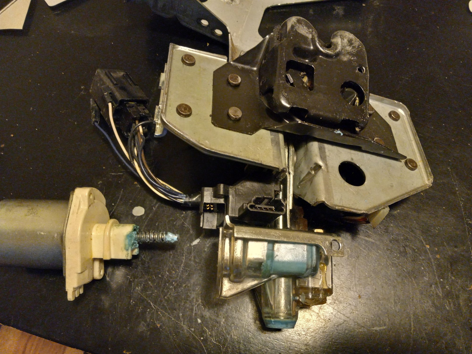

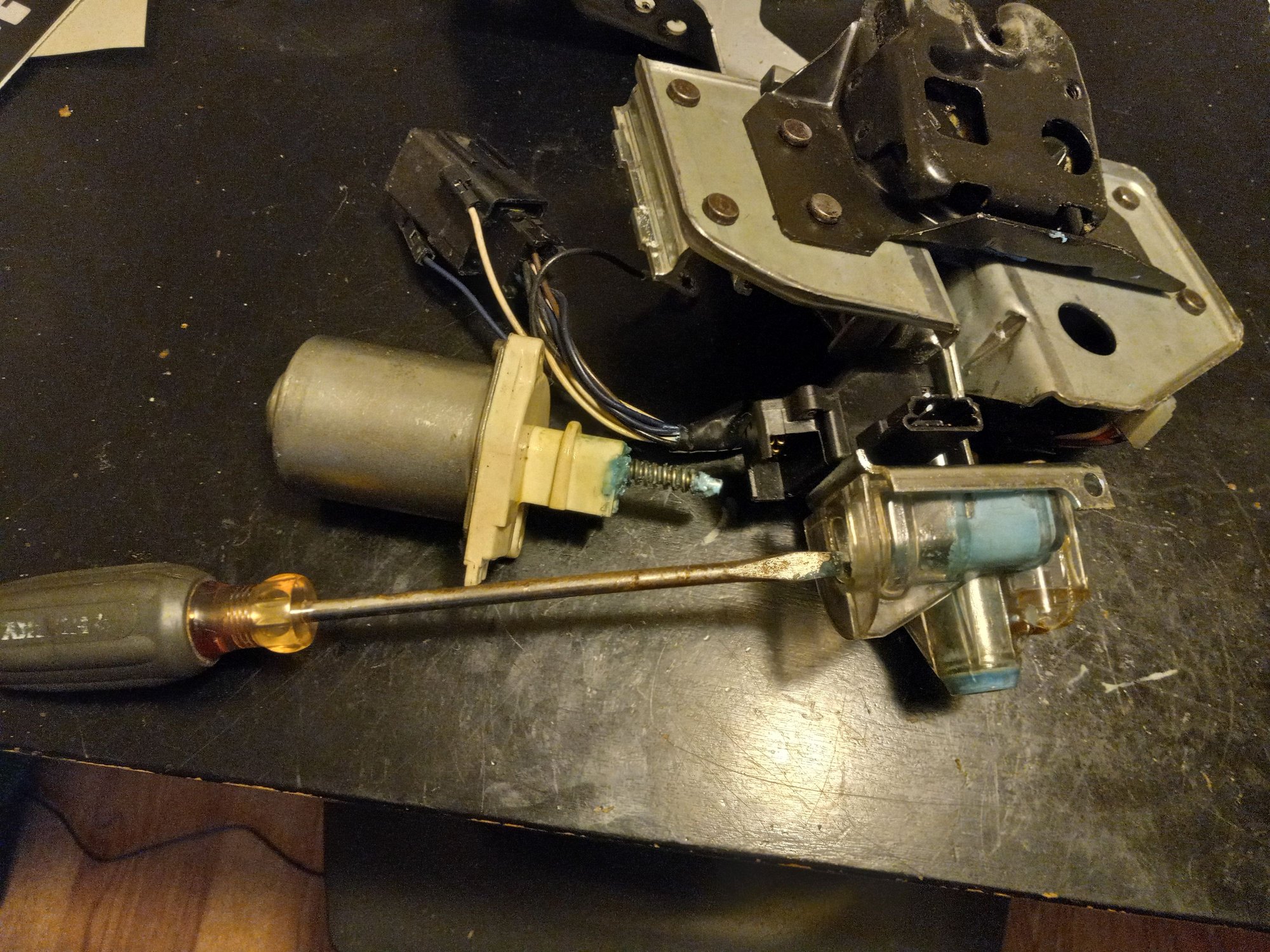

I have an 88 GTA. A few days ago I noticed about 2 inches of water in the hatch after a rainstorm. I figured the hatch wasn't sealed shut. I popped the hatch open and vacuumed out the water. At that point, the motor assembly wouldn't lower and the hatch stayed in the UP position. I could hear the motor buzzing, but the hatch wouldn't lower Well I took the whole unit apart and found that the nylon gear that lowers/raises the shaft is worn out. Since I was in there, I ordered a replacement housing, motor, and gear. But since I had it apart and was looking at it, I figured this could work as a manual override. I put the entire mechanism back together with the exception of the motor (housing back in place, along with the black plastic up/down switch), and used a flatblade screwdriver in the shaft where the motor would normally go and manually moved the gear, lowering/raising the shaft. Right now this is at the lowered position. I left the plastic switch in so that I'd hear the click and know when to stop. Theoretically, I'd think that if I bolted this back in to the car completely reassembled, with the exception of the motor, the latch would be ready for the hatch to be lowered down and lock in place as a manual lock?
