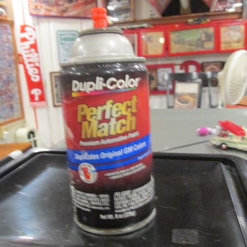

used this awhile back and had good results it's color coded to match your color it held up still to today,not too shiny matches very very good.Mines is White WA 8554 got it from Pep Boys
