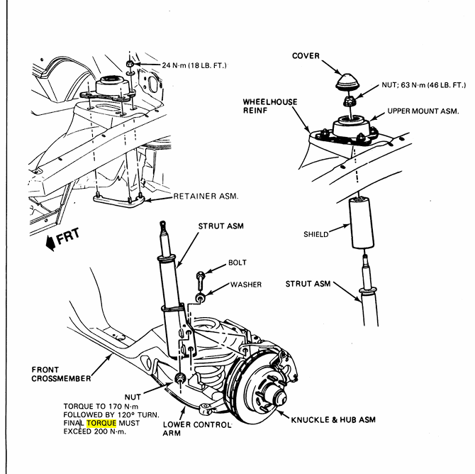

here you go here's a free copy of the service manual : https://austinthirdgen.org/wp-conten...ICE-MANUAL.pdf
Old Feb 26, 2025 | 08:05 AM
lolodenimes's Avatar
Joined: Jul 2024
Posts: 45
Re: Torque specs
Wait 200 n.m really? That's the limit of my torque wrench
And thx for this one, it's more complete than the one i've post
