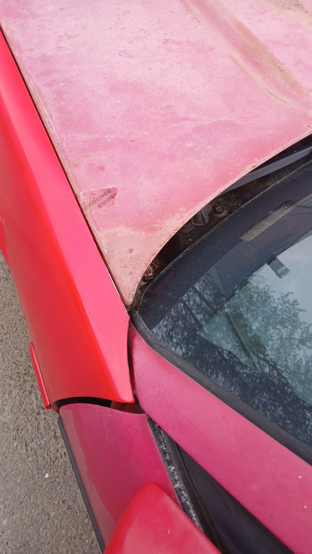

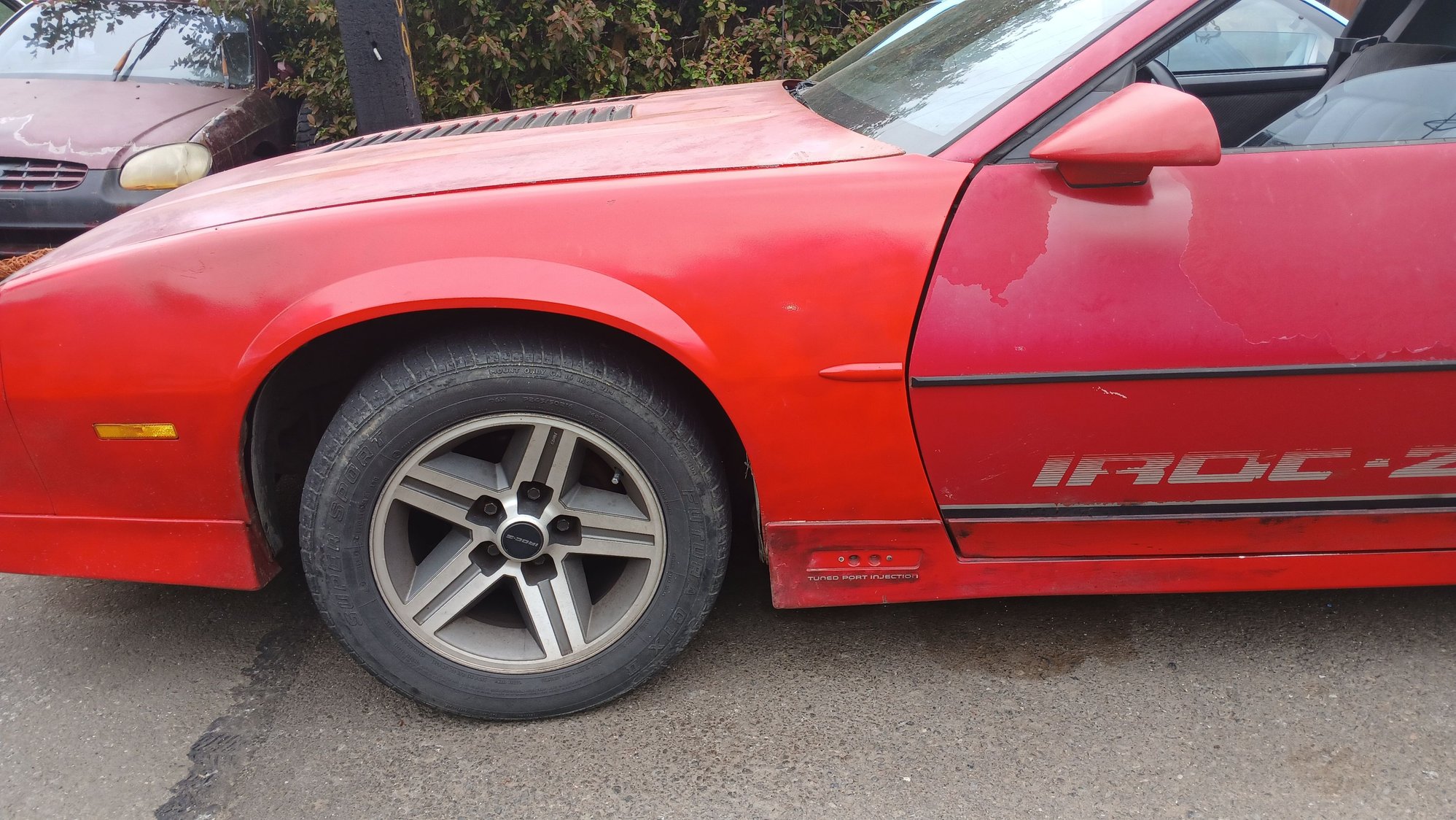

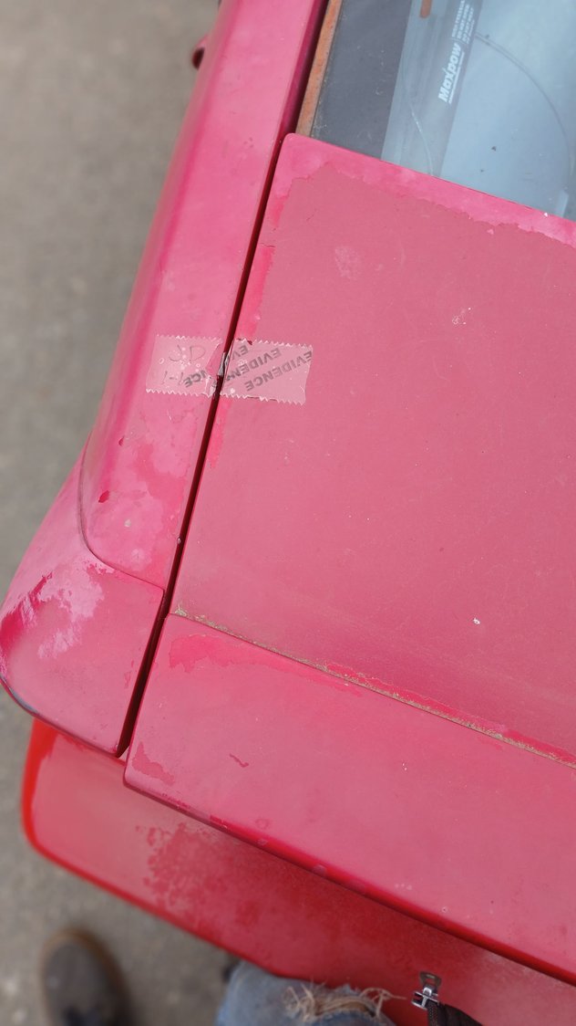

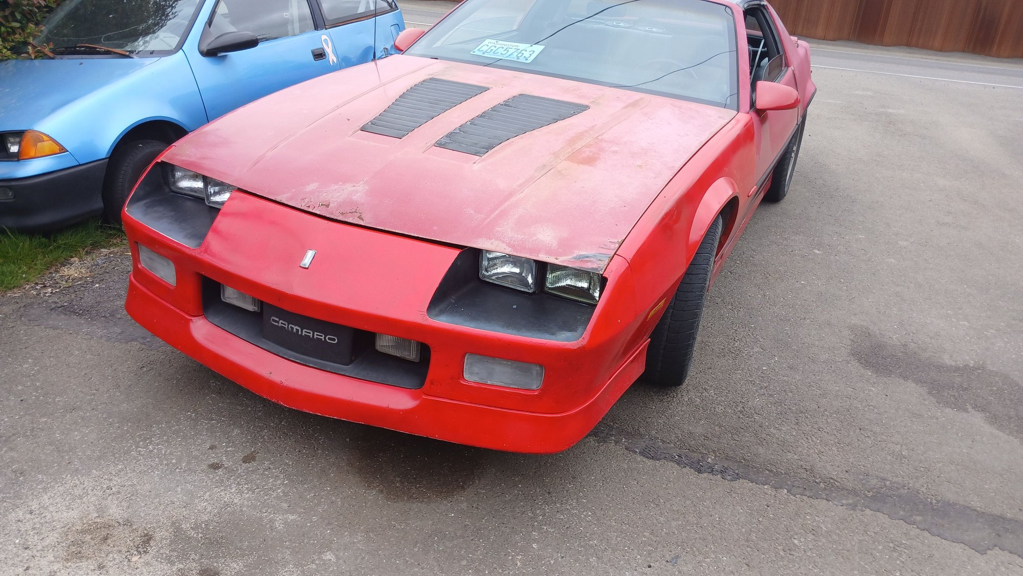

The front bumper looks like it needs some fender washers to level that out, the door probs needs the hinges refreshed and the hatch just needs to be a little loose and gently push straight on it and it should move no problem

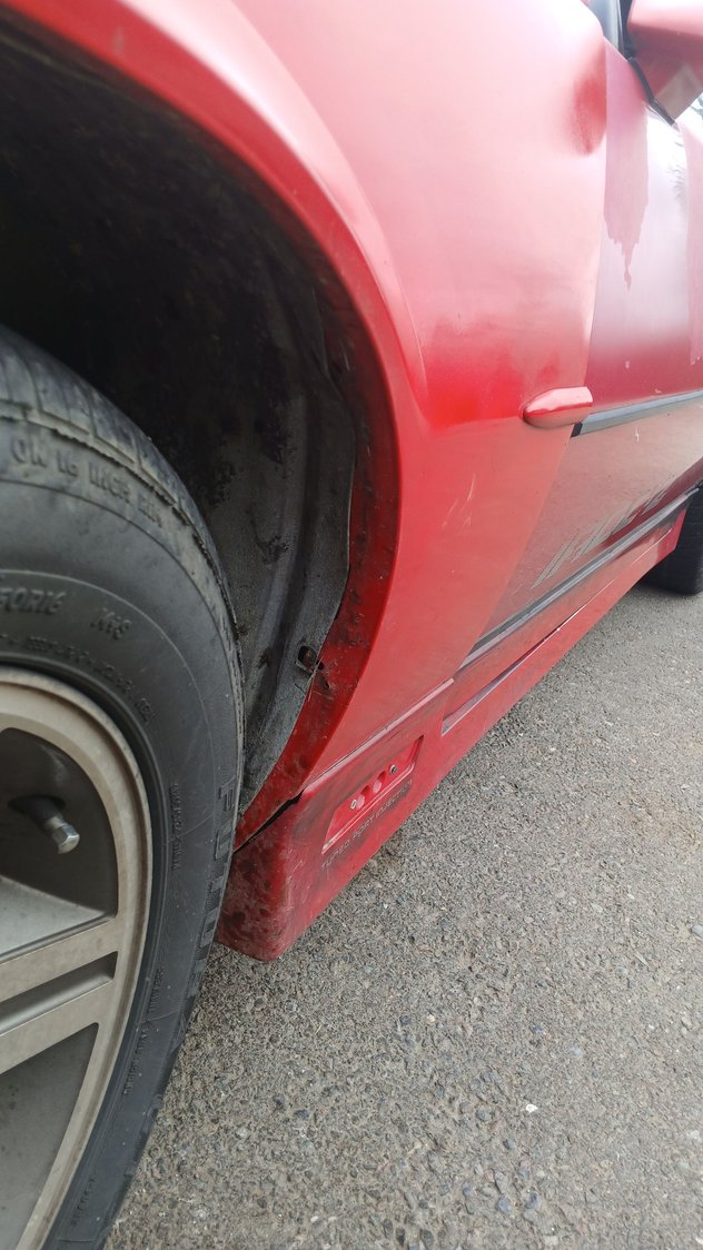

I'm willing to bet that the fender on the bottom has been smashed by a jack or a jack stand / hoist. Chexk to see that its nice and straight and not folded up.
The hatch......... Id be afraid since youd prolly need to repalce the hinges or reseat the panel on the glasssss.....

Spot on with the hatch. The struts push on the hatch over time and being that its only a compression fitting with the way their mounted they all over time start pushing towards the rear of the car.
