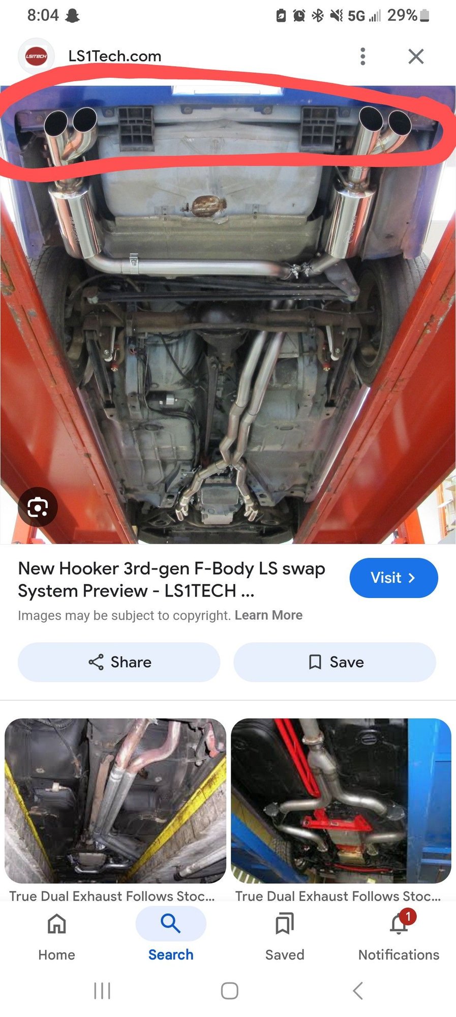

No it's that metal panel part the goes across, the plastic clips for the bumper cover clip into it

Oh I see. Its not a bolt in part. You'll have to harvest one out of another car and stitch it in.

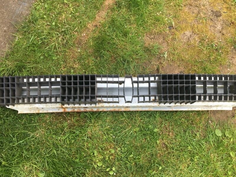

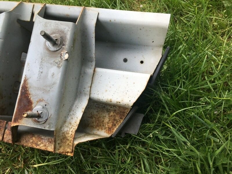

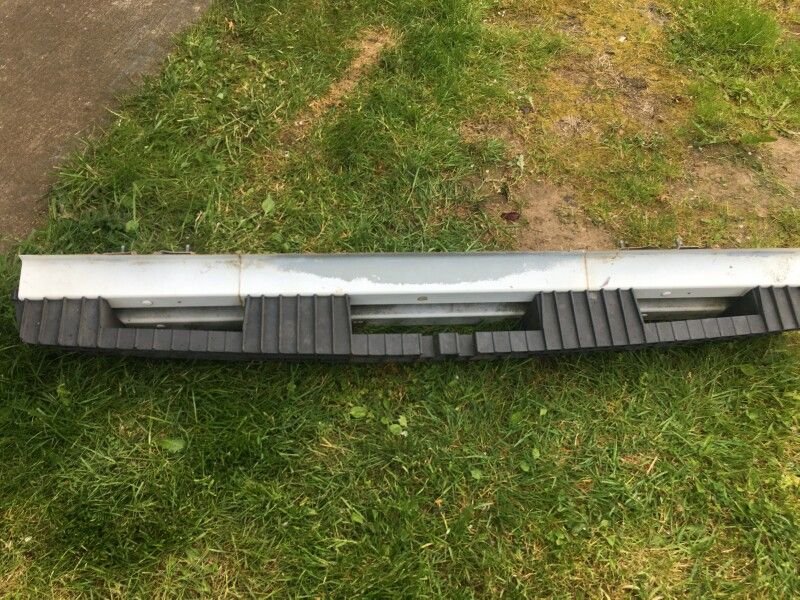

These are pictures of the donor part that I got. I had to remove the black crush plastic by drilling out the rivets to have the bar sandblasted and powder coated. I put the crush plastic back on using stainless steel machine screws with nylon locking nuts. Kind of a pain but can be done.

This bar is your only real protection if somebody hits you from behind. That is why it is heavy gauge steel with the plastic crush piece.

Here is a picture of the mounting bolts. They are a set of 4 on each side in a square formation. Notice the special washers. They "lock" the carriage bolts in place so the heads don't turn when you tighten or loosen the nuts. Mine were rusted and broke so the bolts just spun. That is why I had to cut mine off. I had to cut the bar apart to get at the bolts. I was able to get new washers.
