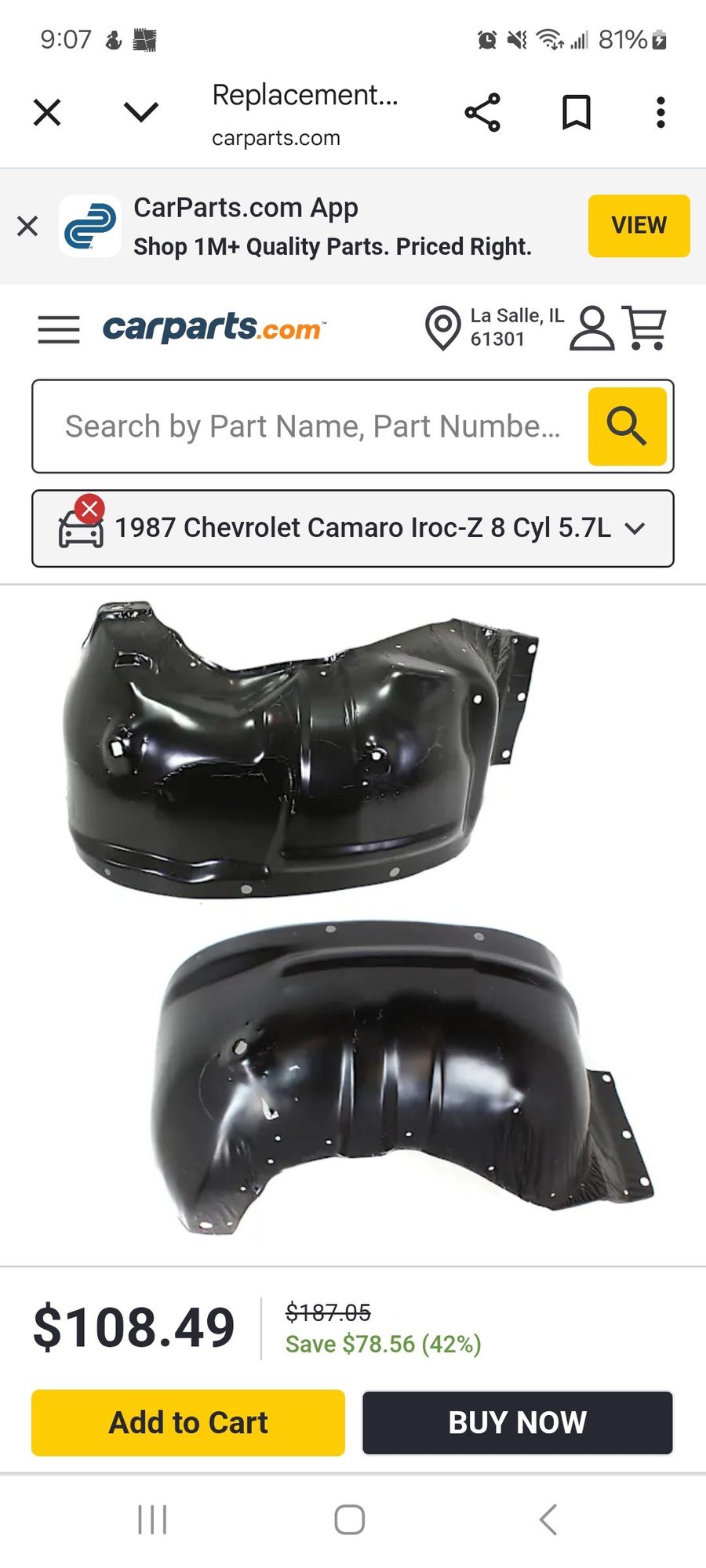

This piece.

It's the wheel well housing that the windshield reservoir sits on. The bottom half is gone.

Yeah, that's a pretty common spot. You'll need to find good used panels or just bring it to someone who does that kind of body work. The area where the wheel well and firewall join is a difficult area to work on.

Sorry, I had thought you meant the rear wheelhouse. Your best bet is to find a donor car and cut out what you need.

Those are not available from any aftermarket supplier. There are probably a few NOS ones that have been tucked away somewhere and not for sale. Your options are going to be either make patch panels, or cut one off of a donor car.
Those do rot away, but usually when they get that bad, there's a whole lot of other rust elsewhere. I would look very carefully at the rest of the car and evaluate what other rust/rot is present before you start down the road of this repair. Look carefully as the rot may not be obvious on the outside of the car. Front rockers, floorboard/toe boards, front wheelhouse, rear wheelhouses, firewall/cowl, bottom of quarters behind ground effects are all common spots that are hidden.

I got a donor one for my car. They are a pain to same from a donor, lots of spot welds.
