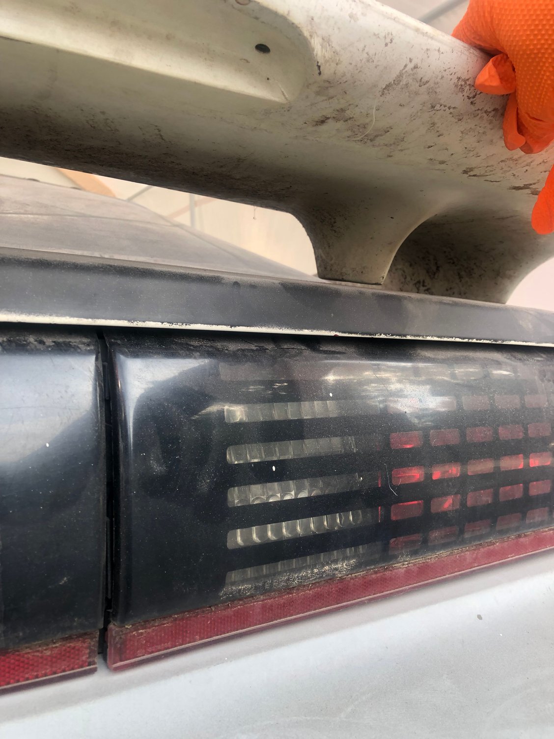

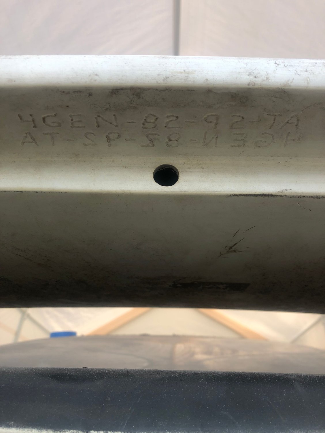

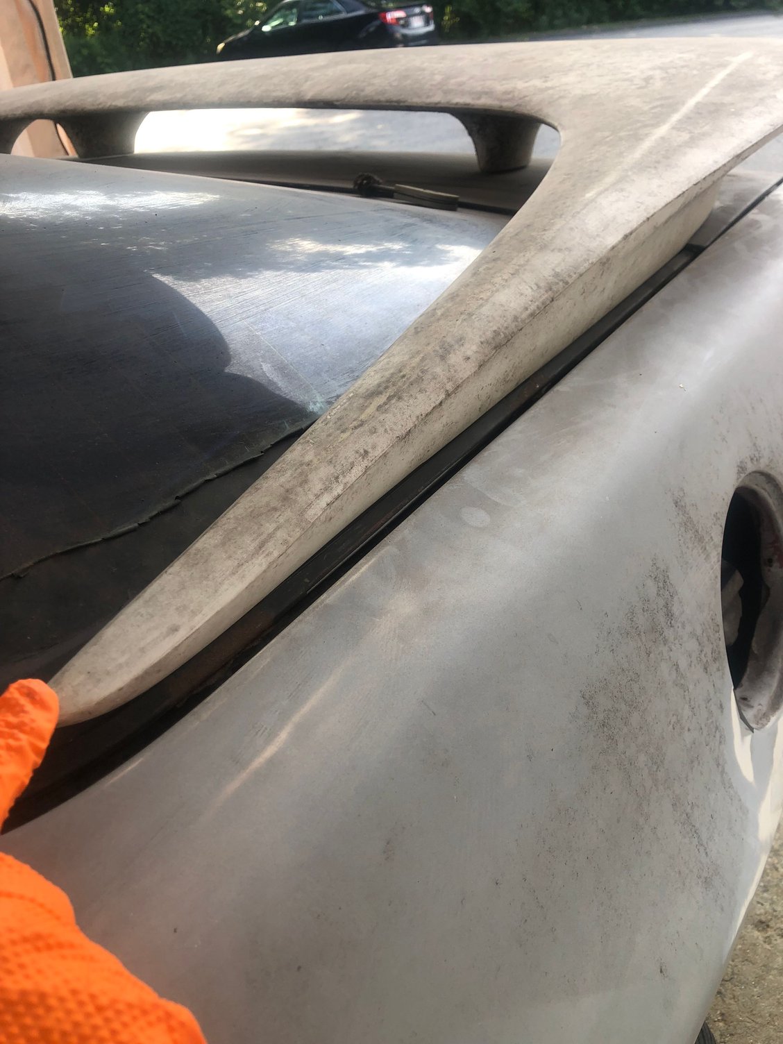

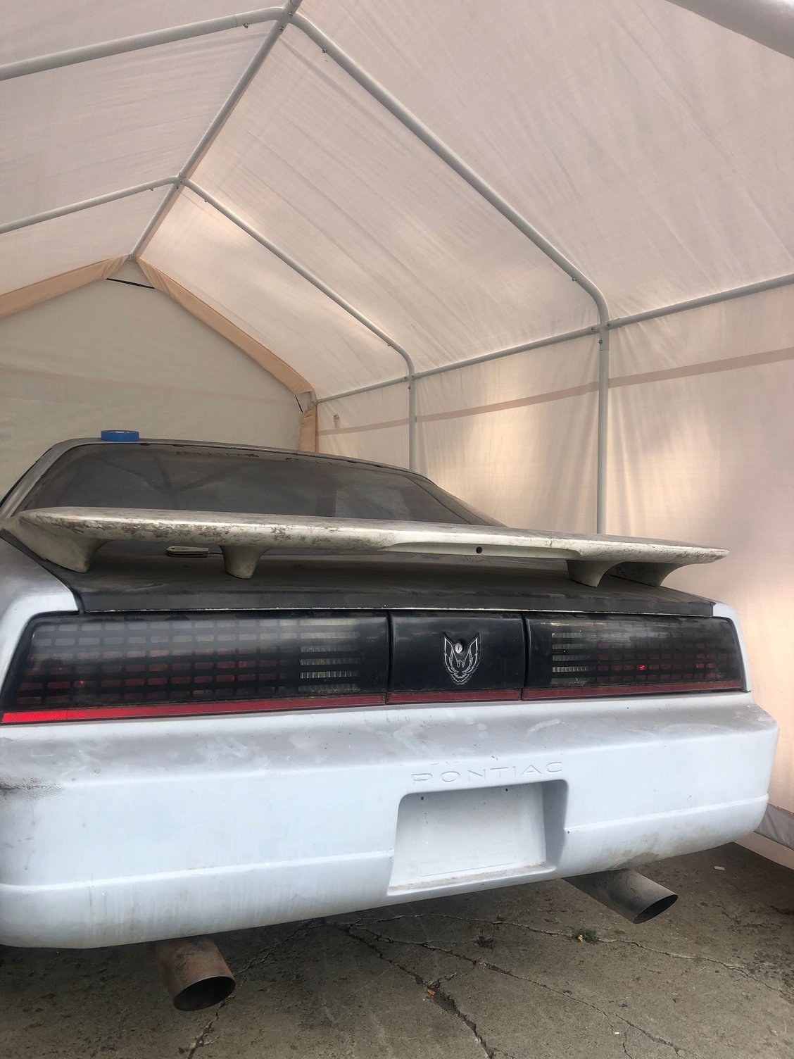

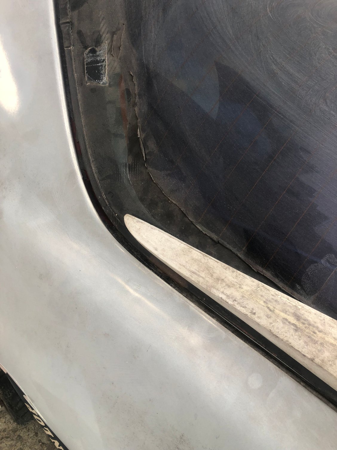

A lot of good pictures. That's what we needed to be able to see how that spoiler looks, instead of the few distant pictures that can be found online. Thanks.
Looks like the one made for 3rdgens. The "arms" or "spears," as they're sometimes called, are pointed like 3rdgen spoilers; actual 4thgen spoiler are "square." The two inner supports are made to reach the 3rdgen deck, unlike actual 4thgen spoilers that people have to modify to make them reach the deck on a 3rdgen. And the "missing" brake light is the type for the one made for 3rdgens. Kind of amateurish the way they carved the identification into the pocket for the brake light; maybe it was an early prototype. It should probably fit on the glass frame, not inside of the frame, because that's what it'll attach to, but that might just be the way you have it resting on the hatch, or maybe those arms will have to be pulled outward slightly to attach to the frame.
You could probably reach out to Hawk's to see if you can get some mounting hardware. Not sure where you'd get the brake light though, if you don't have it. Hawk's might be able to get one, but I kind of doubt they'd want to. Hardware might not be such a big deal to them, but a brake light probably would be.
What's the last picture showing? Is that showing how it hangs out over the decklid?
