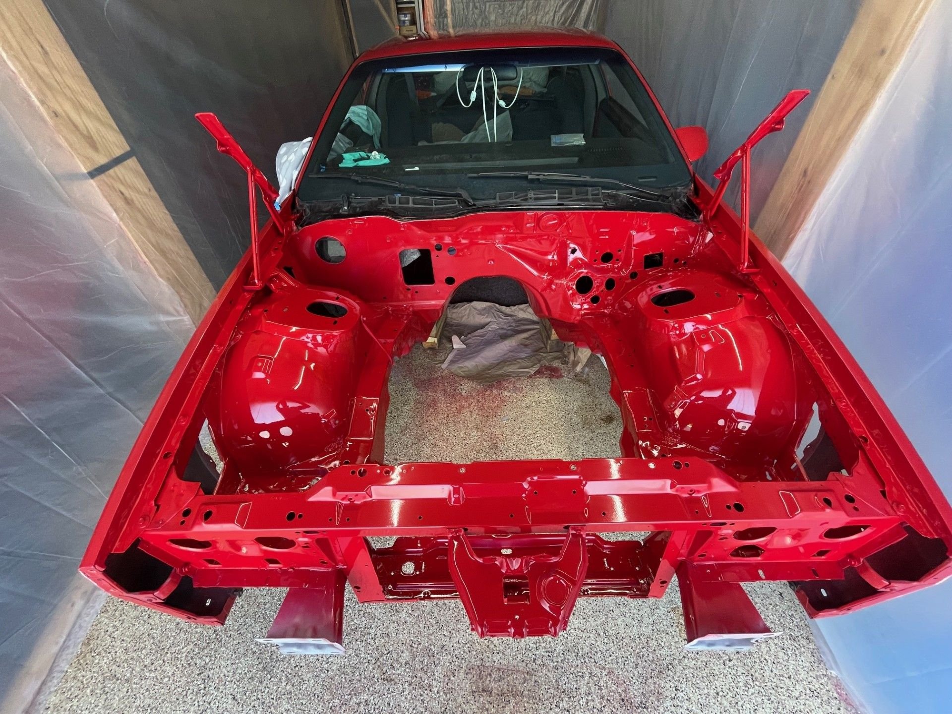

I know that the chemistry is different depending on brands. Yesterday, I shot PPG Shopline JB base coat in the engine bay of my 1987 IROC. The product information sheet said to only mix reducer with it.
The Shopline primer/sealer and the clear coat both required a hardener.
It was 95F and my clear coat hardener was
It was 95F and my clear coat hardener was "only good to 85F." Still, I worked fast and only had a few dry spots. I'm an amatuer painter and I think that if I had the "extra slow" hardener, the clear edges would've flowed or melted into the rest of the clear easier/better. Lots of gloss and I'm real happy with it.
I'm not a fan of red, but that's some nice work there!
To the OP, as others have said, it depends on the chemistry of the particular brand you're shooting, as well as atmospheric conditions. I had a painter screw up the paint/hardener ratio on the Imron we were shooting my '71 T/A with, and it literally took months for it to set. You might try simply painting a scrap piece of metal w/o the hardener to see how it works before you try to paint the car.
Thank you, Gene. It turned out good except for the dry spots on the clear coat that I'm pretty sure was because of the "slow" hardener only being good to 85F and the actual temperature was 95F. I needed the "ultra slow" hardener. Most of the dry spots are in areas that are hard to see and that's why I didn't notice them during painting. I paid a lot of attention to the areas that are very visible and they are nice and glossy.
That's a bummer on what happened to your Trans Am. Did it get fixed properly months later?
It just slowly.... set. After a month, or so, it was okay, save for the water spots that hit the hood when we sat it in the bed of my truck for the trip home at 0300 one humid morning. Once I got the car home, it went into the garage, so it was allowed to set in a dry garage. It was mostly race car-ish, so a 20-foot paint job was fine.
