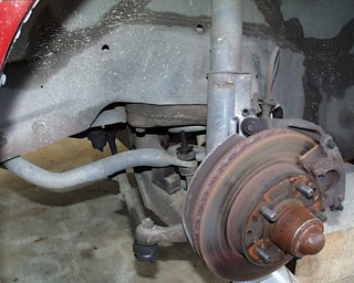

How do I know if I have 1le brakes on my 89 firebird. I don't have the sticker that was in the console. I have ws6 suspension and disc all the way around. 9bolt pbr rear brakes. I need to know because I'm rebulding/ upgrading my brakes. Any help would be great.

Your front will look similar to these.
Attached Thumbnails 1le ?????????-c-mike-s-garage

PBR rear brakes came standard (on rear disc cars) in '89-92, and from '93-97 also. Here's the non-1LE fronts:
Attached Thumbnails 1le ?????????-c-documents-settings-ebm8298

1LEs:

So then, when someone is talking about 1LE brakes for 89-92 cars they are talking about the front calipers? Standard front are the crappy cast iron ones, and 1LE's are aluminum's.
Yes, The 1LE claipers also use two pistons in stead of just one on the stock brakes and the disks that the 1LEs clamp onto are about an inch and a half bigger in diameter as well as thicker.
