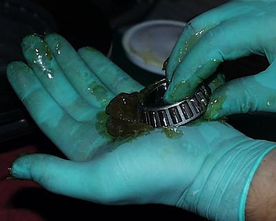

Just an FYI...also buy a box of latex surgical gloves, these keep your hands clean so you don't waste time washing them forever trying to get the grease off. They run about $3 for a 100 pr box. Works like a charm:

Attached Thumbnails Difficult of rotor install-c-documents-settings-ebm8298

Great tip !!!!!!!

there must not be a whole lot of everyday technicians posting on this matter. no offense meant, all a++ info just not the standard easier way most of us have been taught.
the best trick of them all you guys missed......
pull your outer wheel bearings, castle nuts, dust caps, and all that bs off..... then rethread your castle nut over the end of your spindle, not super tight just hand tight works fine. then lightly drag your rotor towards the edge of the spindle in a fairly quick manner. this knocks out the inner wheel seal, without a hammer and without a seal puller or any other bs..... much easier and faster.
also i tighten my wheel bearings a little differently. the way you mentioned is dead spot on correct (12 ft lbs then back off method) but, the first time i ever did this i was laughed at by my instructors in school as well as the last shop i worked at lol.....
hence its not rocket science to tighten a bearing to the correct measure.... spin the rotor rapidly with your hand, use a set of channel locks on the nut, move your channel locks in a tightening ray and a loosening ray for a few disk brake rotor revolutions (makes sure you are tight against your race without greese settling in between). then just tighten it until you can notice light resistance, (enough to make a noticable difference in drag). in other words the rotor doesn't have half as many free rotations when you spin it as fast as you can as before... then back it off to the nearest cotter key hole vuahla.
