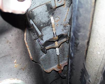

You must hold the long bolt in place as you loosen the nut that moves the adjuster bar forward and back. In the pic below, you can barely see that the forward end of the long bolt has machined flat side on it, I used a Crescent wrench there, but you must hold the long bolt still.
