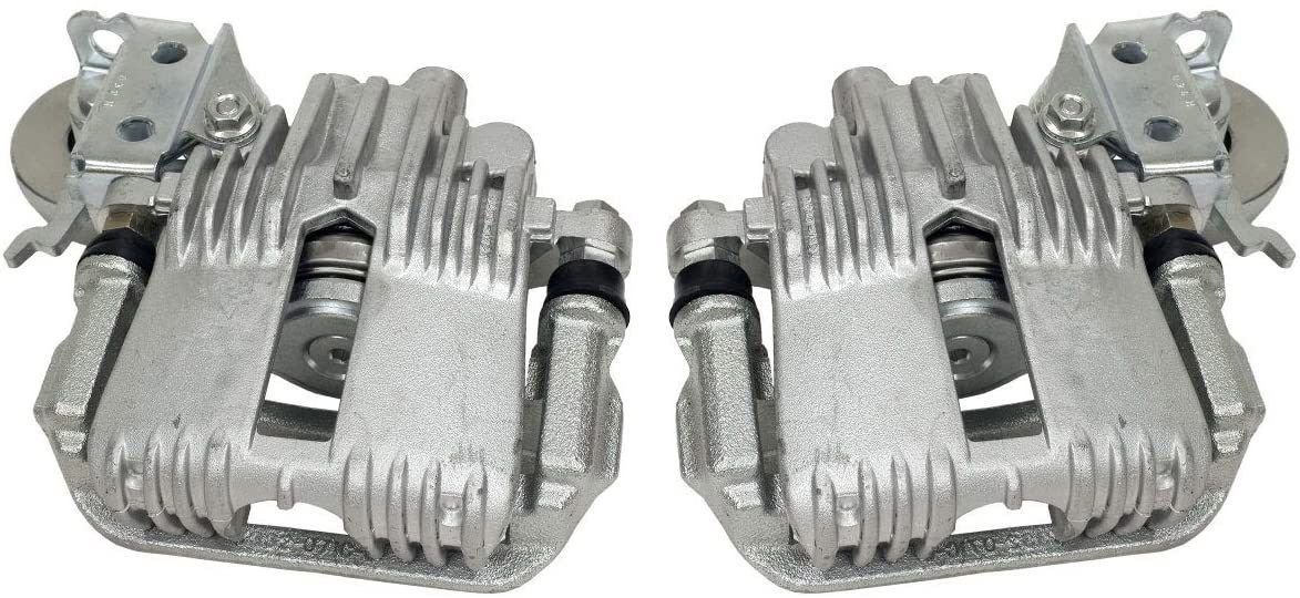

By all accounts the PBR caliper with the fins on it is a much better caliper than the replacement GM caliper that was the other caliper offered on rear disc optioned 3rd gens. But I hear ya....

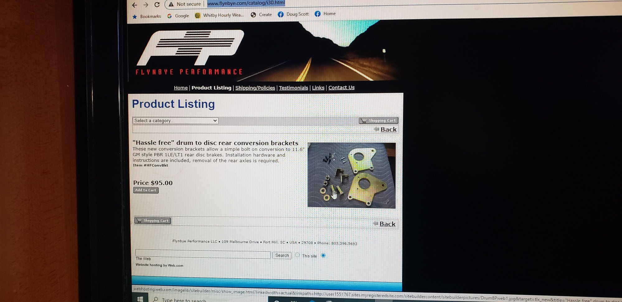

I just need this bracket

This is the kit. I called today and he is shipping it tomorrow
