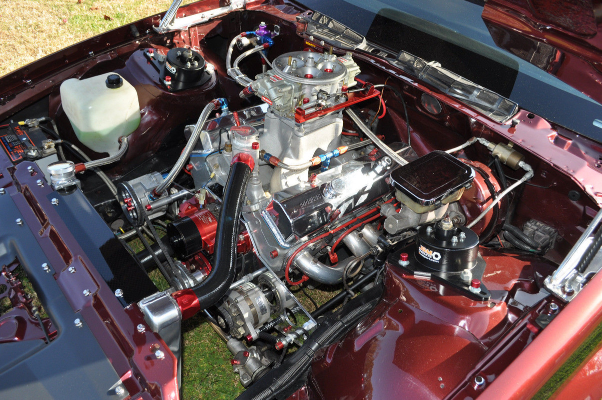

Any photos out there on an install? Mounting? Dont really want to screw the solinoid to the strut tower. Looking for clean install pics. Thanks

I found this pic in my photos..it shows 1 way..note line lock on firewall above brake booster.. I know I have better shots..ill look.. mine is on frame bolted to strut tower
this is the only one I have seen like this..
I did mine when the car was new..1991/92. I used a hurst Unit..but U had to Fab my Lines from scratch..
this way..its not bolted to the strut tower..
