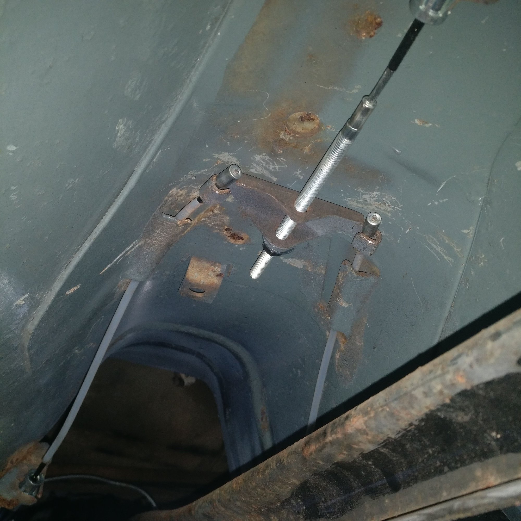

I can grab some pictures shortly if you want to ensure your setup is the same as mine

This is where the adjuster attaches to the cables
Cable holder

Perfect,thanks.Exactly what i needed to see. Looks like it is the right length with just enough slack. How many clicks upwards does your ebrake handle set at now?
