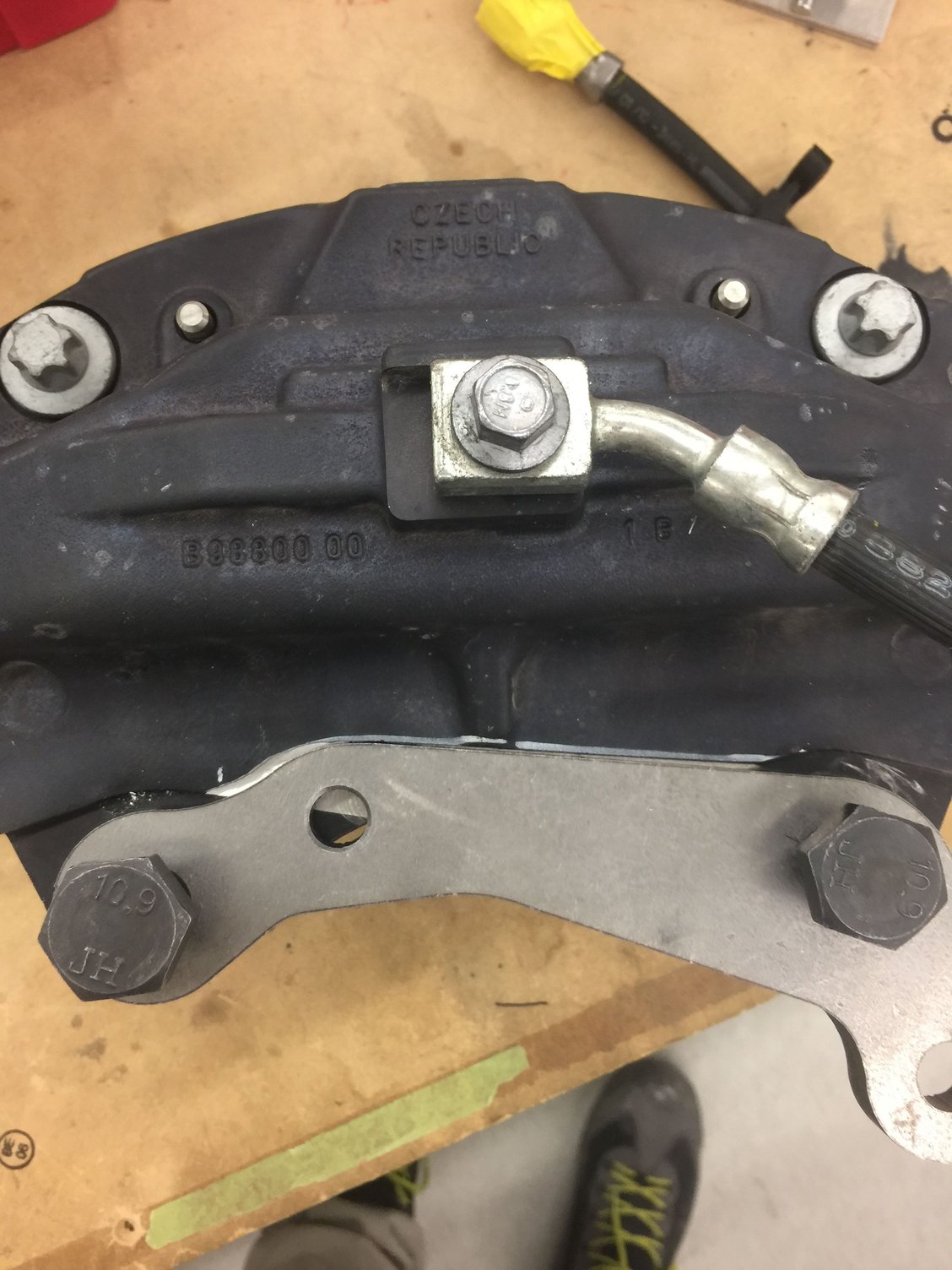

FYI: machining for the Gen 6 Calipers. I just layed the bracket over and traced the profile over with a sharpie, and machined to the line, did it at lunchtime!
Pre machine Note: OEM 6th Gen brake hose still installed. I had to use the banjo bolt from this hose on the Earls hose to work proper.
Post machine with bracket for comparison
Zinc chromate primer for corrosion protection
Perfect fit!
