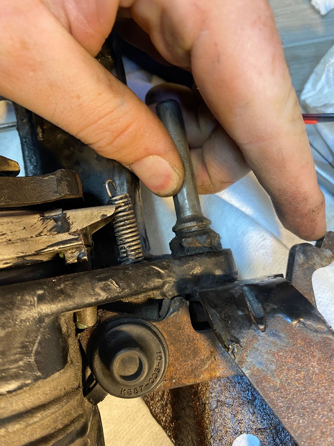

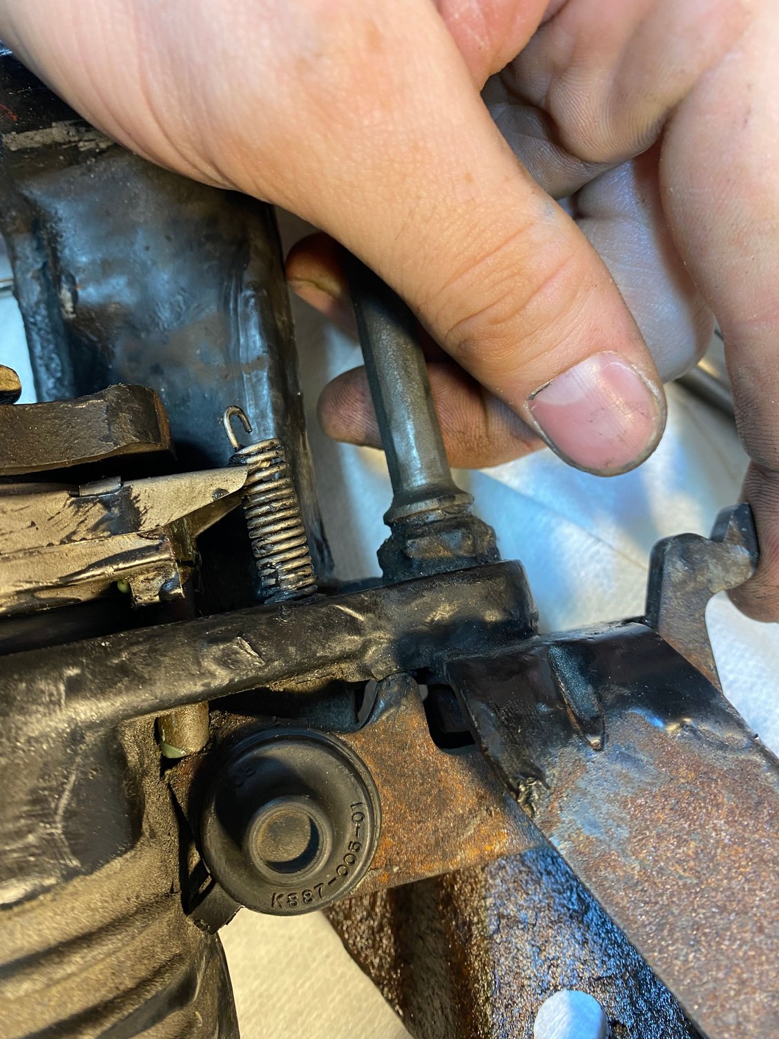

Did you adjust the set screw opposite the parking brake lever? If you don't know what I'm talking about, search for thirdgen.org pbr free travel on Google.
If you're going to replace the calipers, don't dilly-dally. The 89-92 PBR calipers aren't available anymore. The 93-97 calipers can't be far behind.

I havent adjust the st screw or looked for one.I was finding conflicting information that the newer lt1/pbr did not have these adjusters.I will have to check that is there and i can access it.Does anyone know what size allen head is needed?
As per those instructions to adjust it,turning counter clockwise will tighten up the slack but requires 2 people to do this correctly.Im by myself..its would be more leg work but by just adjusting the screw 1/4 turn at a time without pushing the brake pedal by sufficient enough to get the job done with trial and error?

*Quick update*
I found the adjustment screws on the calipers after scraping off paint and crud from the previous owner. They are a 3mm allen head for those wondering,but neither of them would budge after trying some heat and some lube. From what i see,they make 0 contact with the metal tab to apply pressure to the pad.I also think the pistons are no evenly moving in the bore. When I apply the brake pedal and try to move the rear wheels..they wont turn by hand.

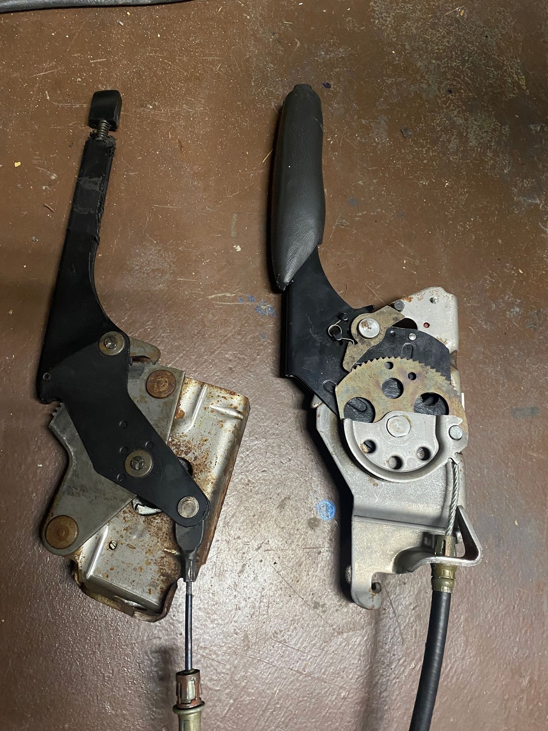

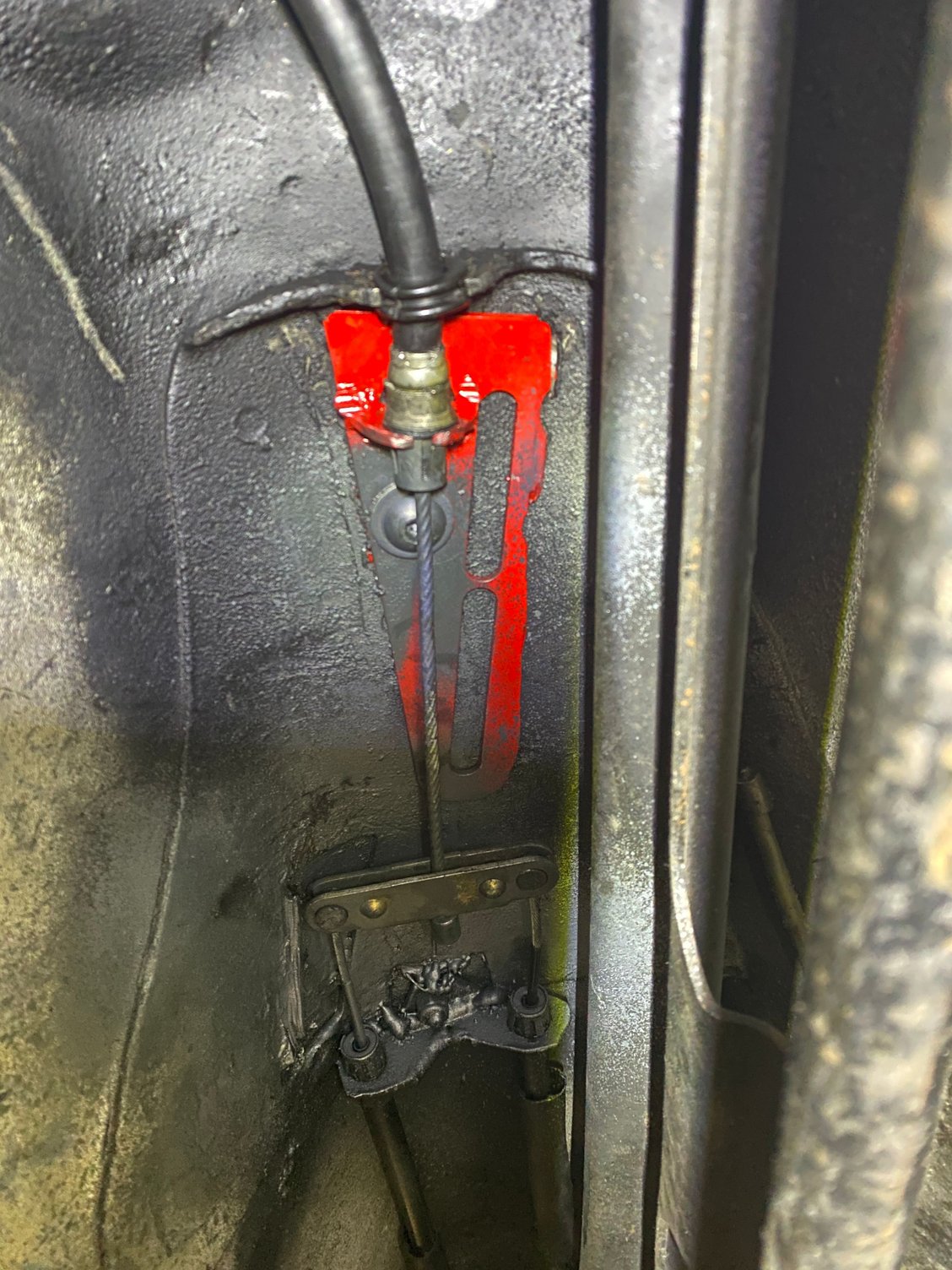

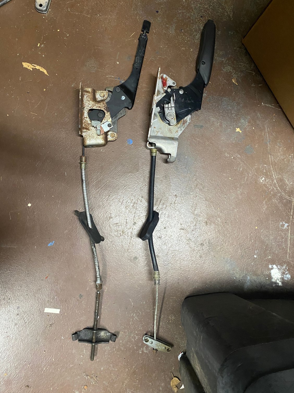

Just got my 4th gen swap completed in my 91 with drums. Rear end came out of a 94 Z28, so they are the LT1 style brakes. The E-Brake cables i used were World Parts #177602. The conduit length is 40.75" long.
Only modifications: to re-route the driver side cable between the sway bar and the axle tube (passenger side was tight but fit in the factory location), and i cut the spring on the passenger side between the conduit and the end that attaches to the brake to allow the cable to attach properly to the splitter thing under the tunnel.

Re: Lt1 rear calipers...still no ebrake *Update* I GIVE UP
That's interesting. Looks like a Canadian part. I wound up shortening my "too-long" cables by 1.75-inches. Worked great for two pulls. After that, the handle pulls all the way up and I get virtually no parking brake. Only thing I can think that it could be is that damn auto adjusting mechanism limiting the cable travel/torque.

Hmm, interesting. Perhaps there is a way to cross reference the part number i used for you southern guys?
During install, did let out the Auto Adjusting part of the cable, and the spring return to attach the 2 cables. when i put it back together it was adjusted to pretty well the shortest length it can go. when i pull on the ebrake, it is fully engaged at like a 30 degree angle, so there is the full range of motion left to "Self adjust" as the pads/rotors wear in. I do have brand new pads and rotors.

Curious about "letting out the auto adjusting part of the cable". Can you elaborate about this procedure?
Quote: Curious about "letting out the auto adjusting part of the cable". Can you elaborate about this procedure?
In the fully down position the auto adjuster is allowed to move freely, meaning that if is needs to tighten up it will rotate and pull the tension on the cables tighter, when you pull up the cawl engages the teeth on the cam and that is where the clicks come from when you engage the ebrake.
When i installed the cables the first time, i unwound the cable on the cam completely out but i had to reset the adjustment so that it would work properly. But it is easier to install the cables without any tension on the handle side of the cable. To do that, you need to remove your center console, then when you will have access to the ebrake cable mechanism. there will be a claw that engages the teeth on the round part that the cable winds on like a cam. Simply remove the spring that provides the tension on the cable system, and you should be able to move the cable freely to install the rear cables. Once everything is hooked up, re-install the spring and it should operate properly.
hope this makes sense, if not i will have the console out in a few days and can take some pictures.

I would really like to see photos; that would be great.

Okay, give me a few days and ill have it apart. need to replace the clutch

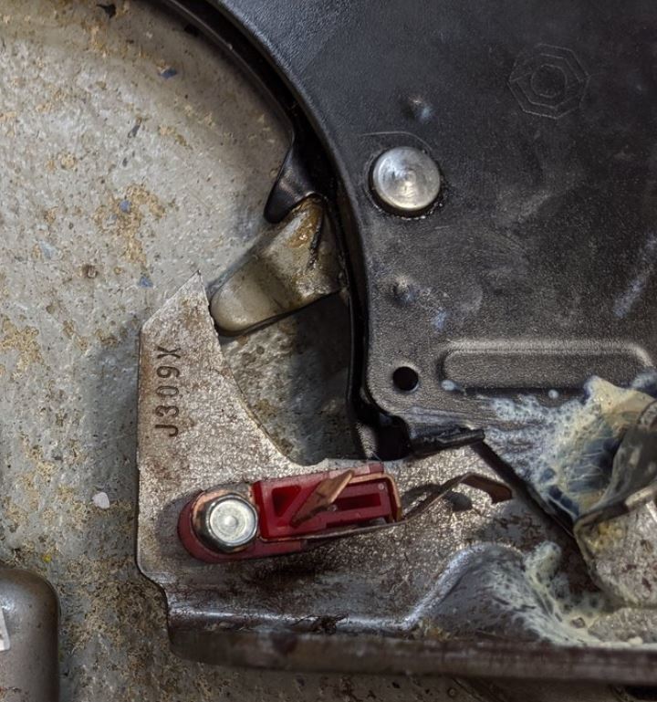

How did you get this far without ever understanding how the self adjusting brake lever works? With the console out of the way it's a very easy piece of hardware to understand. I've posted photos and explanations how it works before. There's a wheel that connects to the cable, and a spring that tensions that wheel. When the lever is all the way down, the wheel is free to tension. When you lift up on the lever, after the first inch or so of travel the wheel locks in position and starts pulling the cable.
If the spring is removed, you can just grab the cable and pull it out completely with the lever down. If you yank up on the lever too quickly, the mechanism that locks the wheel to the lever doesn't engage fast enough and the lever does nothing. If the spring is weak or disconnected, it won't pull the wheel/cable tight and the cables won't be properly tensioned.
Red arrow is to the spring.
Purple is the wheel/cable.
Yellow is the locking mechanism.
When the lever comes all the way down, the tab on the bracket visible in front of the wheel pushes the locking pawl and releases the wheel from the lever. As the lever comes up, the pawl gets past that tab and locks the wheel.
Pic is date stamped Feb 19th of this year, there's probably a thread from Feb where I posted it before. Might be worth a look. Edit, edit - Here it is - https://www.thirdgen.org/forums/brak...rear-swap.html
And a close-up of the locking pawl/tab robbed from another old thread.

If you pulled on the cable underneath the car to install the cables that go to the wheels, chances are you pulled the cable all the way out and it wont engage properly now.. this is what happened to me.
You will 100% need to remove your console (not hard at all) and take a look. it will become immediately clear what you need to do. I got the console out late last night and will try to take some videos of it in action tonight to show how it operates.

Guys I finally got the rears working 100% and the parking brake to hold. Ive been away for sometime and did not get a chance to update this thread but for anyone facing this issue this is what worked in my case....which shouldnt make sense lol. So I did get new calipers..i bought a spare set of oem junk seized calipers for parts. The lever that actuates the pad on the new caliper is not exactly the same shape as oem and the length of the 'plunger' or plastic rod it pushes is also not the same as oem. I swapped over those pieces and this did indeed yield slightly better results. The caliper would hold the car but with a good push..would roll, still not hold on a hill. So then I started playing with the cables and adjusting them once more. With them maxed out I got what i thought was a good hold and couldnt spin the wheel by hand while on the hoist..and on flat ground i would have to push fairly hard but it wouldnt roll away from me. Now i thought..lets try the adjustment screw because there is no other things to adjust. The instructions posted every where mention the freeplay and the measurement to have proper functionality. I ditched that procedure as it hasnt made any difference for me previously. I backed the adjustment screw right out on both sides, tried the hand brake and in 2 clicks was fully LOCKED to the point I thought the cables would snap. I let the car down and backed down halfway of the ramp hoist and tried it again.car wouldnt move! Great..I knew I was onto something, put it back in the air and began to slowly turn the screw in to see when I start loosing tension. the back and forth took awhile to dial in where both calipers were equal clamping force. Then i set out to readjust the cable slack so that the handle wasnt 3 clicks to be fully locked. Backed the main cable postion some and now 5 clicks is fully locked and makes it a smooth transition on the ebrake handle.
What an adventure this has been.There are so many other posts of people having hard time setting lt1 rear brakes up to have good bite. Back the screw all the way out and work your way in, then adjust the cables. Take it for a drive and reinspect the wear pattern of the pad/rotor. The car stops better without pulling to one side. now i need to work on the front and replace the ebc's with something less brake dust/fade.

I recently swapped an e brake handle mechanism out of a 2002 F-body into my 85. It’s not as straightforward as I would have thought, but it works flawlessly. The tunnel adjuster setup is straight garbage and never quite functioned right. The later setup has a true pivoting equalizer and self adjusting mechanism, which makes a huge difference towards proper function on these brake setups. A few things that this required:
All fourth gens use the same e brake handle and self adjusting mechanism. It is a nice setup that seems to work well. The mechanism is beefier than the stock third gen lever mech. I had to enlarge the mounting holes to make the lever centerline the same as the stock lever. Also had to remove some material that sticks out near the cable hole, as it was rubbing the side and bottom of center console. I had to make some cable mounting brackets for the trans tunnel to locate the cable end from the lever and two cables from the PBR rear calipers. I used the longer cables for a 96 F body with disc brakes.
The instructions for setting free play are misleading. I wasted many hours trying to set it according to the manual. The absolute best way to do it is to remove the calipers all together, remove the big lever return spring (this is ABSOLUTELY CRITICAL), and use a c clamp on the piston to simulate it making contact with the rotor with no clearance (sort of how the manual states to take up clearance by applying the brake pedal). Loosening the set screw REDUCES free play. Tightening it INCREASES free play. Set screws on mine were backed out to the point where they weren’t contacting the little clip piece. I fixed this by pulling the spring up another two coils to get it to pull it against the set screw again. You will be able to get the .020” between the lever and bracket shown in the procedure if you eliminate the clearance between the piston and rotor and have the spring removed. Use one finger to move the lever until it stops. Measure gap. Adjust set screw. Do this right and both sides will engage the brake HARD. They will also do so with the lever not having to come up very far.
Sorry for the long post, but I hope this information can help anyone having problems with this setup.
