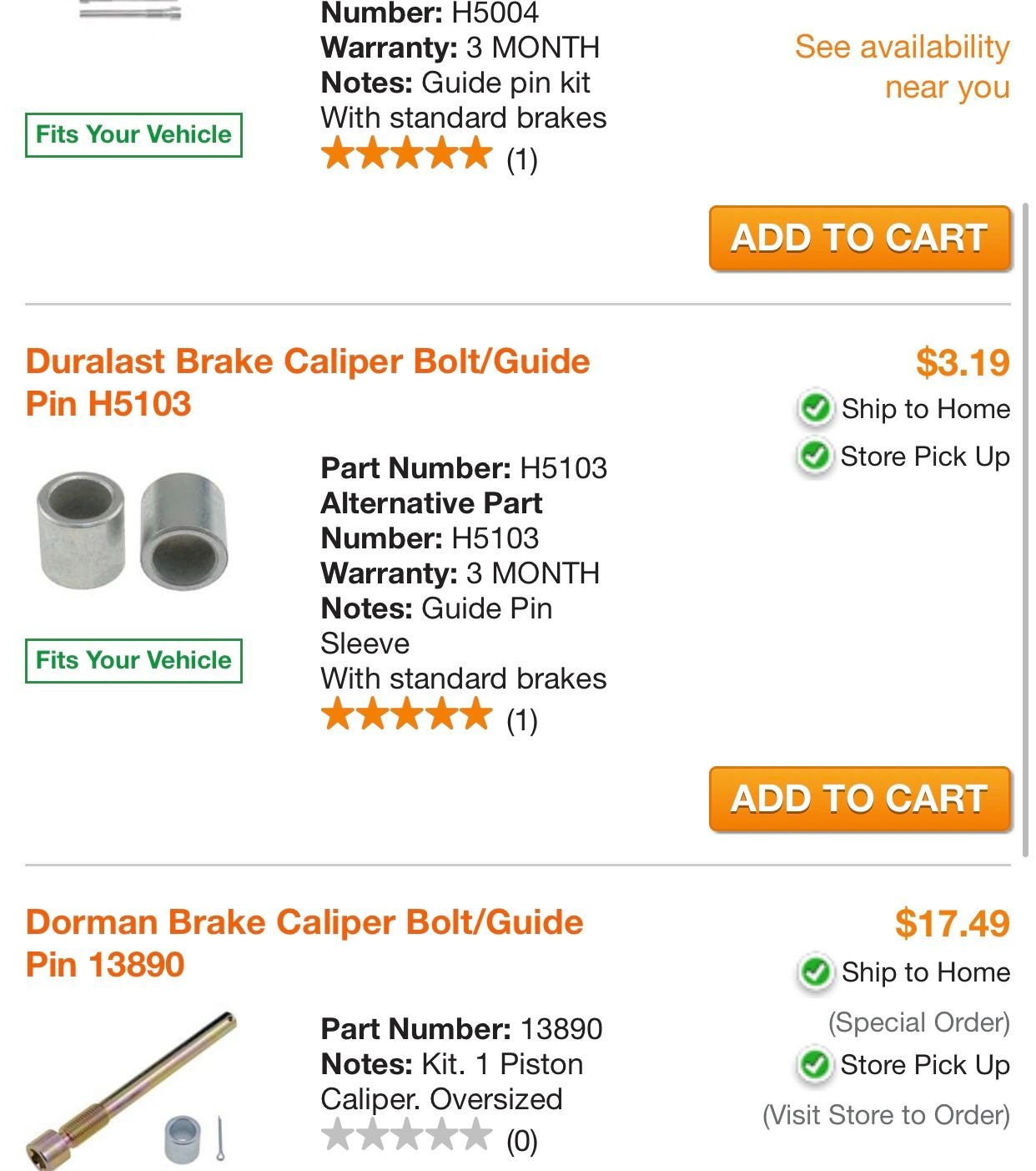

My brakes were dragging after putting the pads on yesterday,I had installed them with the metal wear indicators the wrong way and it appears the squealers hit on the inside of the housing not allowing the pad to fully pull away. I am going to swap them around this morning. I bought the silicone grease mentioned in another thread for the guide pins. What specific areas need to be greased? I know the tips of the bolt ends where it goes through the rubber o rings get lubed. What about the bolt guides shown in the photo below? Are these guides supposed to be lubed inside and outside and are they pushed flush into the o ring where the threads go through?
any photos or advice would help. I’ve never seen those guides pushed out on my other cars before

Thanks. What about the guide sleeve itself? The part number H5103? Does it get pushed in flush into the rubber o ring the bolt slides through? And does this spacer get lubed inside or outside

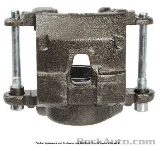

Maybe this photo will help
https://www.rockauto.com/en/moreinfo...51650&jsn=3165

It doesn't look like anything actually slides on the guide pins. do they just help attach calipers to spindle? If so, I would think just grease pivot areas, but not entire bolt.

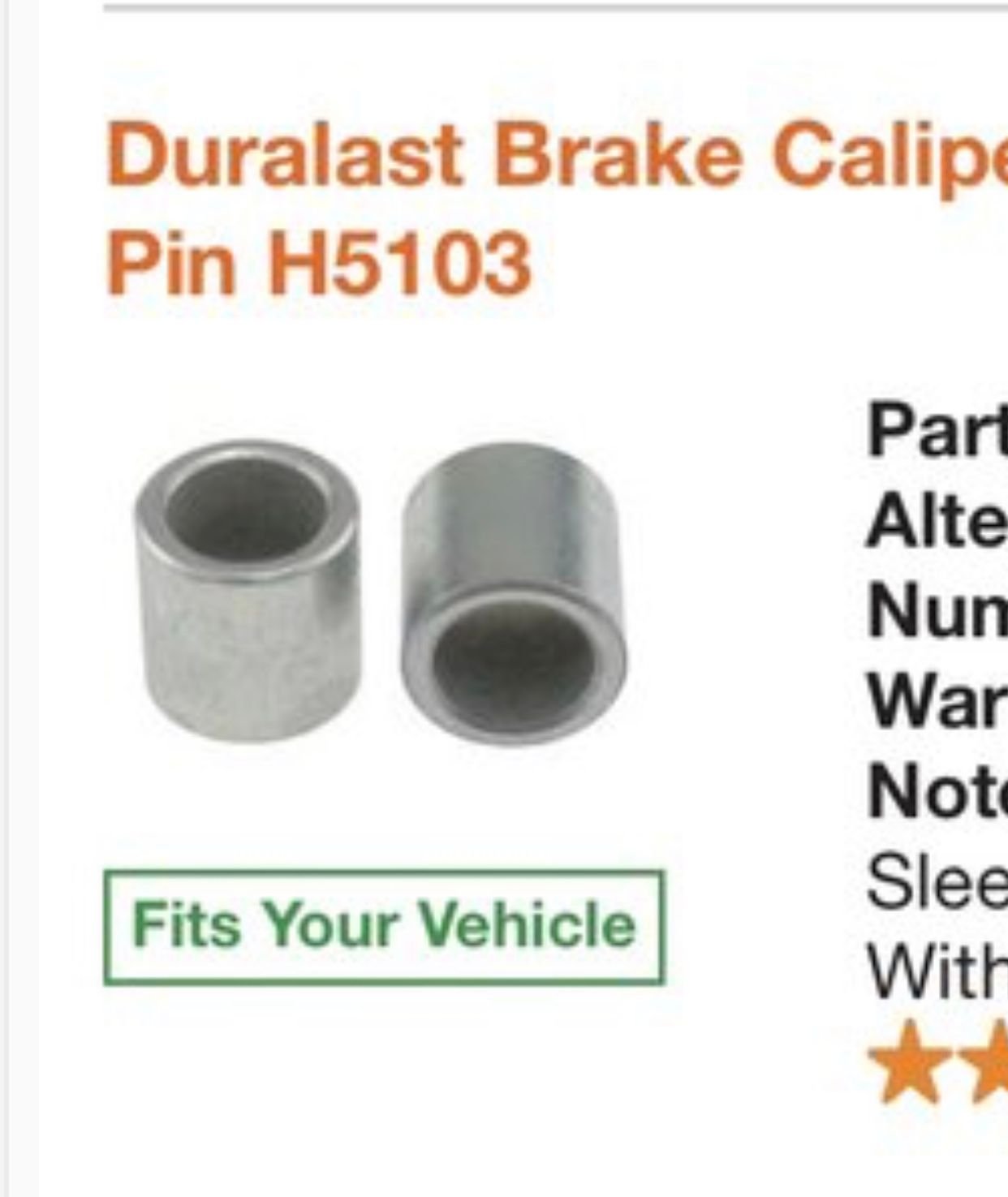

These are the guide sleeves

The pins and guide sleeves were fine.
