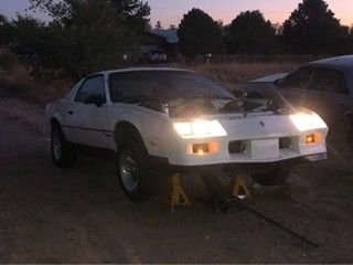

Hey I just bought a 86 sport coupe roller, I put a Vortec 350,z28 rear end with disc, and the body kit off a z28 real nice car.
but I went to bleed my brakes after installing and bleeding the master cylinder and the booster is making a swooshy air noise when you press the brake. The brake pedal only goes halfway down and then has a click noise when pressed down as far as it goes. When the car is off and on, The rear brakes seem to be engaged a bit all the time and the front driver brakes the only one that works correctly and the passenger front brake isn’t getting fluids all. I’ve bled em about 3 times for hours. Can anyone help me before I go by a new brake booster??
