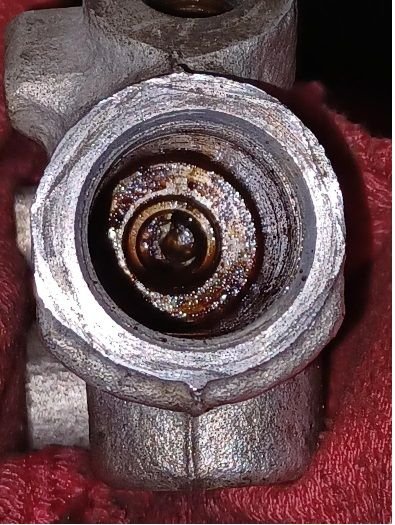

Hi all.. 85 T/A. replaced all hard lines to rear. Brake light came on. Re-centered prop valve (very tough to move that thing.. therefore think its gunked up.. previous owner let brake fluid get very dirty) brake light out... more bleeding.. brake light back on.. trying to shop for replacement combination valve but can't find correct one. Only find standard thread .. my brake lines are metric. Tried Rockauto, summit, jegs, etc.. can anyone help with finding this part? Thank you thank you

yep. my prop valve was gunked up all right... so the shuttle thing inside was getting stuck and restricting flow to one end of the car.. did not want to re-center due to not being able to move freely.. really wish i could find a new prop valve that would take the metric bubble flare lines that my car has.. i've got a brand new PV-2 i guess i'll try to install.. still deciding if i should try to source adapters to go from the metric bubble-flare lines to the standard inverted-flare ports on the PV-2 prop valve.... or just cut the ends of the lines and re-flare them with the standard inverted-flare ends... anyone have any thoughts on this? thanks.

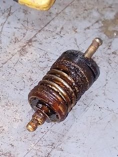

Hawks is still looking for a replacement for me.. cleaning my prop valve is not proving too successful. Have it soaking in carb cleaner for several days now. Still can't unstuck the shuttle thing in the bore.

I think every GM prop valve was tuned to the vehicle to create the brake bias they were looking for. Even Camaros of the same year came with different prop valves depending on suspension, tire, brakes package. The external housing is probably GM corporate, but the internal parts (valve rod diameter and spring rate) varied by application.
Each prop valve (combination valve) has a two letter code stamped on the body. That tells you what internals are inside and relates back to how it's tuned. You need to find a valve with the code you want so it behaves like it should.
Some of the valves are similar and you can swap out with a different spring to get the outcome you want, but you have to know what you're doing. I created the following thread to help people learn how to do that, https://www.thirdgen.org/forums/brak...ng-torque.html
