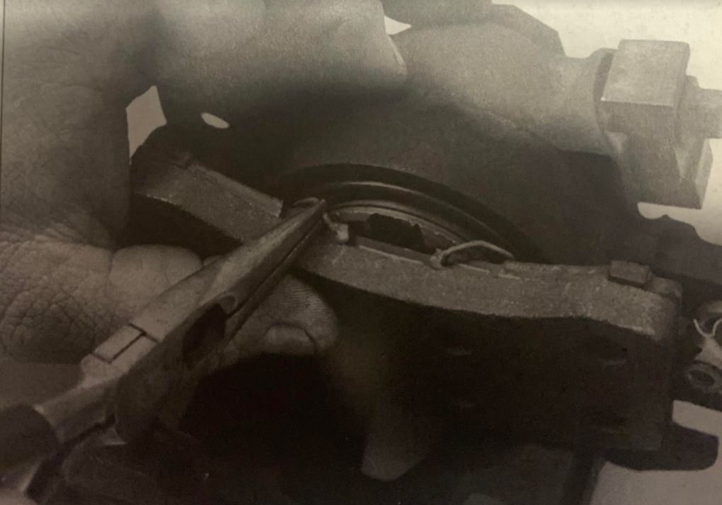

I assume these are rear discs? I have the Delco Moraine calipers and had the same problem. The caliper piston screws in. Now as I say that, I have heard some say it screws in easily. Mine did not and I was afraid of damaging my new calipers but finely decided to go for broke and got the channel locks out and made it happen. Then and only then did I gain clearance to get the calipers over the rotors. I thought my pads were too thick and ended buying two different versions before adjusting the caliper piston in.
The clip shown in the picture goes in the caliper piston groove the hook go over the metal backplate of the pads to hold it against the caliper piston.

You have to screw the piston in and make sure the 'button' on the back of the pad falls into a groove/low spot in the piston. It has to be pretty far down, sometimes farther than you think is 'fully in' but the pad needs to have that button fall into a notch in the piston. Vitally important.
