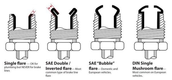

Hey Everyone,
Finally getting back to working on my 86 TA. I am replacing brake lines and I see a lot of info about what size tube nuts to use, but what I don't see is what style flare to use. I'm looking for the flare style that runs from the prop valve towards the rear end (the 6mm line with the M14x1.5 thread, I cut mine out and cant find the flare for a reference). I know its the bubble flare or DIN flare, but I'm not sure which. I also wasn't sure if it was dependent on the tube nut you are using because the bubble is chamfered where it meets the flare and the DIN is square.

It's the one called "SAE Bubble"
