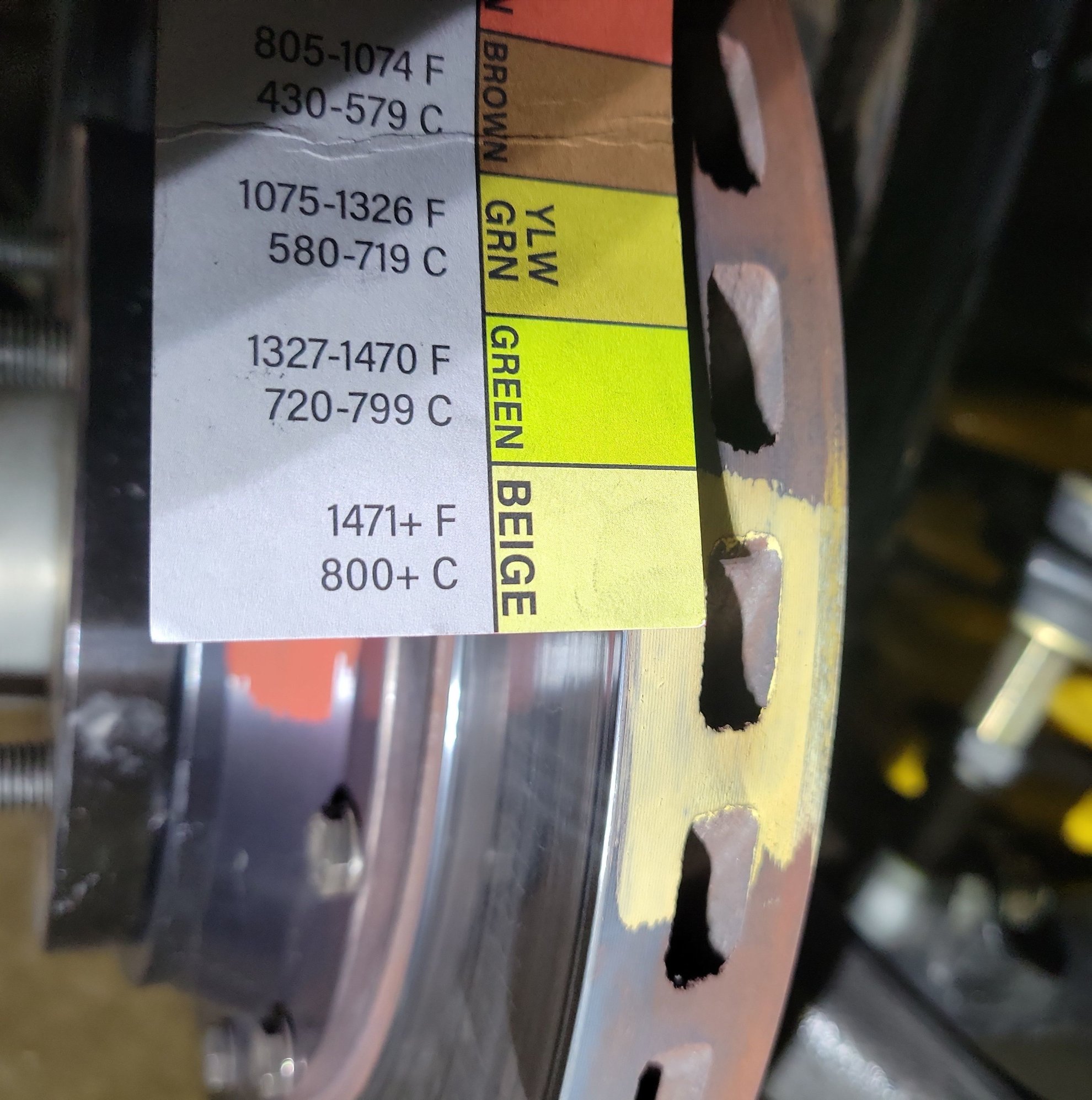

I used the DCT30 for a wet cold track day.
Didn't get any brake fade, but it was 60F and wet.
Rotor temps were 857F
I dared NOT to go over 125mph on the straights and 110mph between turns.
If it was a dry day, NO way would they survive.

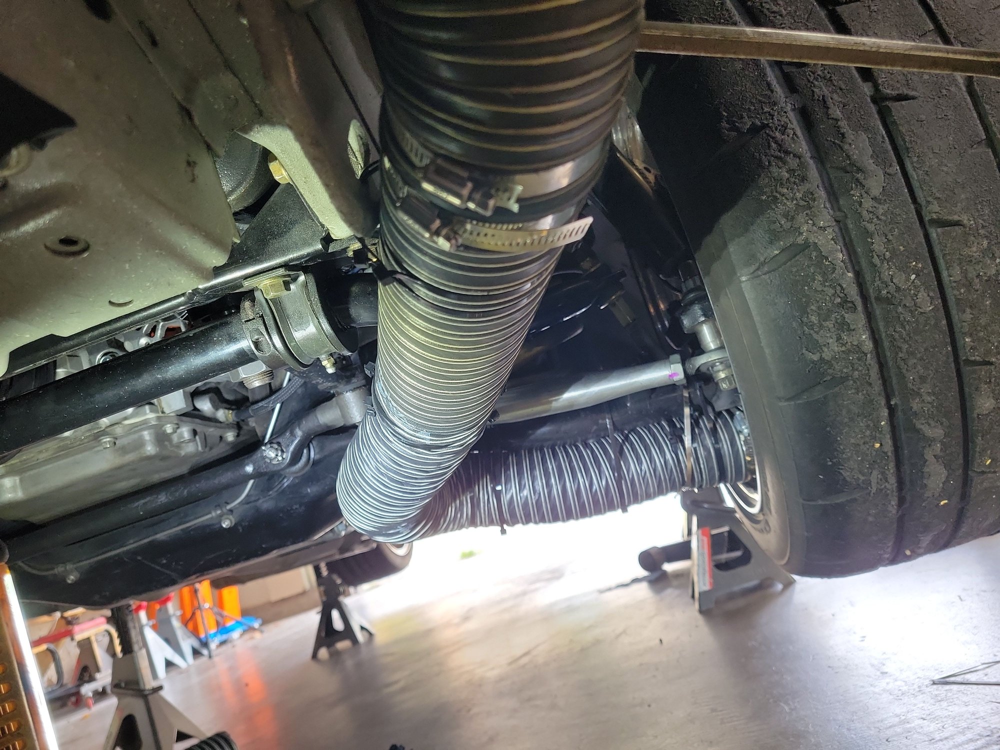

Seems like no matter how hard you push them they keep a consistent amount of bite.
I know a guys running the 8-hour lucky dog endurance race using these pads.
Repeated 130mph stops and zero fade combined with my brake ducts.

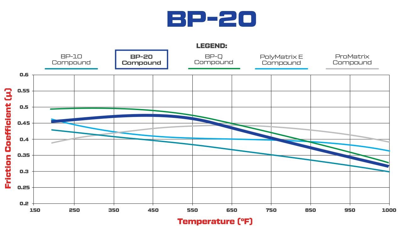

Have you tried Wilwood BP20 brake pads on the street?? They're supposed to have a better bite. I'm currently using BP10

I haven't used the new BP 20 pads.
I think that pad would be probably decent for street use and mild autocross use.
I definitely would not bring that to the track.
The friction drop off with temperature is high.
The old BP 20 didn't have that drop off, But I think that was the non-California legal copper version.
Those aren't made anymore.

Apparently people are still reading this thread.I tested 3 more Track only pads this year Raybestos ST47, ST45 and a Carbotech XP24. ST45:Track only pads Friction: 0.67Mu --- to 0.55Mu when hotTemp range: 400F-1300FRotor Wear rate: medium Stupid high bite at medium temps that mellows out as temp increasesDust is pretty low for a track pad assuming you keep them above 500F+They squeak a tiny bit when warm but no noise when cold surprisingly enough. Good rotor Wear and lifespan I believe these were common NASCAR pads for a while.I run these on the rear of my 92.Not ideal for rear track pads because the first few stops will have the rears locking and my ABS going off. Once they get hot, they lose a bit of friction, and become balanced front to rear.Unfortunately Raybestos moved production to Mexico, then we're forced to bring it back when the plant couldn't manufacture pads correctly.The supply is super low and pads sell out immediately. Raybestos ST47:My new favorite Track padFriction coefficient: 0.64MuTemp range: 400f-1300FDust: medium Rotor wear: medium Noise: squeaky when hot and driving at low speedsI run these in the front of my 92 And I like these Pads a lot.150mph stops aren't much of an issue with these pads.Bite stays good well beyond 1300fPretty easy on rotors for a top level track padDust is minimal assuming you can keep them hotEven when I exceeded my brakes's abilities during track day on Hoosier A7s, the ST47 never fully gave up. They got too hot, but never became dangerous. Unfortunately my brakes are a bit small for repeated 150mph stops in 1hr tack sessions. Carbotech XP24Friction coefficient: 0.65MuTemp range 400F-2,000F Dust: medium dust at high tempsRotor wear: medium when hotNoise: pretty quiet surprisingly enough These pads preform very very closely to the ST47sIf you blindfolded me and installed one set on my car; I probably wouldn't be able to tell them apart.However, the XP24s seem to fade easier on the upper limit.They claim 2,000F vs the ST47s 1,300FBut the XP24 has way less bite at hotter temps.But, unlike the Raybestos pads, the Carbotech pads are available everywhere. I'll be testing Carbotech AX6 autocross pad and maybe Hawk DCT80s next season.And maybe getting enough coin for a AP racing brake kit.
3in brake ducts routed like the American Sedan guys run em
Hoosier slicks are hard on brakes
