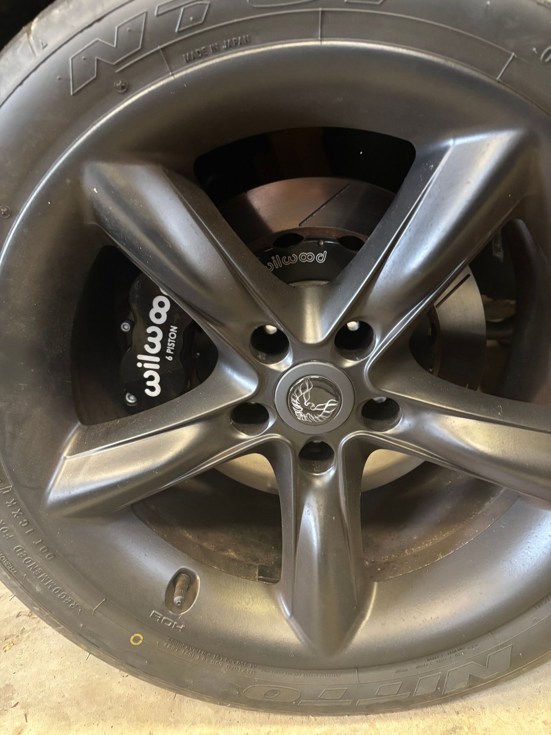

I went with Wilwood front and rear.. 6 in front 4 rear..I am running Detroit speed front suspension and Detroit speed ford 9" rear. but the part numbers for the Wilwood that used are.
Front..140-15278d
Rear..140-9219d
Parking..3309371

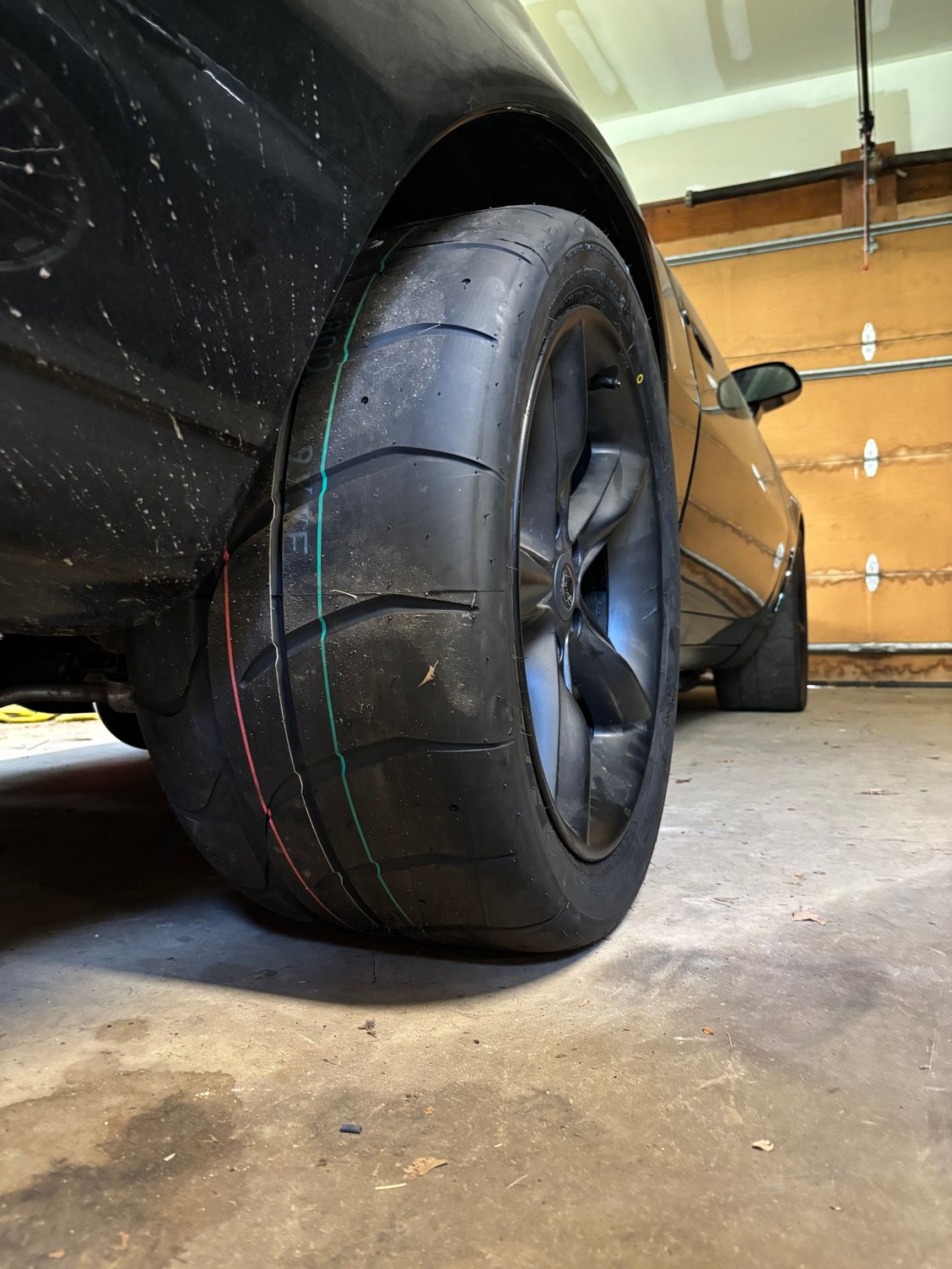

I went w wilwood 6 piston/13.5 in up front and 4 pistons in the rear. I have 305 35 18 (rear) and 275 35 18 (front) NT01s. The tires are super sticky. The brakes stop unbelievably well. The car is balanced, safe and a blast to drive. A fast car that can't stop is stupid, there's really no point in dying fast. I used a Kore3 kit on the front kit w modified spindles and a standard rear wilwood setup on my 9 in. The car hits 100 really fast and comes back down from 100 really fast. The brakes perform really well. The only issue is if there's a car behind me. Short stops in traffic I'm usually looking in my rear view worried amount getting rear ended.
I strongly feel like your brakes need to be at least as good as your drivetrain. The stock brakes on these cars are terrible.

my setup fit under 17s really well.
