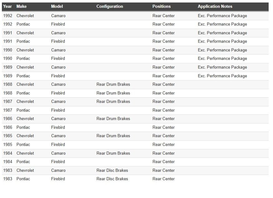

What is the performance package they are referencing?
That would be the PBR front brakes, aka 1LE. The rears are exactly the same in those cars, no matter which front ones the car had, i.e. whether the fronts were the PBR calipers or the crappy Delco-Moraine ones.
AFAIK the ONLY difference in that hose in our cars, is that 82-83 was all SAE sizes, and 85-92 is all metric sizes. 84 could be either, it changed over gradually during the year it seems, you just gotta look. Just as an FYI, I put a 91 (I think) PBR disc rear into my 83 originally drum car by successfully flaring a short piece of 6mm steel line matching the chassis end of a 89-92 hose with metric bubble flares, to ¼" SAE flare, and using a ¼" flare union to mate that to my car. Everything then bolted right up, including the 91 parking brake cables to the car's "equalizer". Has worked fine for over 25 yrs now.
No idea why the rear hose would be "listed" as different in that application. Again, if you need one, just buy the damn thing, and see if it works. Return it if not.
